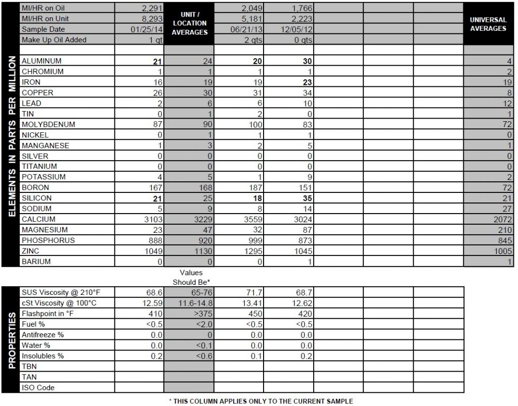

Latest oil analysis. Wear metals are dropping still.

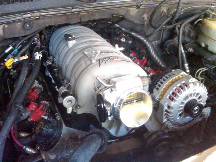

Rezin,
Which alternator are you running here? The pulley looks to be overdrive.
