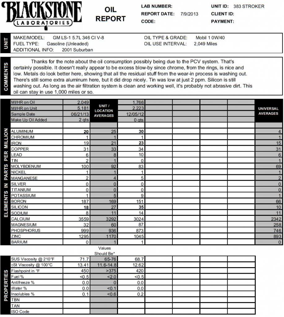

2 oil analyses done on the engine now. Everything is looking good!

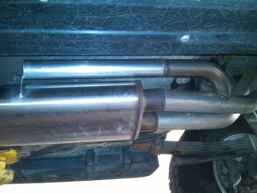

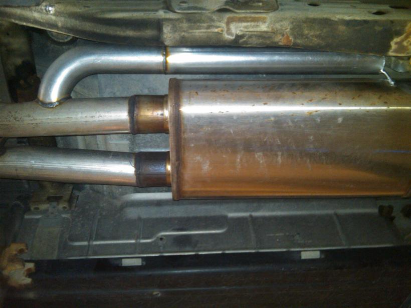

Ever since I removed the factory muffler and replaced it with a Magnaflow 12599, the truck had a terrible drone. It would start mildly at 1600 RPM, and by 1800 - 2000 RPM it was very bad. This was right at 55-60 cruising speed.
Then I started reading about the Helmholtz resonators to eliminate the drone. Here is a reference link:
https://www.performancetrucks.net/fo...-drone-489463/
Here is the explanation of the theory behind the resonator.
Helmholtz resonance - Wikipedia, the free encyclopedia
"The theory of Helmholtz resonators is used in motorcycle and car exhausts to alter the sound of the exhaust note and for differences in power delivery by adding chambers to the exhaust. Exhaust resonators also used to reduce potentially loud and obnoxious engine noise where the dimensions are calculated so that the waves reflected by the resonator help cancel out certain frequencies of sound in the exhaust."
Then I saw one of kbracing96's threads about the success that he had with his trucks and the Helmholtz resonators. He lives close to me, and he agreed to do the work for a fair price.
Basically, these resonators rock. They have successfully reduced the 1800-2000 RPM drone by 80-90%. The mild 1600 RPM drone is still there, but it is insignificant compared to what the 1800-2000 RPM drone was before.
I highly recommend this modification, and Kyle's services (kbracing96) if you live around Houston.
Here are the pics.
Passenger side:
Driver side:
