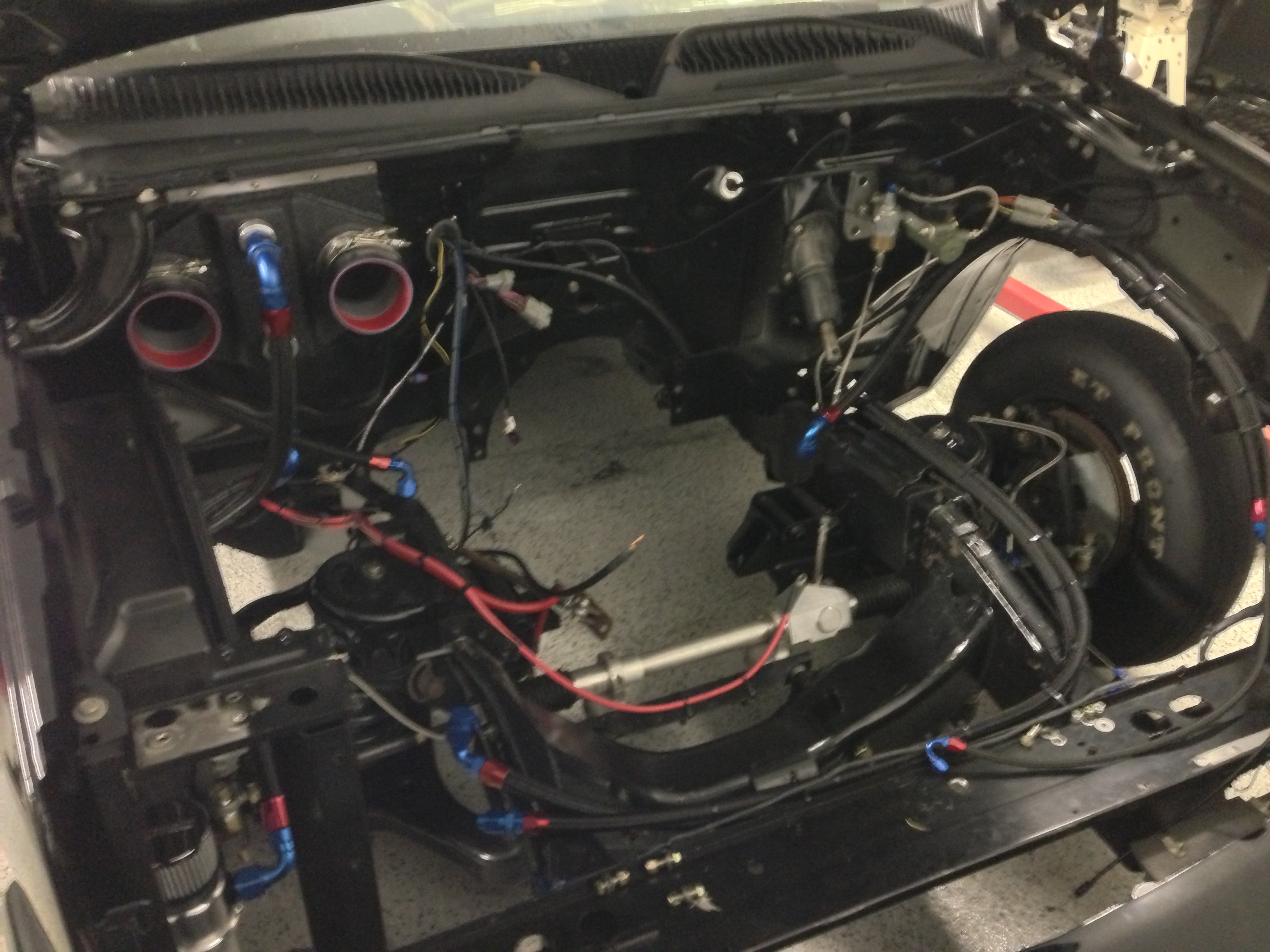

motor is ready to come out. I'll pull it tomorrow and call LME to see if we can get it on their dyno this week.
Hopefully the problem will replicate itself to the point we can figure out whats causing the issue.

So you might not need to tear the engine down?

I hope we don't need to tear it down. We'll see though...
