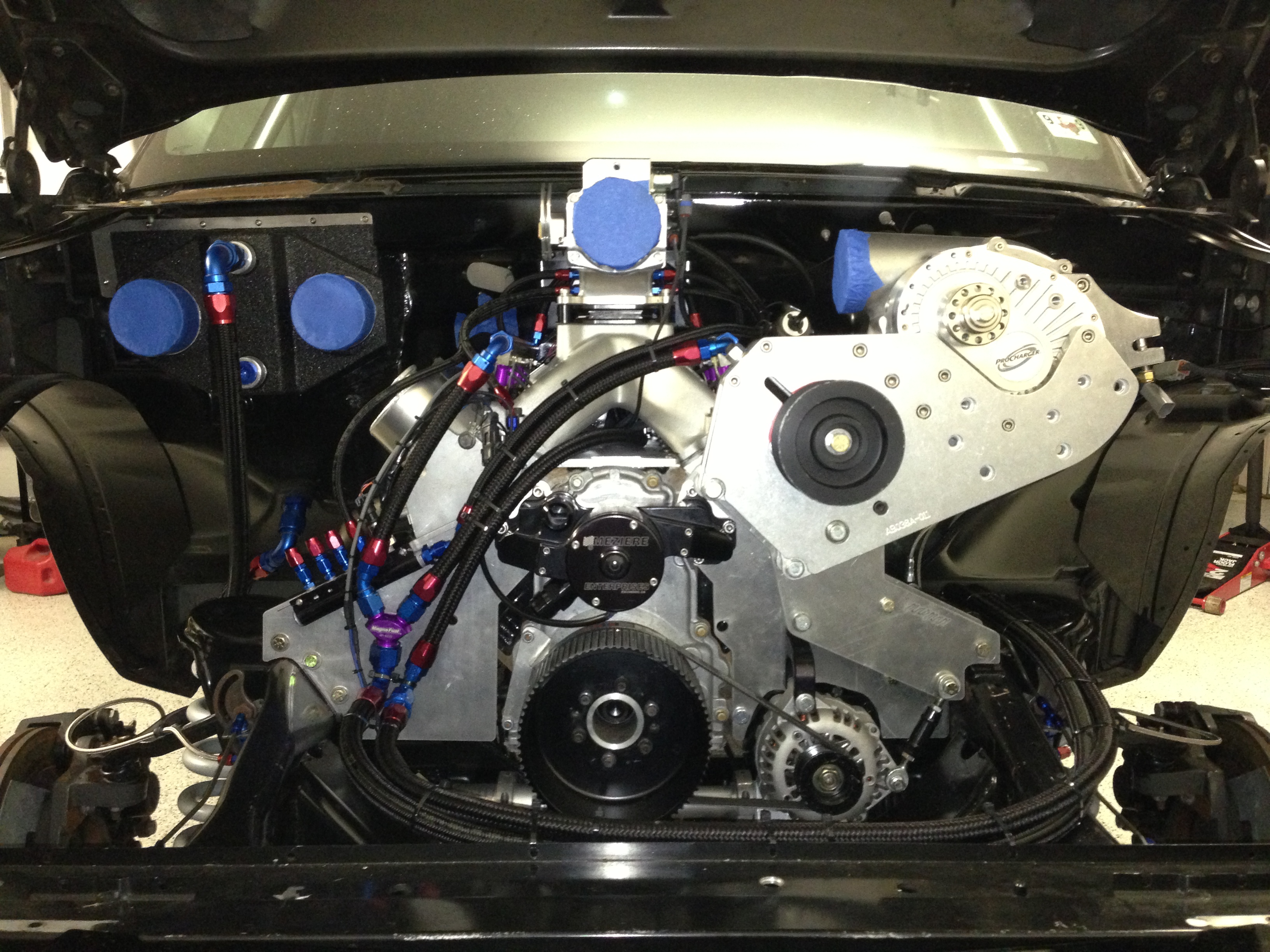

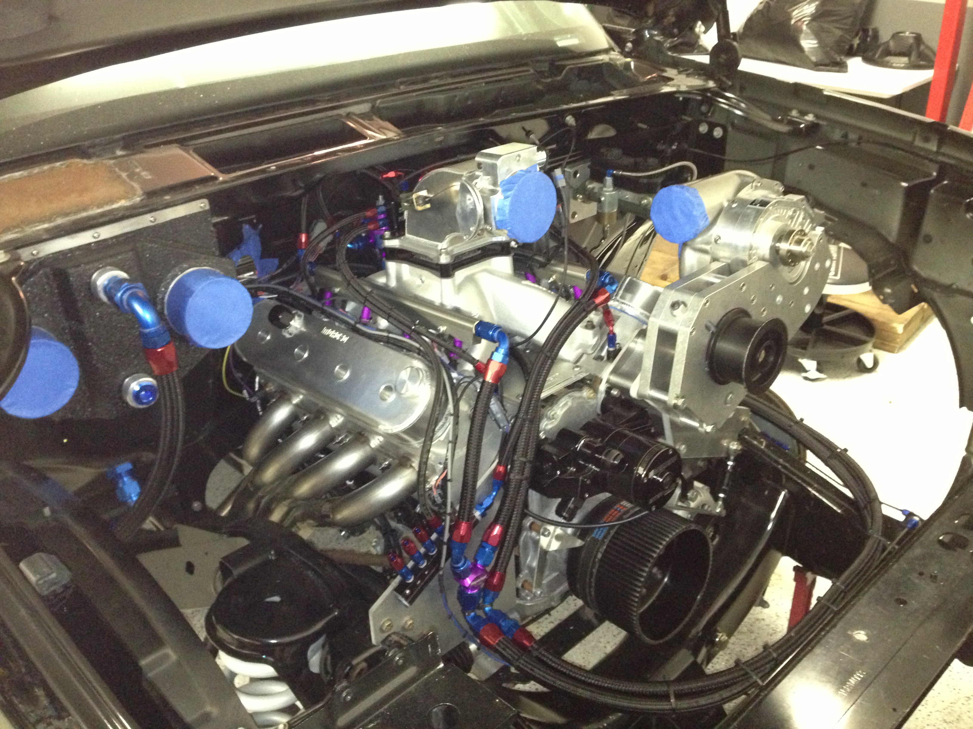

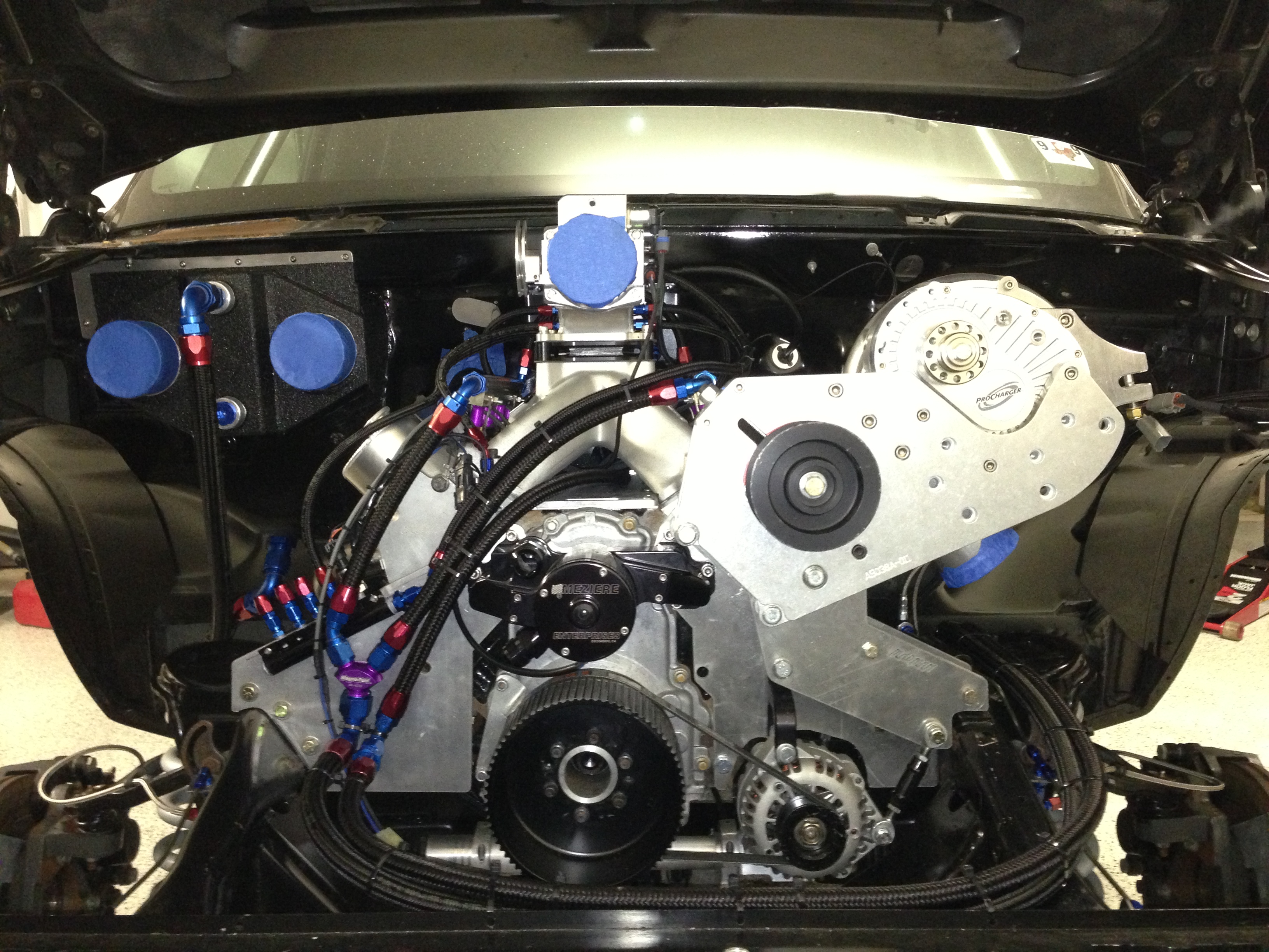

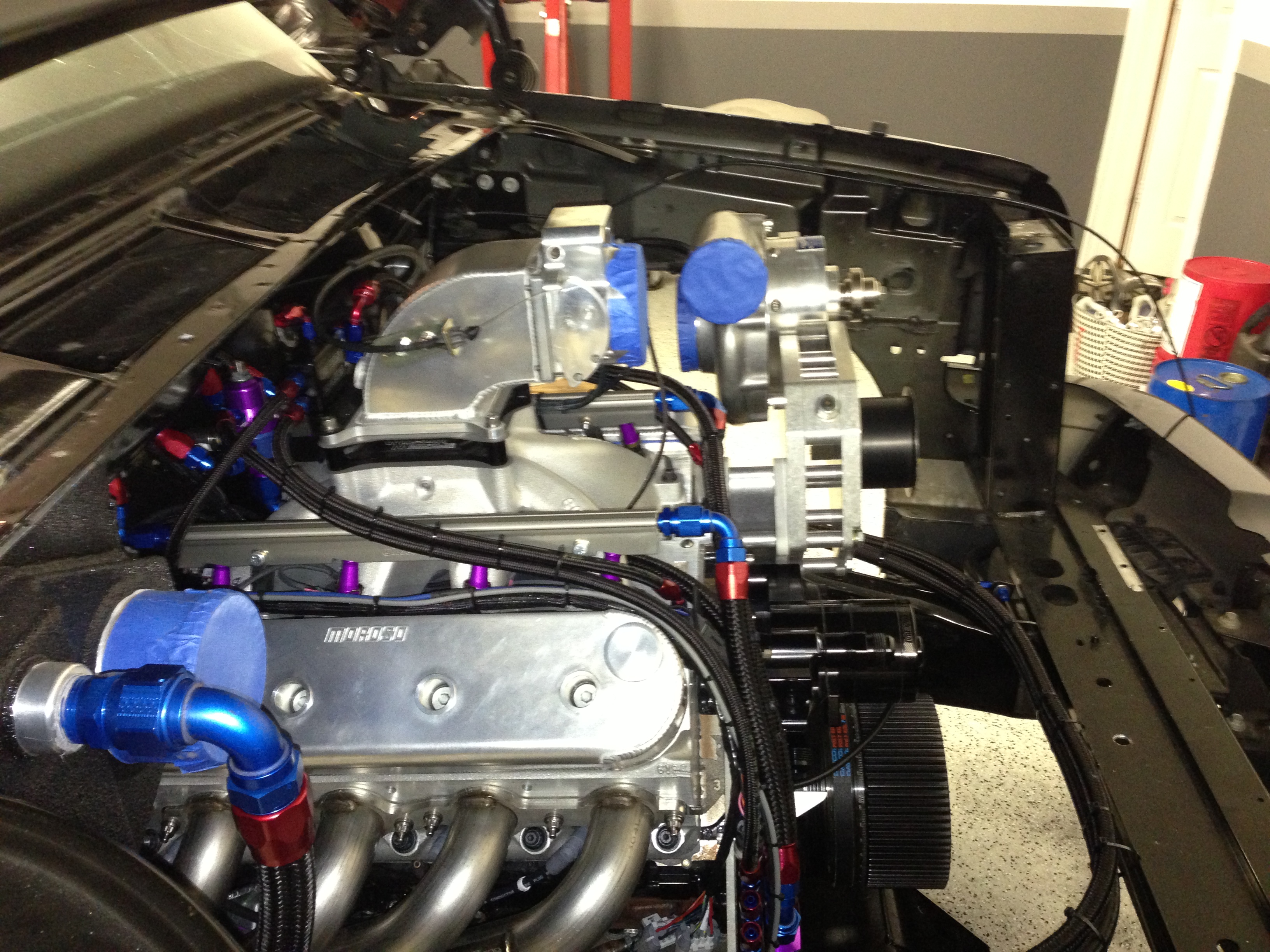

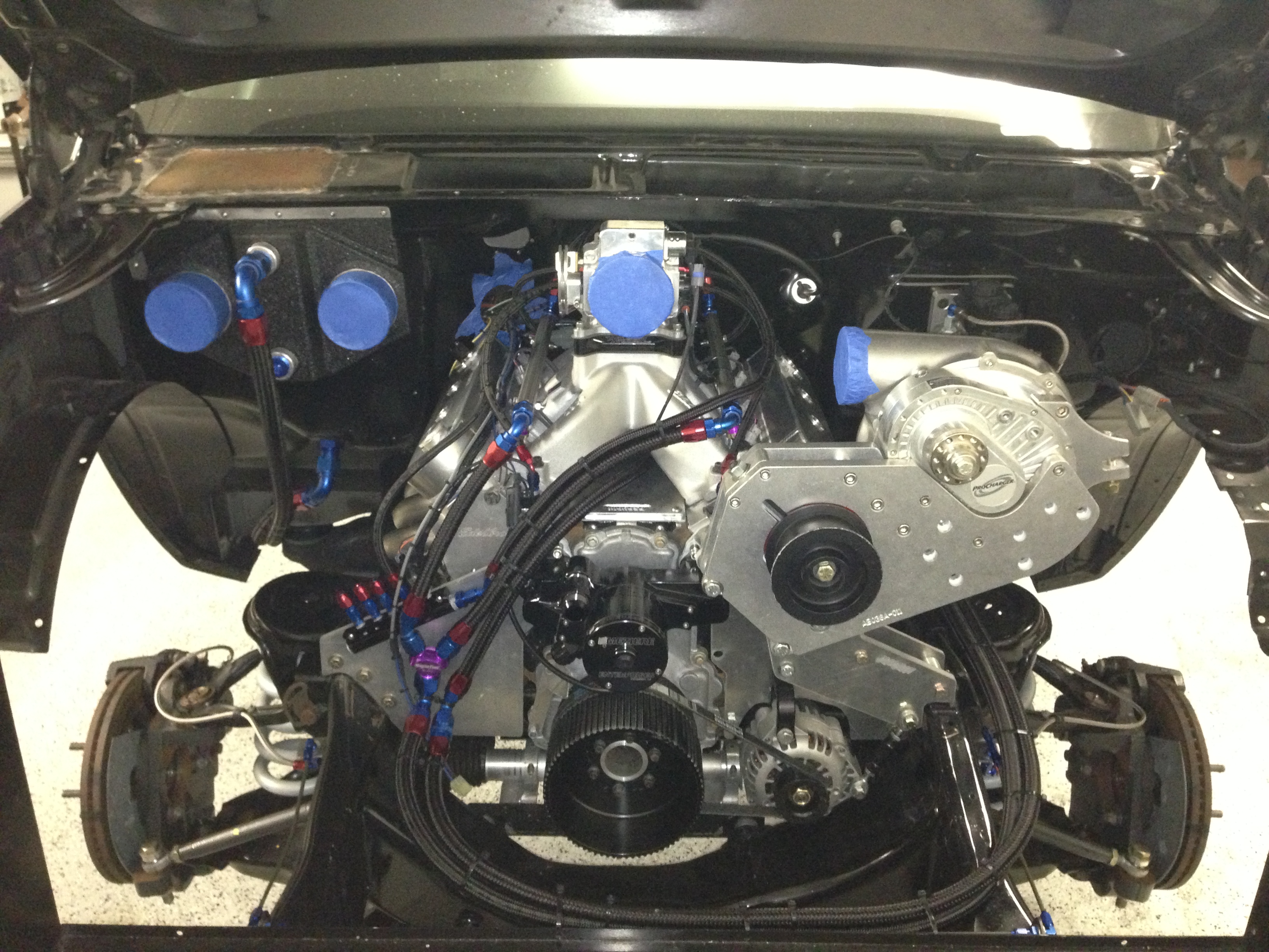

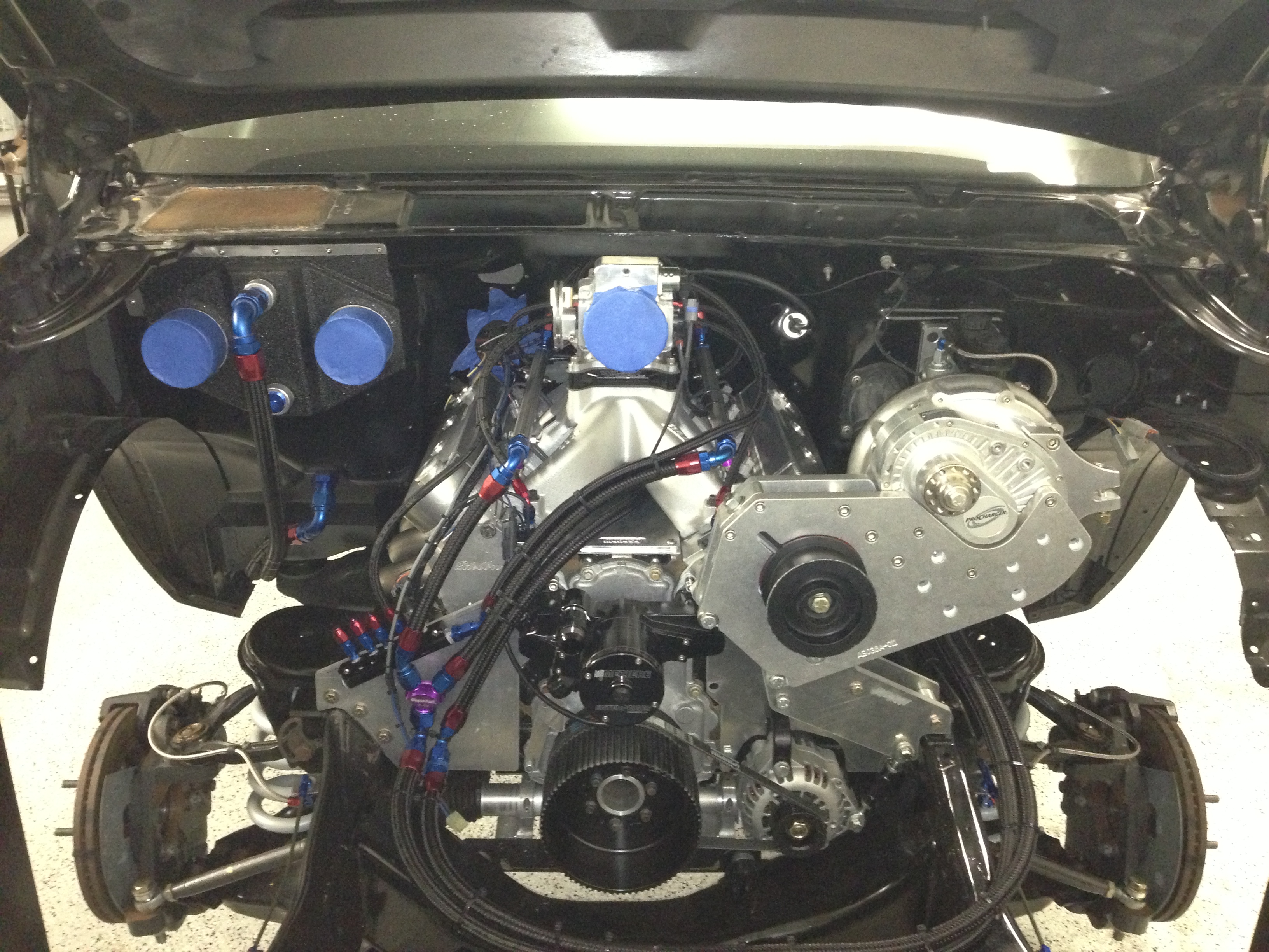

I'm at a crossroad at the moment. Can't decide what will be easier to do for the intake piping. See pics with different volute discharge directions....

Will turning the throttle body elbow to face the intercooler help any? Then it's just two short runs across the top of the engine.
I believe the 4150 mounting holes aren't square. So it would either have to face forwards or backwards. Can't be turned 90 degrees

First position and drop down the pipe coming off the supercharger just enough to clear the t-body pipe. Having it clocked down would be more work, more pipe, more bends...
