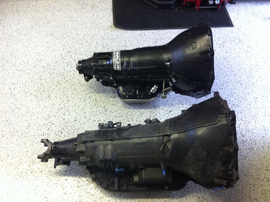

Here is the new T400 from Rossler next to my 4l80e which is still for sale

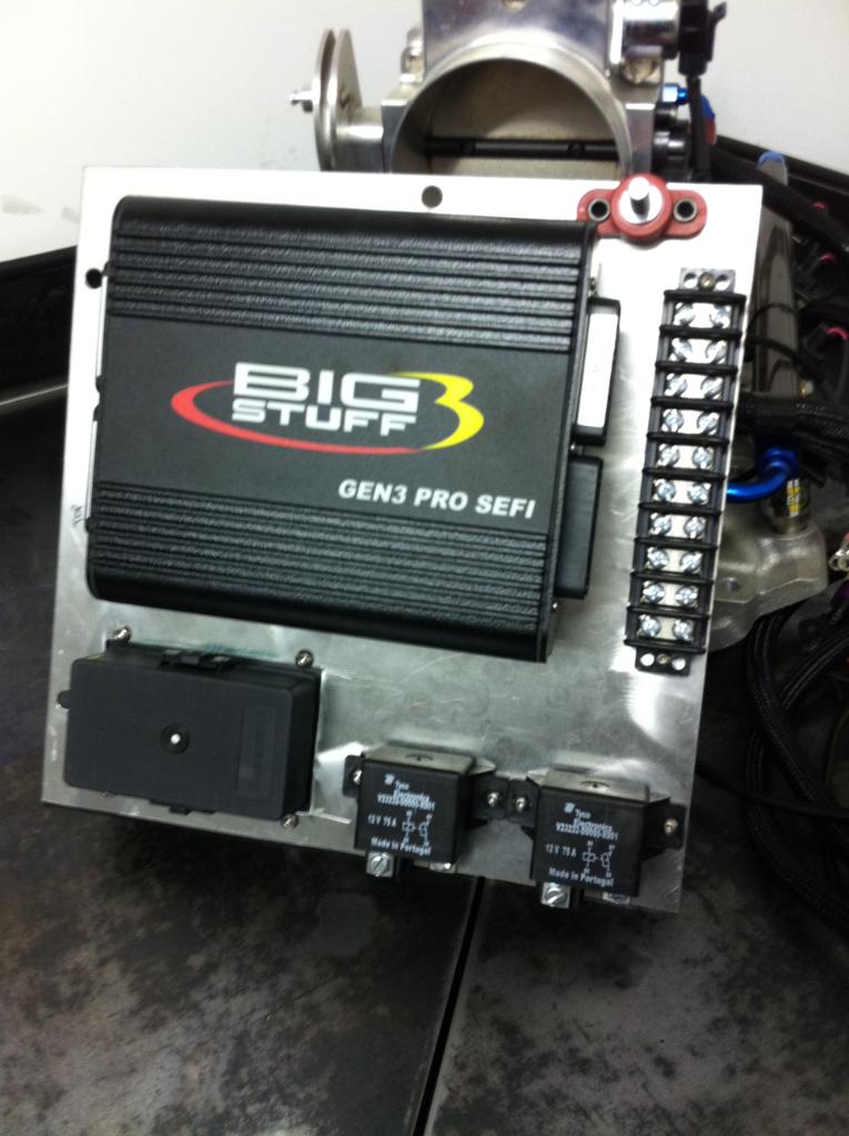

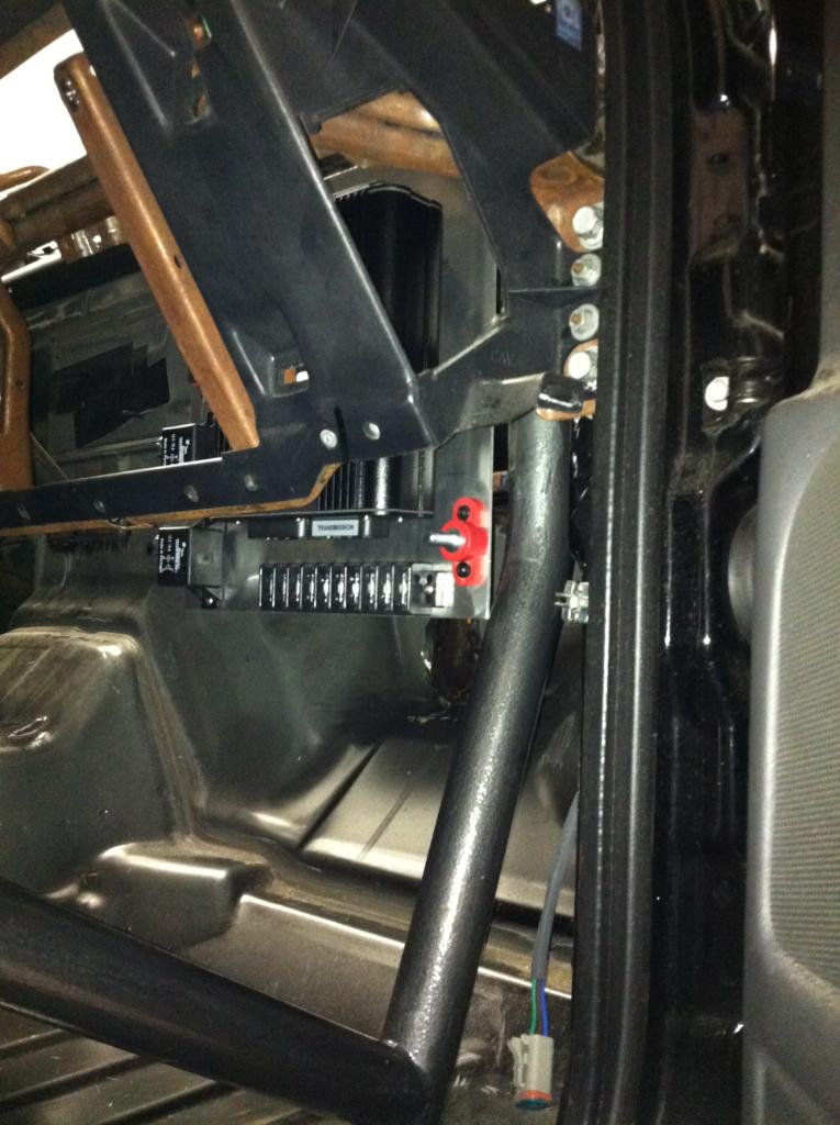

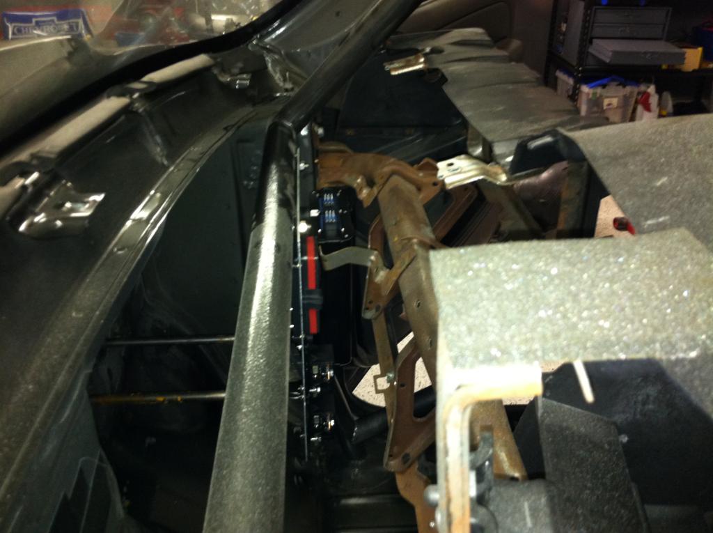

Here is the panel I made for power distribution in the truck

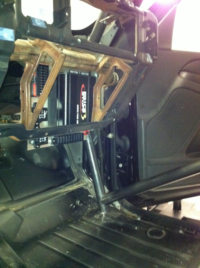

And here is where it is mounted

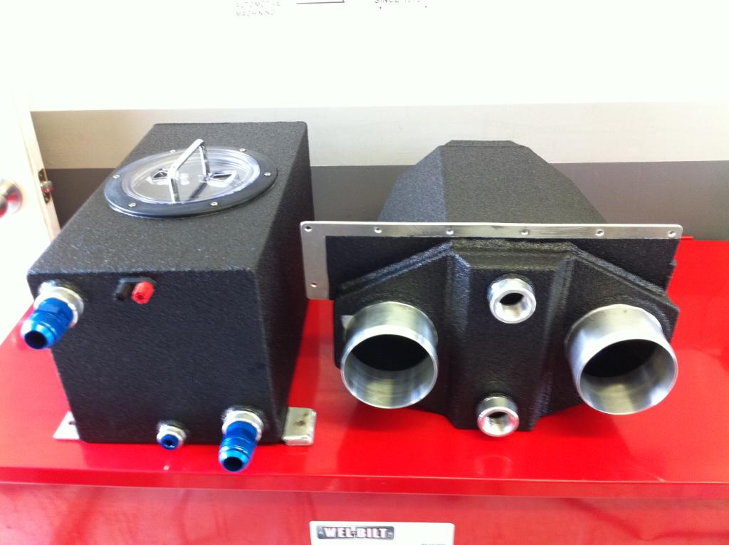

Got the intercooler and tank coated (Rhino Bedliner) to keep the sweat down

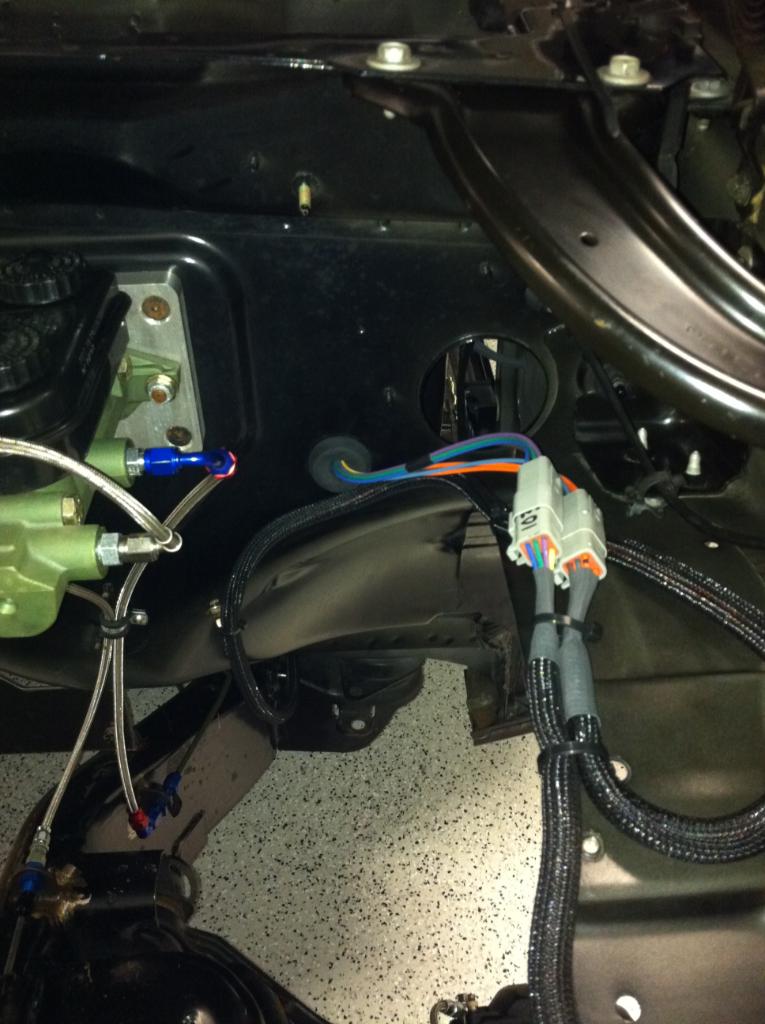

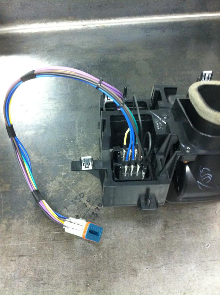

Got most of the wiring/switches done for the lights

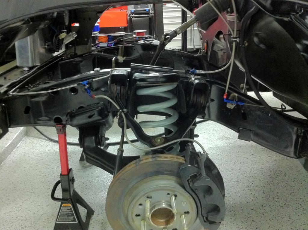

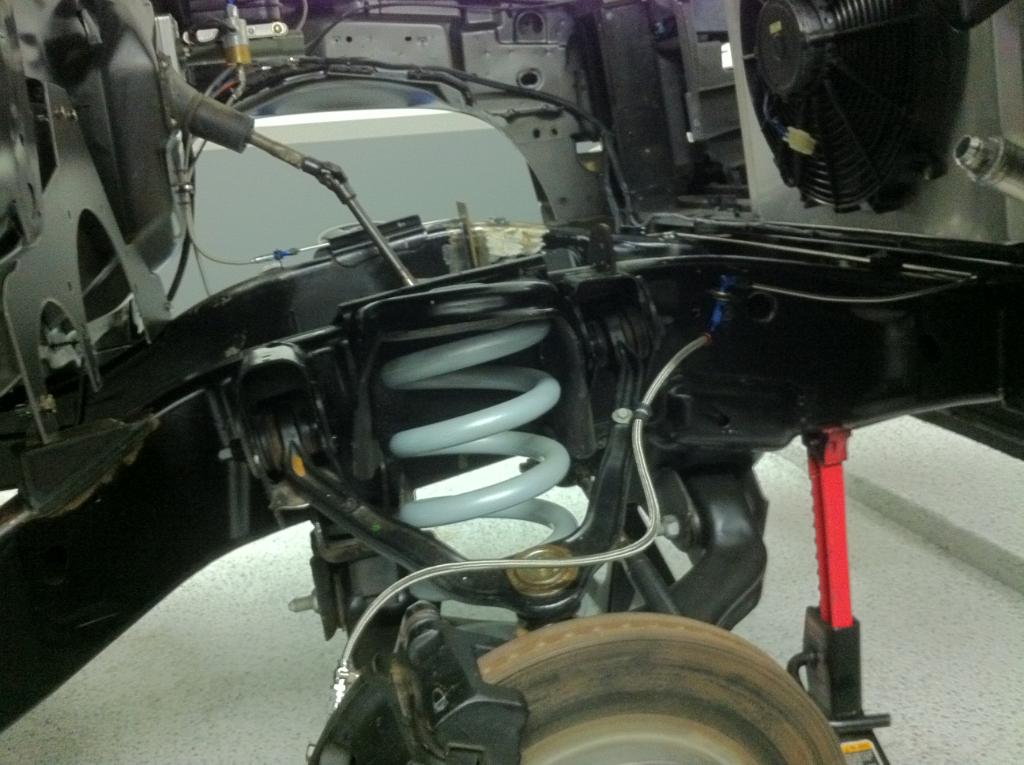

Took the front suspension apart, cleaned everything up and removed the "chevy lean" spacer as I think the 4-link straightened everything back out.

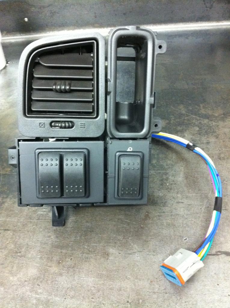

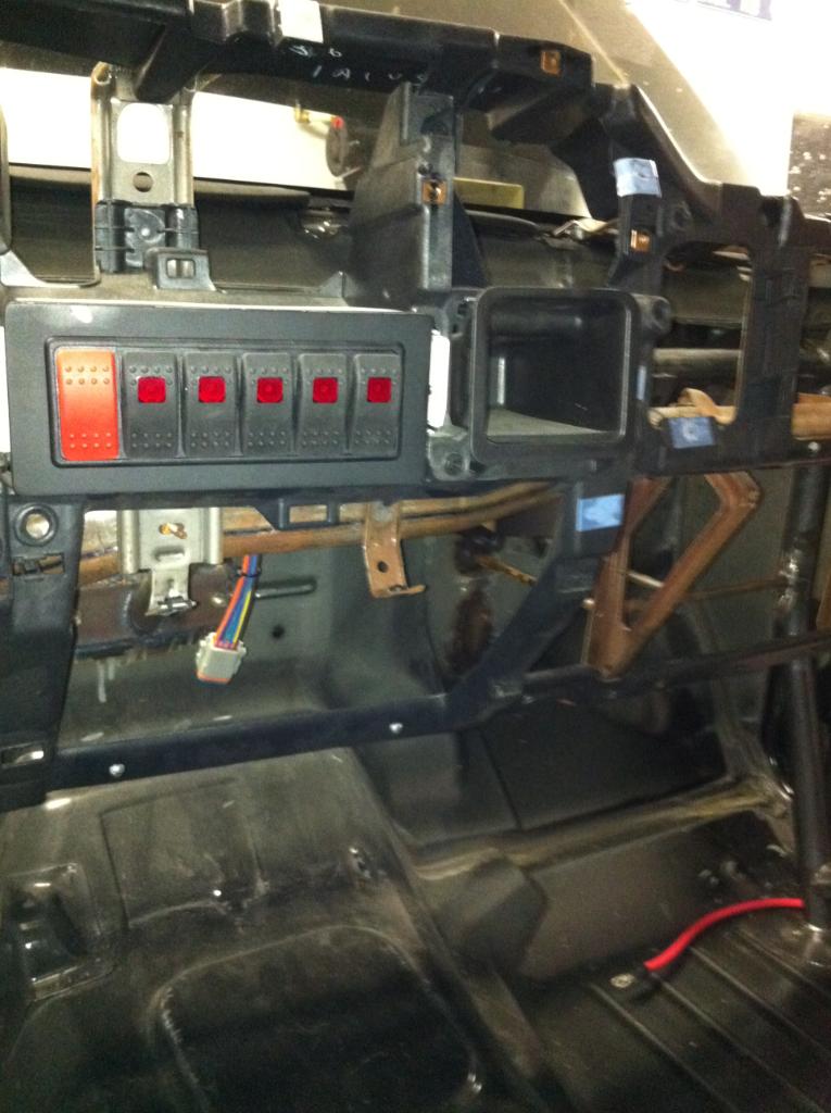

Trial fit for the new switch panel that will control fuel pump, intercooler pump, start button, accy power, ign power, water pump.

Originally Posted by 1989k1500
Where have you been getting the deutsch connectors from? Waytek?
Yea, I get about 90% of all my wiring supplies from waytek. The deutsch connectors are nice however they have three downfalls.
1. The proper crimping tool was very expensive
2. They are only rated to 20 amps per terminal
3. Once you get the retaining clip in the female end, good luck getting it out without ruining something. Make sure all your stuff is right before inserting clip.
