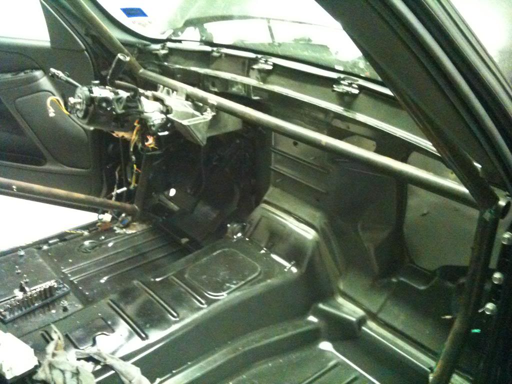

I wouldnt waste time on a 4 point cage. The key to making it strong is to triangulate everything. Its like building a bridge.

Did a little more work tonight. It actually looks like I can make the original pillar pod still work so thats what I'm gonna do. Got the dash out, and got started on the wiring. I can tell you this, the wiring project is gonna be a pain in the ***. Basically starting with a plug I know is no longer needed, tracing the wires and pulling them out, one plug at a time. Once I get the entire harness untaped it should go pretty quick. I'll get some pics up tomorrow as I should have made some worthy progress by then.

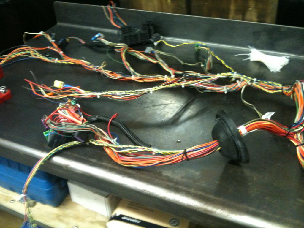

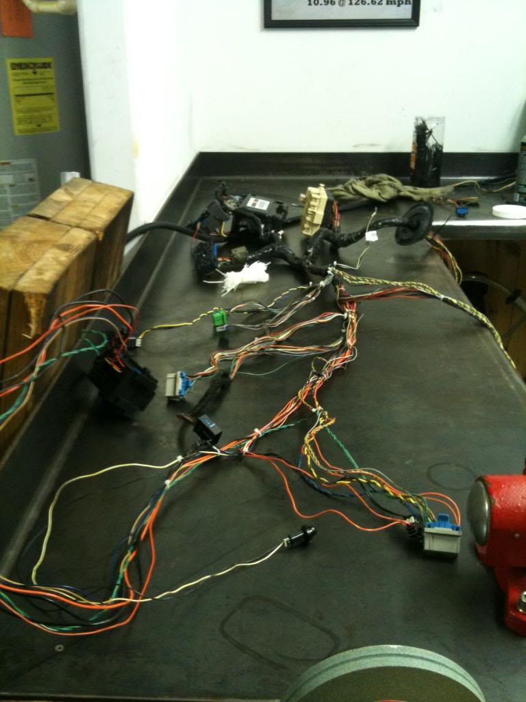

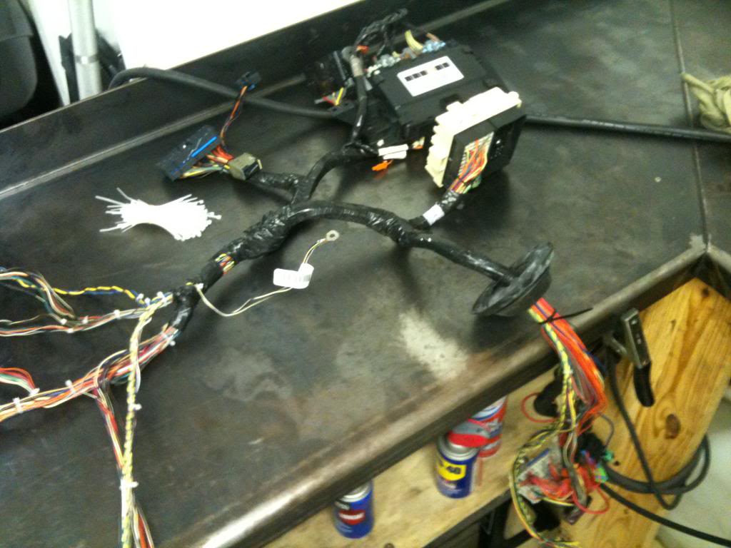

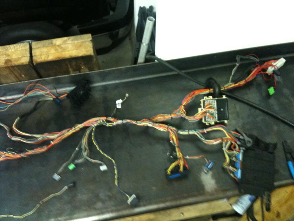

Got the in cab wiring harness done. My fingers are numb and I have a new found hatred for electrical tape. I started out chasing wires and untaping while the harness was still in the cab and that was just a huge pain in the *** trying to manuver around in there. Unwraping the harness in nothing short of a mess. That electric tape leaves a sticky residue on everything and GM made damn good an sure that that they uses a million seperate pieces, none of which were wrapped in the same direction.
So I just removed the entire harness and started working on it on the work bench, which was way easier. I have some before and after pictures but the funny thing is it doesn't look like I removed much until you see the pill of removed wires. No short cuts were taken, termination of each wire consisted of de-pinning the connectors. No wires were terminated by just cutting the wire at the connectors.
Wiring that was removed:
*XM Sat. Radio
*Complete HVAC system
*Air bag harness
*Wiring harness for the factory seats
*Misc. wiring that comes in from under the hood that I removed
Still retains am/fm cd radio functions with all factory speakers, steering wheel controls, in-cab lighting, automatic head lights, power window, locks, mirrors, factory gauges and dash lighting. Most creature comforts remain, save for the a/c and the interior will still look fairly stock besides the cage and seats. I'm keeping the factory carpet and floor mats as well.
All together I removed 4.2 lbs. of wire from in the cab.

Here are the pics.
Harness partially done but removed from the truck:
Here are pics of it finished up:
Doesn't look like much till you see this:
Cab without dash or wiring:
