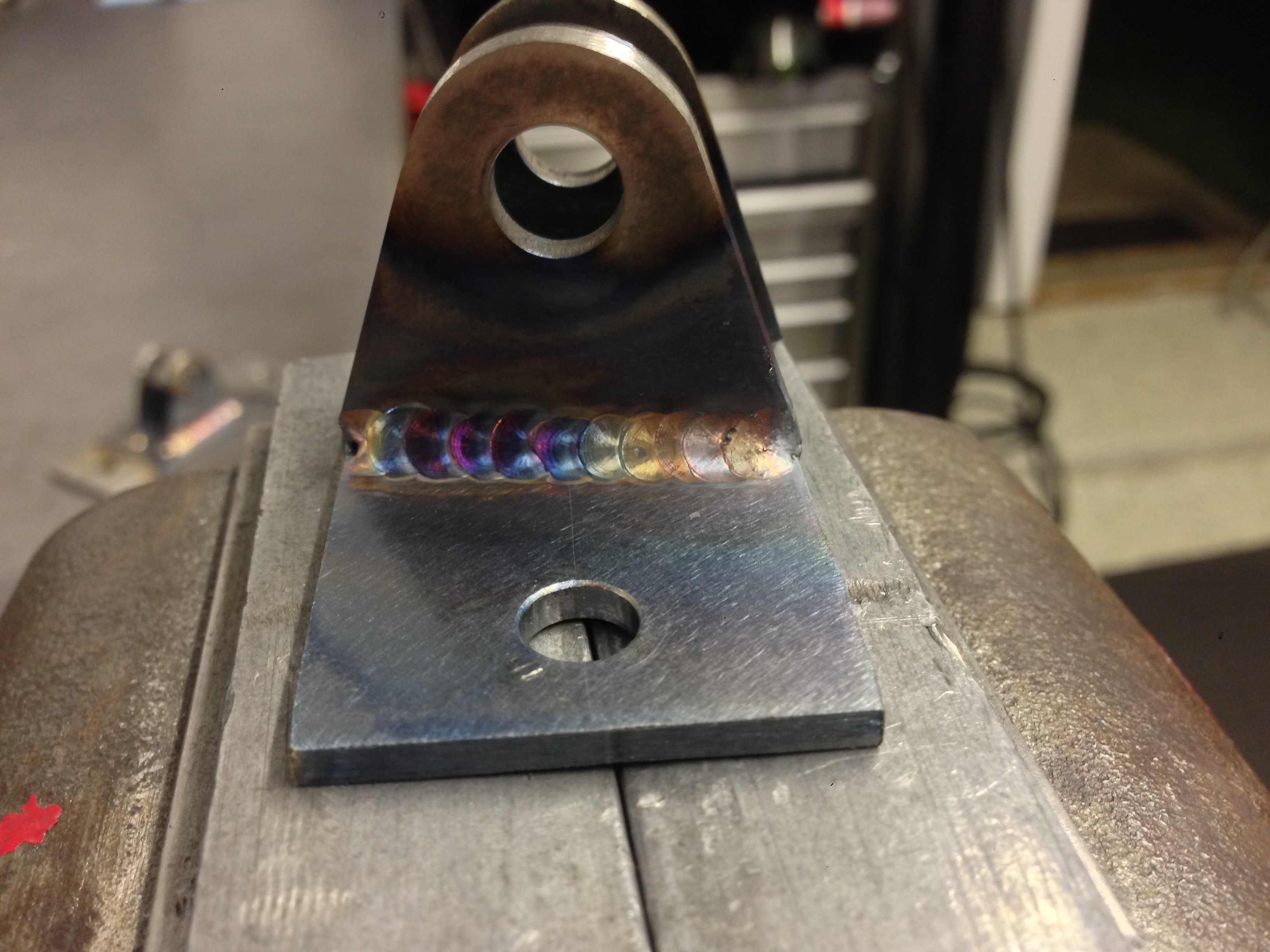

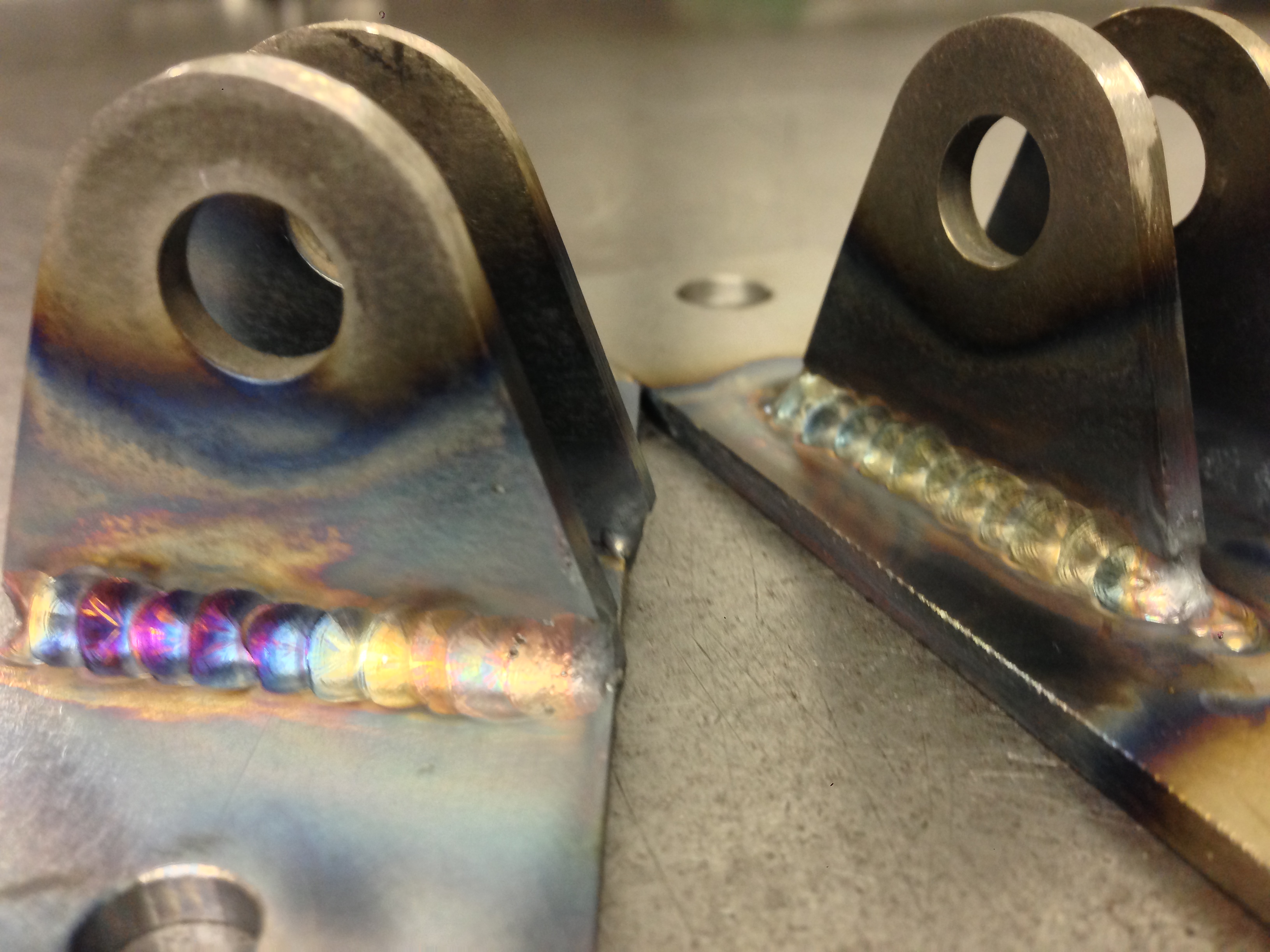

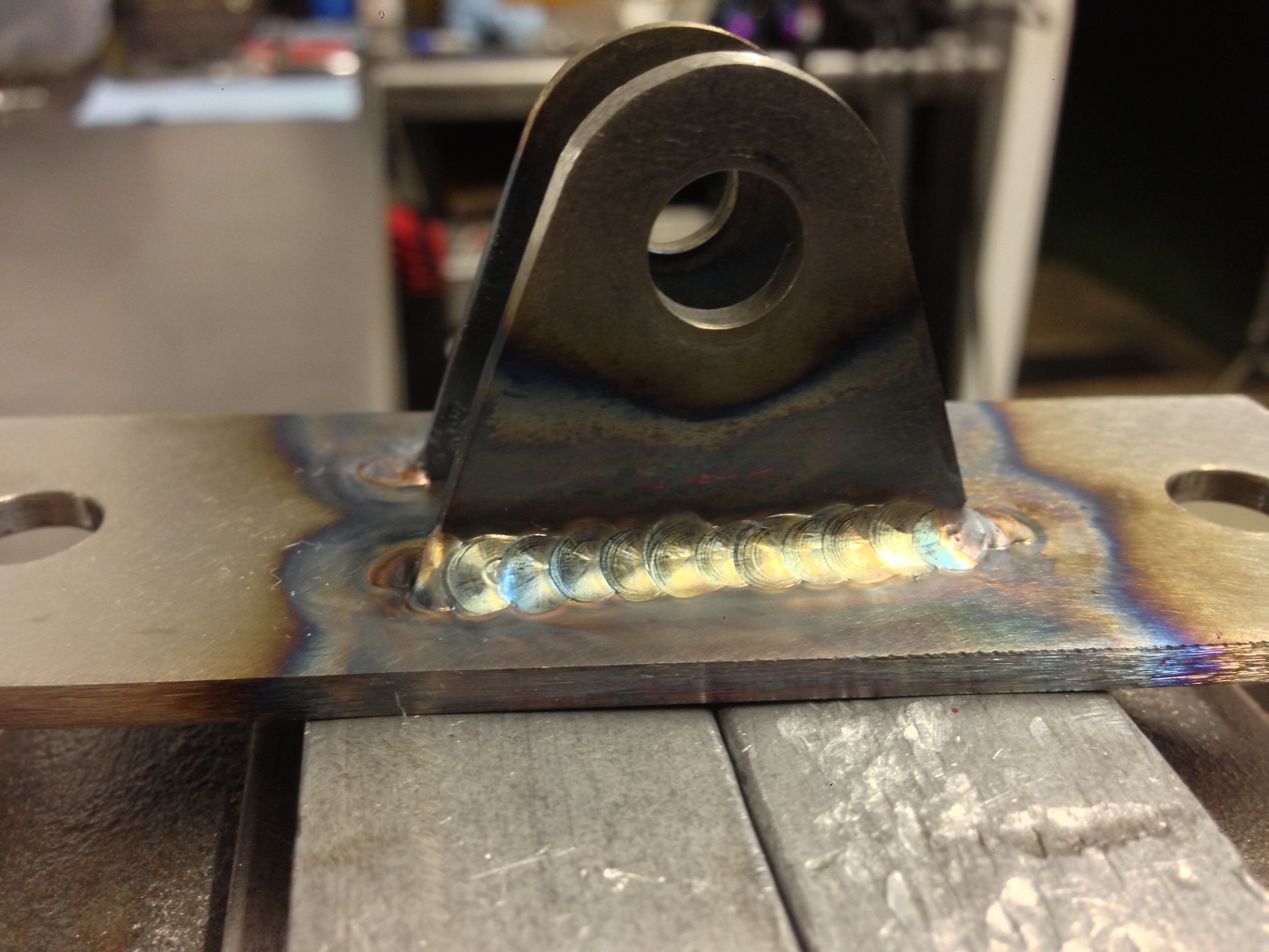

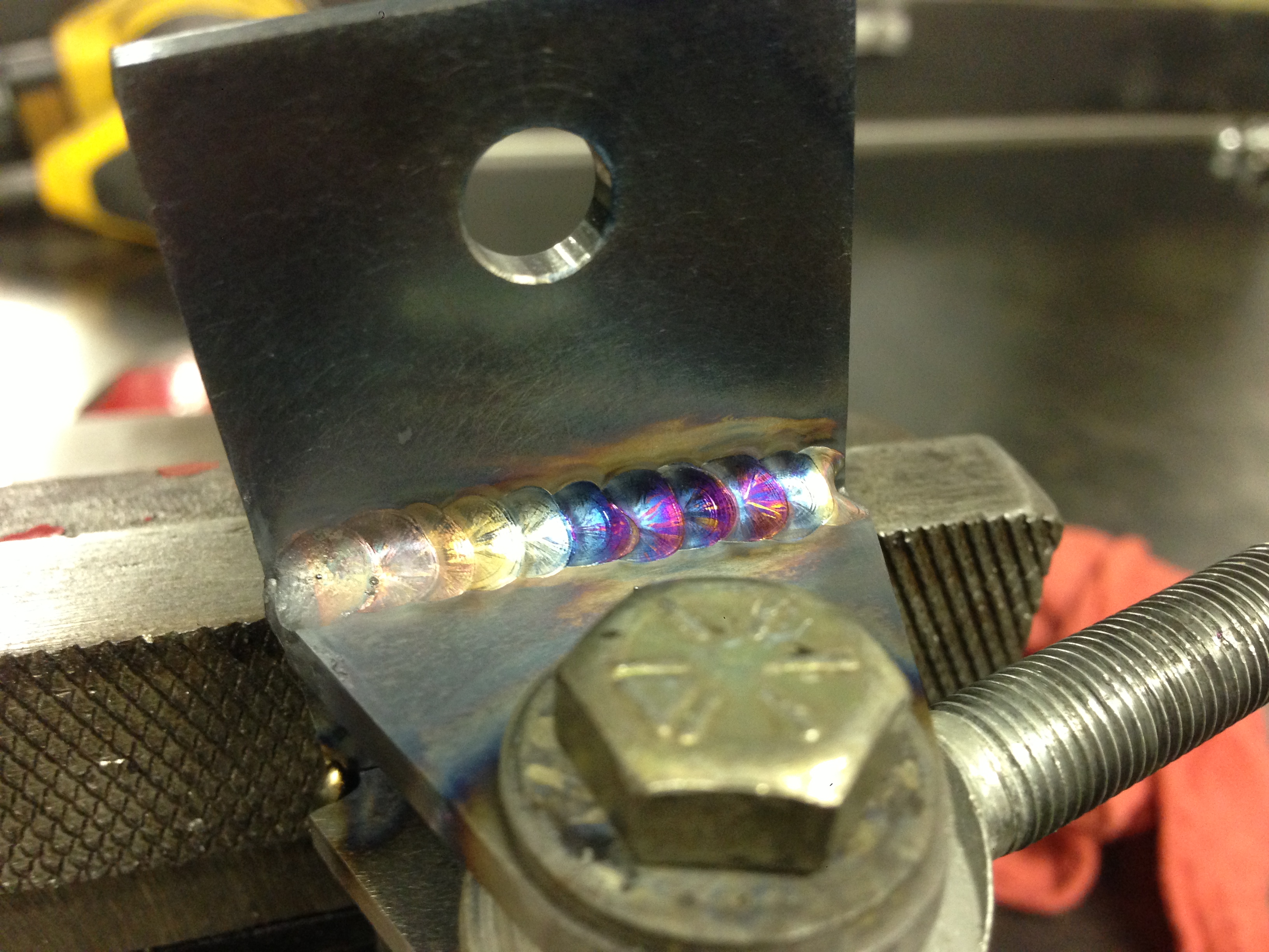

Welded up some mounts for the new engine limiters. Pics......

Mast said my heads were on shelf to....still took long
Also welds are looking good, can see youre using SS filler
Now change cup angle some and tighten up the puddles. This will give you a stronger weld ....you look between the puddles youll see deep points....those points lead to possible tears
But making solid progress!!!
