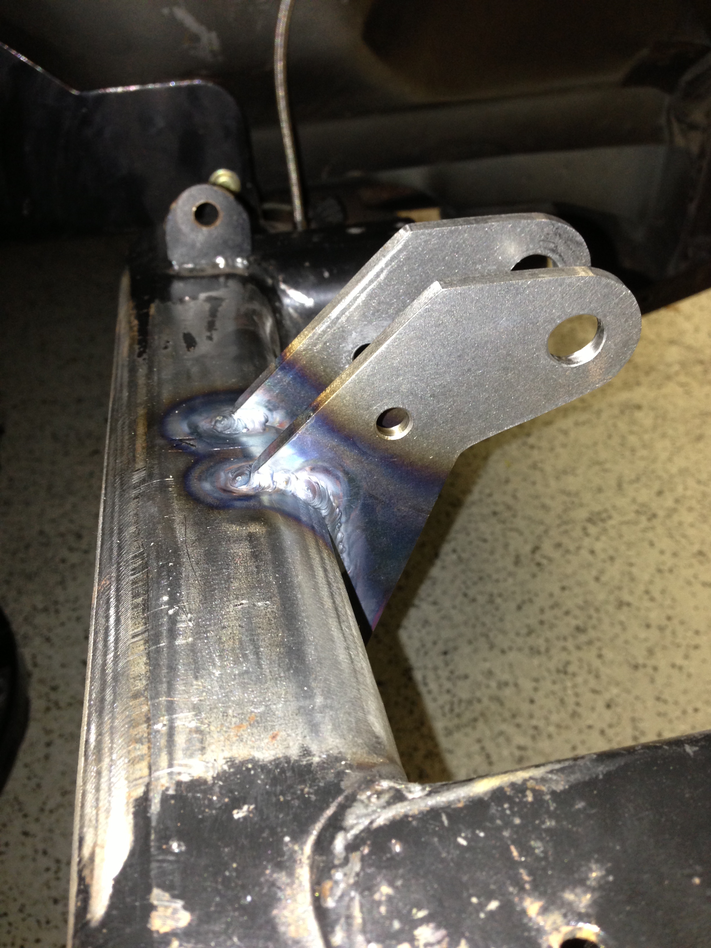

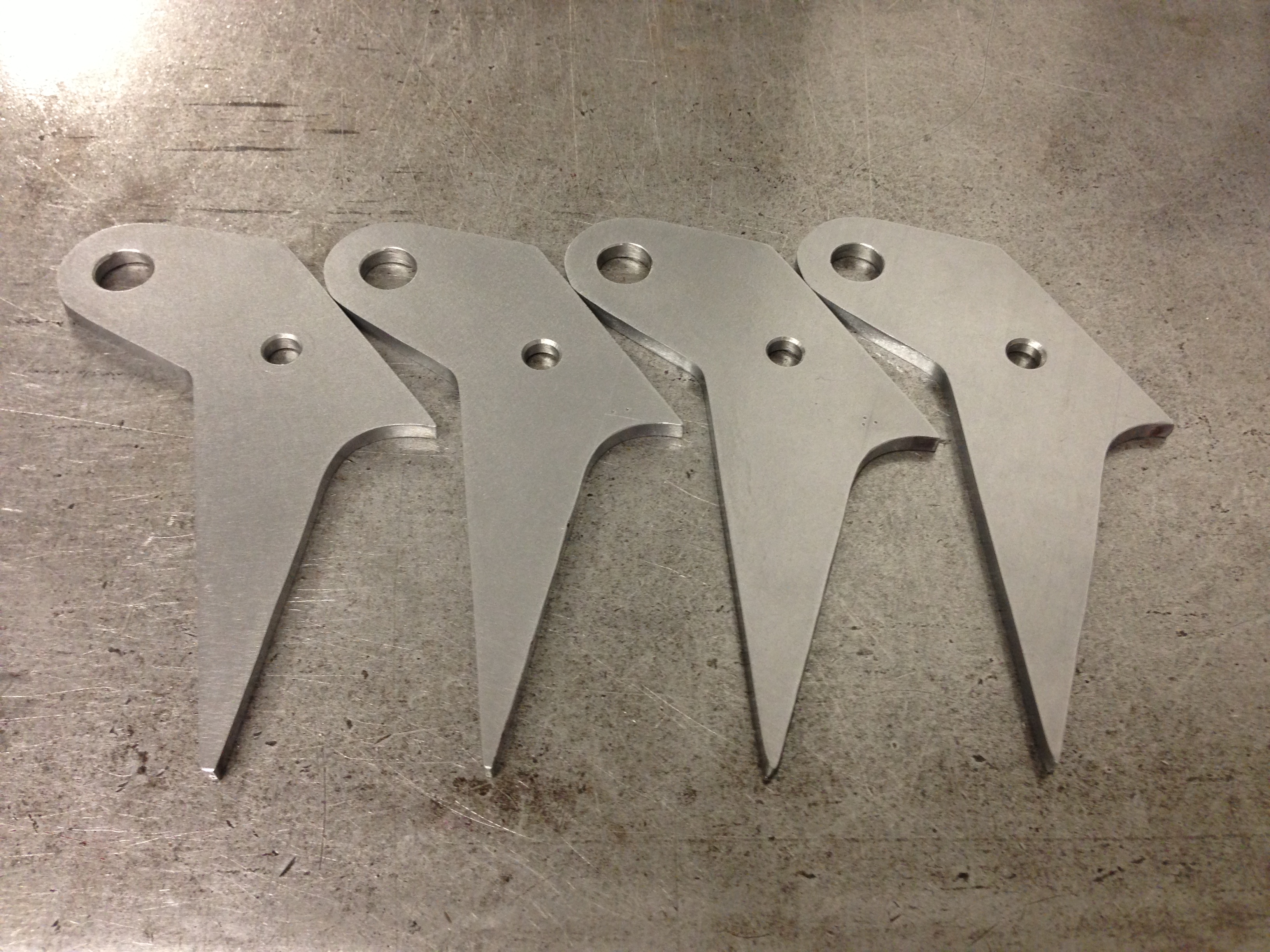

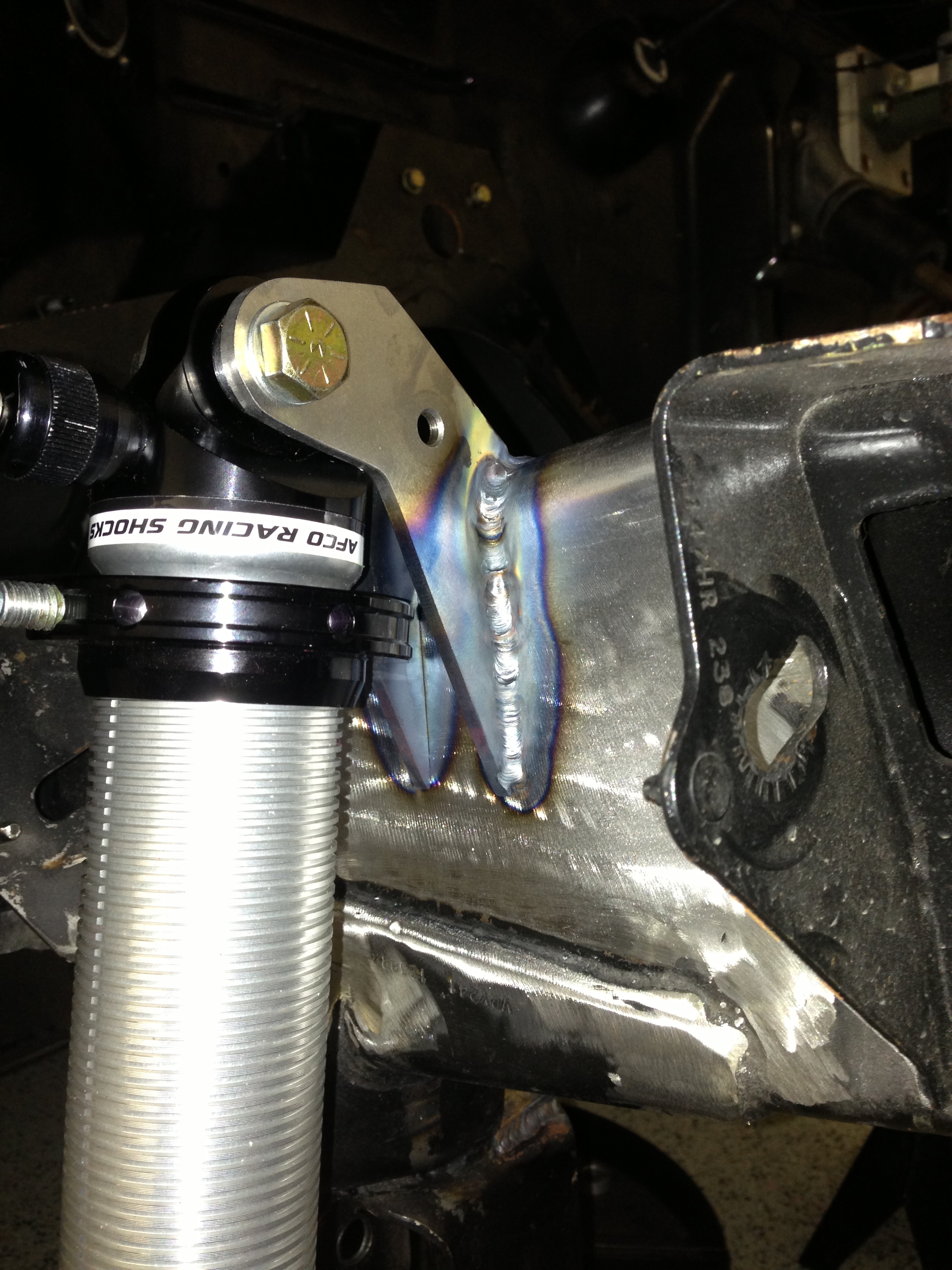

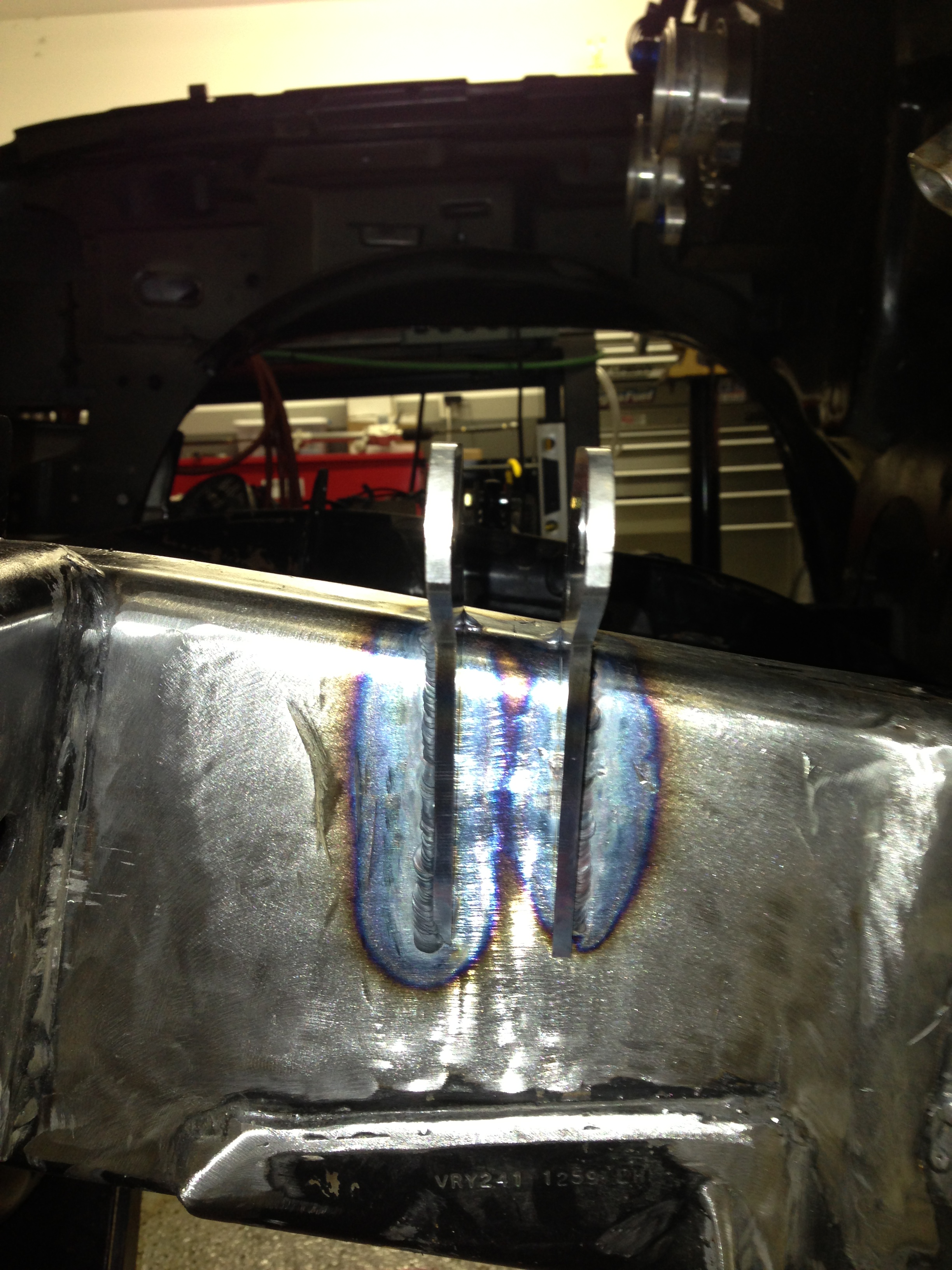

Here are some pics of the final brackets welded in. I'm gonna weld on a back strap as well and that will finalize the front suspension mods. What do you think?

Looks good, so does this solve the coil over problems you previously mentioned having with Race Craft Inc?
