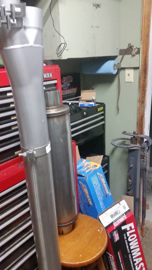

Its what I used too, worked out pretty nice.
It is about 24"s in length.

I couldnt get any further away but I cut my flowmaster deal about as short as possible and put it directly to a 4" cutout pipe
