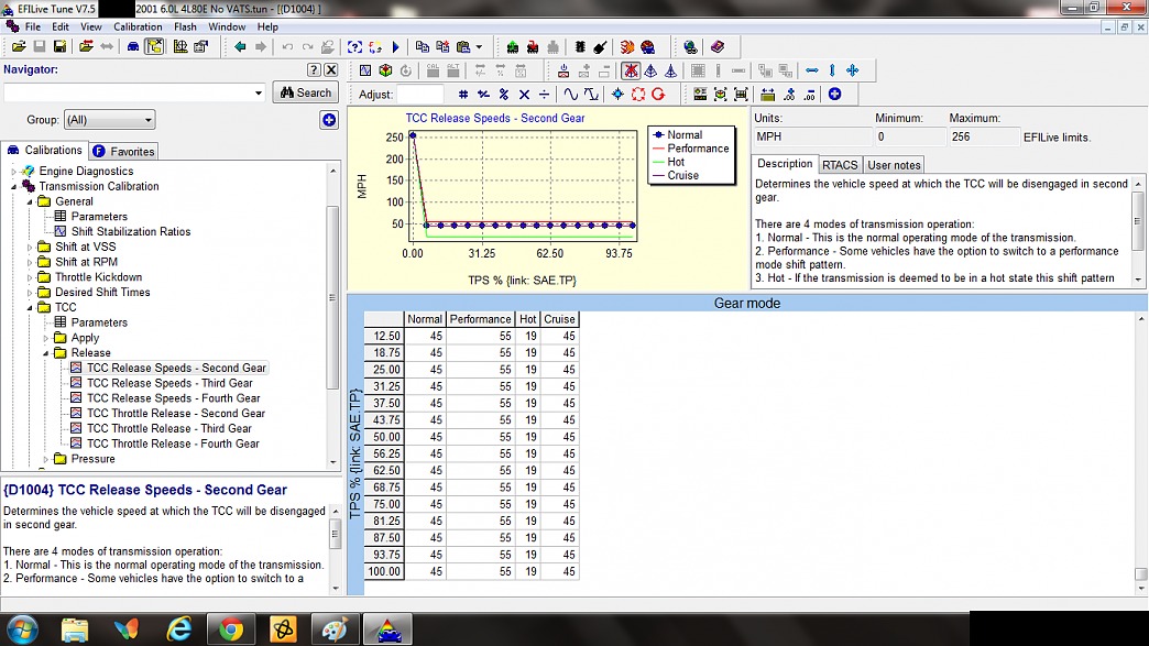

Here is a screen shot. It looks like you can set the TCC to release below a certain speed in 2nd, 3rd, and 4th.
Sounds like you can't change the Gear ratios with HPT???
So if you wanted to lets say run a 2.75 first gear in the 4L80E can HPT make the change for you if you send in the file???
Not trying to bash brands just trying to learn.
Yea that is a normal tcc release table. You could set it to only release under 5mph, but with an 80e, it used to still release if the tps went to 0. There wasn't a fix for it. Thats is why people would do the relay mod. So they could run the 60e tune with a 80e and keep the tcc locked even when the throttle was released. Search on here and you will read every 80e owner pissing about the tcc unlocking even though they tuned the release table to not unlock over a certain mph.

So even if you adjusted the TCC throttle release speed tables it would still do this???
MPH Vs. TPS %
Or was this just with HPT??? What did they add to correct this???
MPH Vs. TPS %
YES
Was not just with HPT. EFI live still does it from what I've heard. HPT is the only one with a fix. They added a minimum throttle release table to the tcc section as I stated before. Now it releases as it should.
