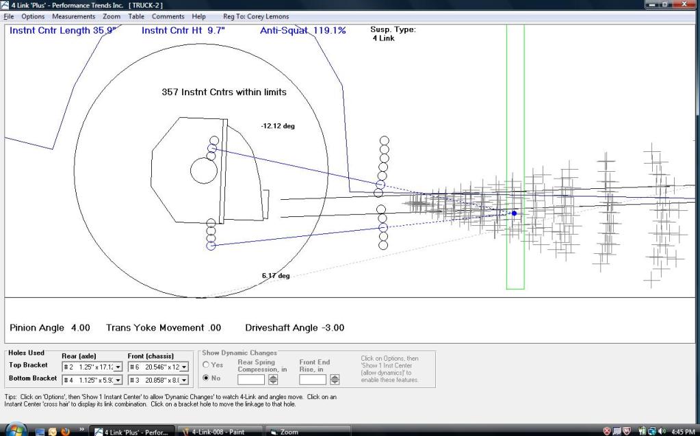

Here is what i am going with. Now i just need to translate the front bracket holes to paper and send it out to be cut... The bar length comes out to 19.5

How do you know when it is perfect? Cant tell **** from those screenshots

Actually i will not know it is "perfect" until i get it scaled and determine the correct Center of Gravity and the percentage weight of the rear. Those measurements will move that little green window and the diganol line going from the bottom of the rear tire to the front of the car. Basically what i was shooting for is a grouping of intersect points in a certain area...

I dont know **** about 4links. So I guess once you get the weights of the front and rear axles thatll give you your CGS and you want the angles of the bars to make those extrapolated lines to intersect at that point?

For the most part, then tweak it at the track...

I thought with 4-links you want to get the lower bars as parallel to the ground as possible?
Although, looking at the graph again, I guess when you get on it and the back lifts it might straighten the bars up some.

Actually id the lower bar was horizontal it would actually cause massive traction issues because it would push the butt of the truck upwards in my case.
