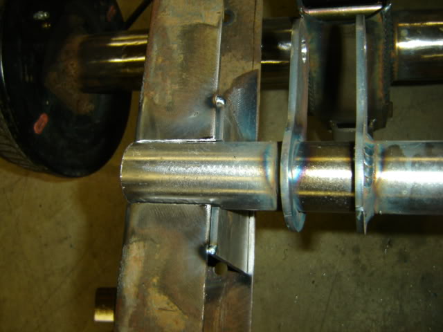

Do you have any better pics of that upper shock crossmember? Specifically about how you attached it to the frame?
not sorry it is all covered up... But i found this pic on another forum and I copied the design... basically i cut a 1.25 strip out of the frame rail. Then i notched a 5x5 3/16 plate then i sat the bar in the top of it. Turned out like the pic below.
