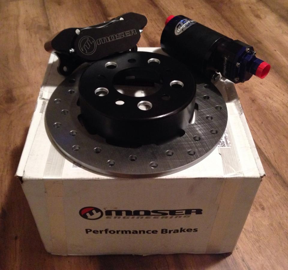

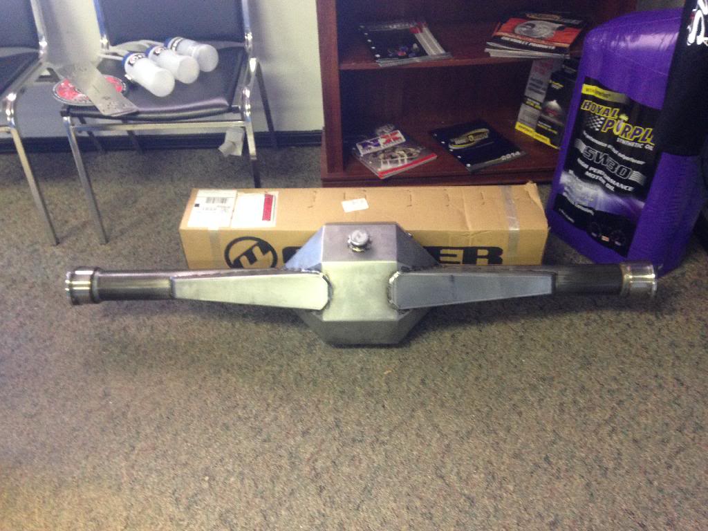

Moser M9 and brakes

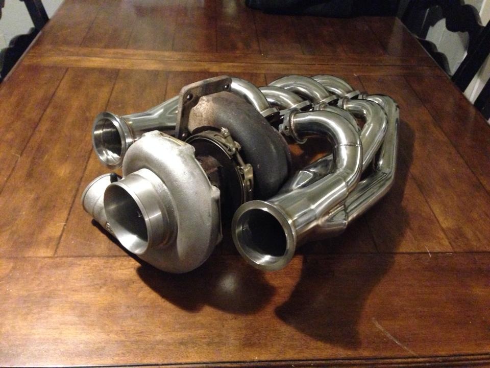

Headers and PT88

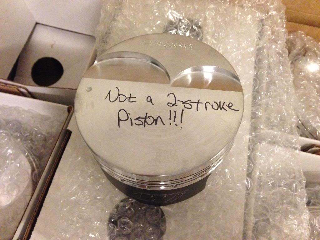

Pistons and Rods

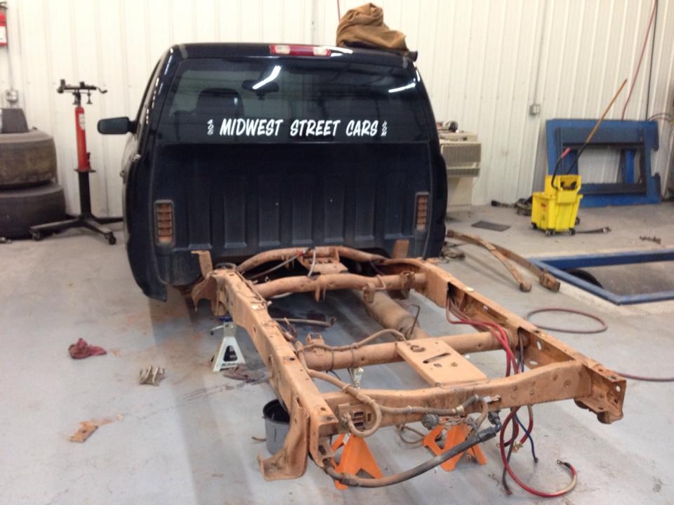

How it sits now

so did they build your frame out of clay? never seen that before.

33" tire seems pretty big...what gears are you going to run?
If those are the obx or ebay turbo headers im curious how you are going to get them to work....I have a set but am unsure about using them because they are so thin and come so far forward.
Time goals?
They're very big. Where the truck lives, the rollout is a must. I gotta get it done in 660' in less than desirable conditions. I'm just not into trying to make a small tire work. On the street anyways. Will probably have a 4.30 or steeper gear. Having said that, I would like to make some changes and take it to the track on a 315 radial
The quality of the headers I have seem really good. Not really bothered by that, but like you say, they stick out a mile. Not sure how that's gonna play out.
