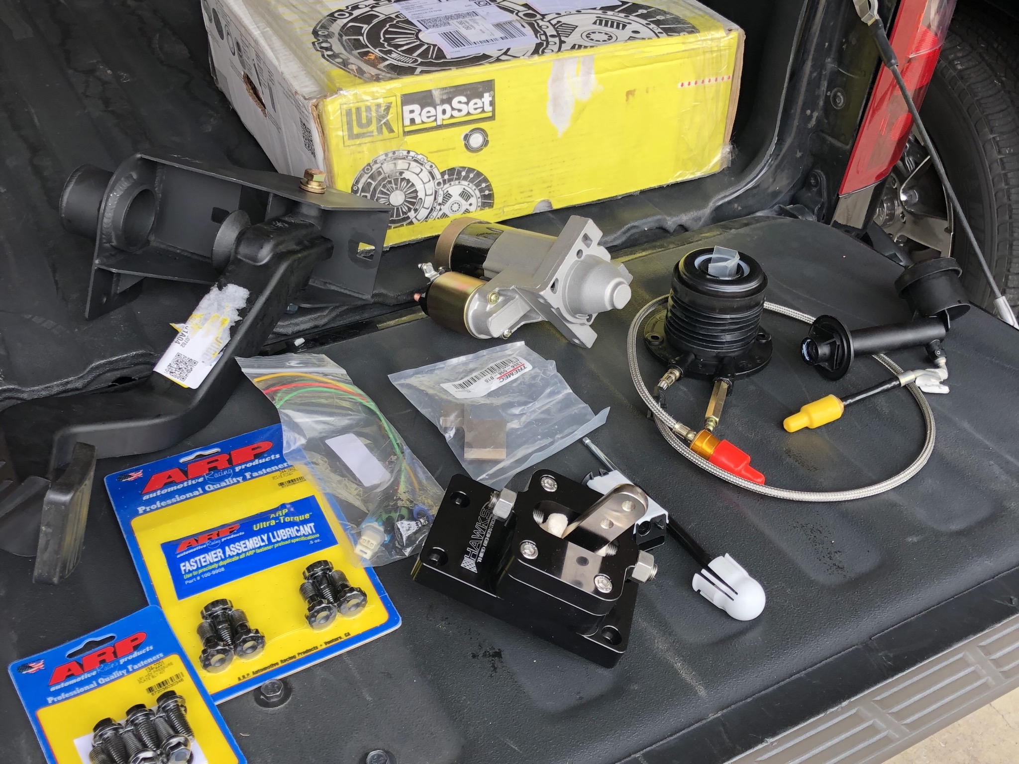

I have pretty much all my parts in except for shifter stick and ball. Will get that after t56 is in and I see where it sits. Started looking at where the pedal goes and this part will suck most!

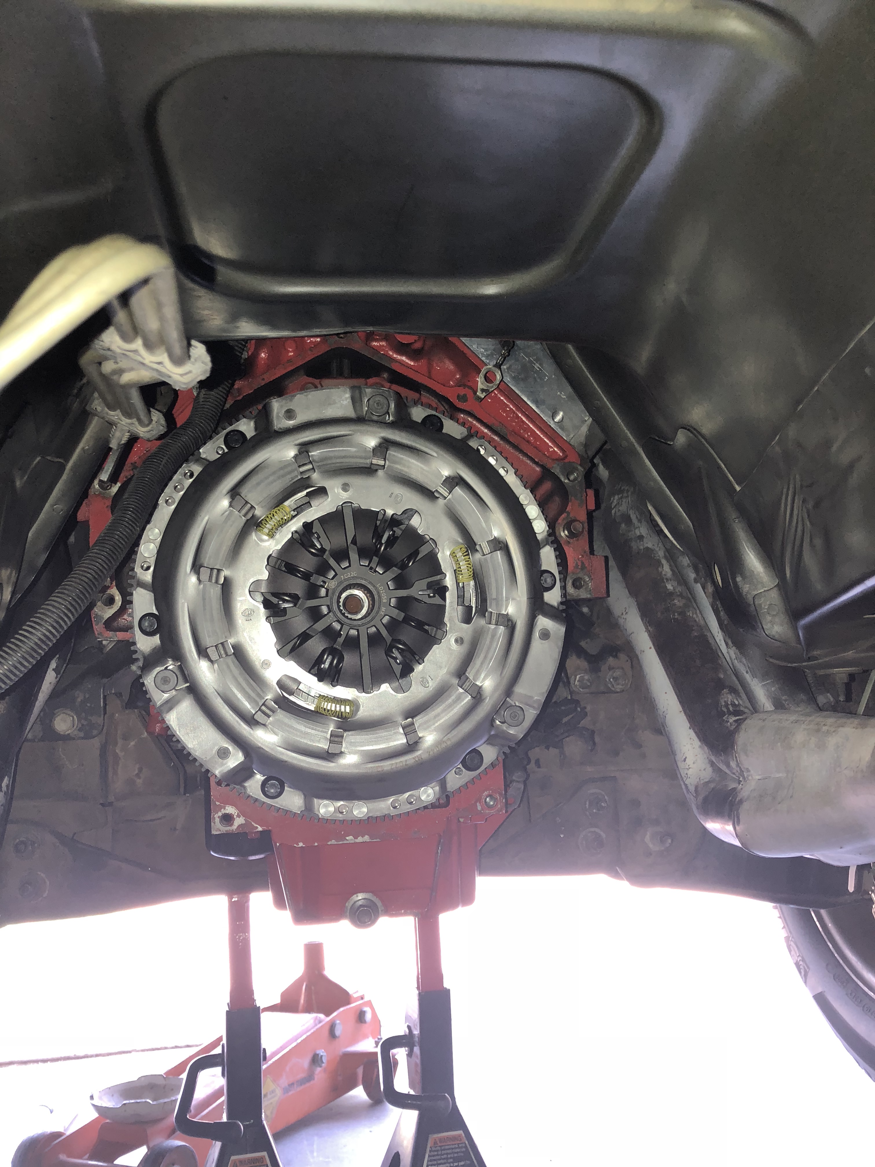

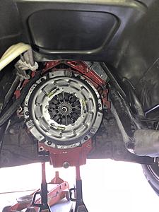

Got the clutch put in this weekend. Started on working with the wiring as well to get rid of the black box from the automatic. Was going to put the bellhouse up but decided to get new bolts for it that dont have the long threads sticking out that require you to have a deep socket to remove them. Clutch pedal position pigtail should be hear to complete wiring and waiting on a bracket to mount clutch pedal. Constant waiting game here
