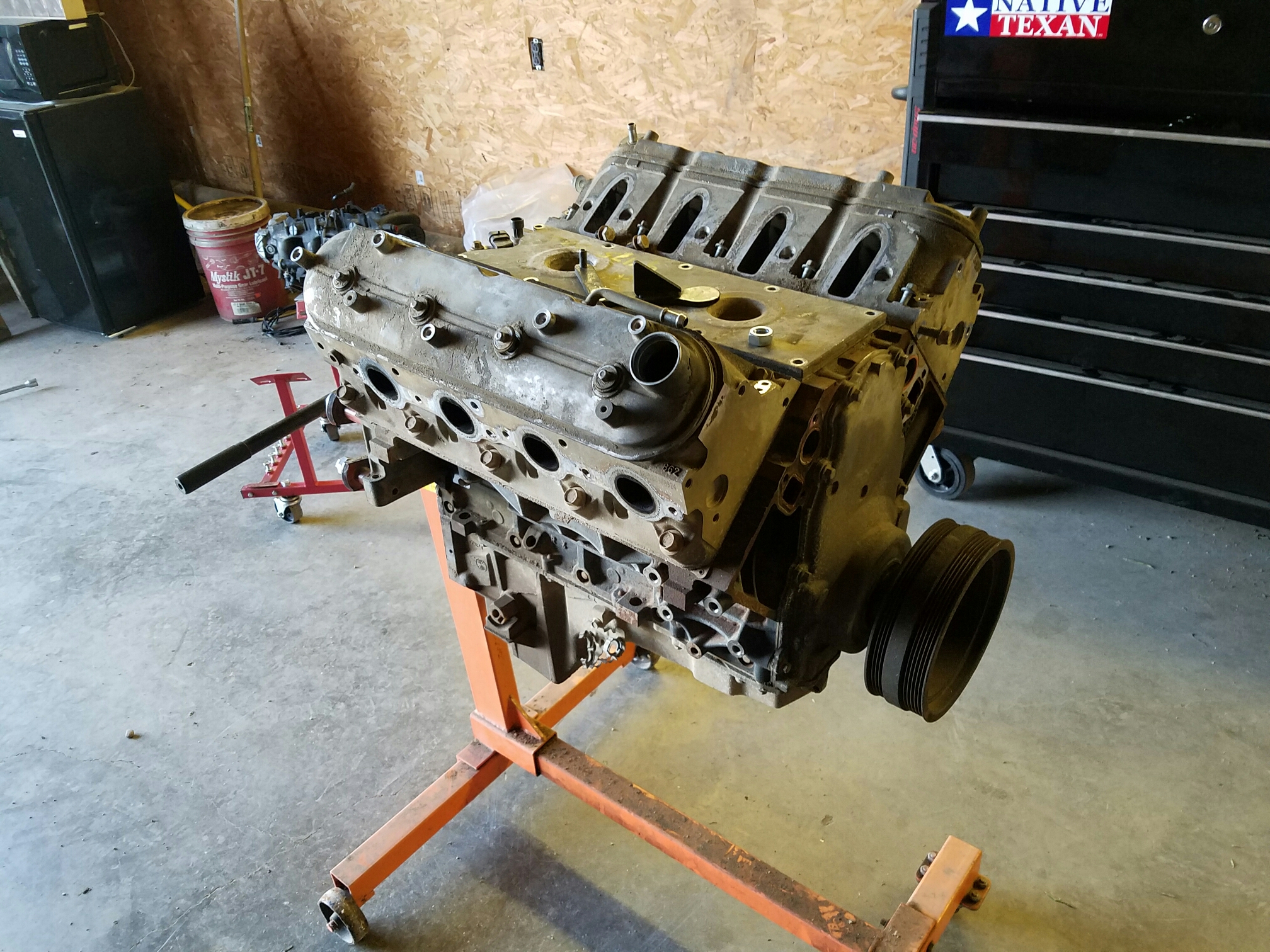

So my truck hit 283,000 miles last week. 02 xcsb z71 with a 5.3L. Original engine 3rd transmission. All the cosmetics are done, taillights headlights new front bumper ect.
At 283k she's beginning to feel tired. Have to put your foot in it harder and longer to get same results. So I bought another 5.3L! With intentions of new gaskets bearings bigger cam that didn't require tuning and polished heads.
That was before I found out the engine I bought for 350 bucks was the stereotypical Craigslist special. Bottom end is trashed. Pictures are attached, I'm gonna say someone sprayed nitrous down its throat to get a few cheap runs down the strip.
But since it's needed a lot more work than I had planned, why not run with it? Gonna have the machine shop punch it .040 over, take .020 off the deck, and make sure the mains are still straight. Put 6.1" 4340 rods into it with flat top pistons. Still going to have the head work done but thinking about upgrading to a 2 inch intake valve. And moving to a .540s lift 112 lsa cam (can't remember exact numbers) installing a water/meth injection kit to keep the charge cool.
Wanted to do something like efi live on diesels where they have 5 settings, one for exhaust dumps closed, spraying water (they're in front of the cats) one with dumps open, spraying water, and same two with methanol being sprayed so we could throw more timing at it
Attached Thumbnails Big girl is getting a new heart-img_20160625_135849.jpg   Big girl is getting a new heart-20160702_232232.jpg   Big girl is getting a new heart-20160702_201839.jpg

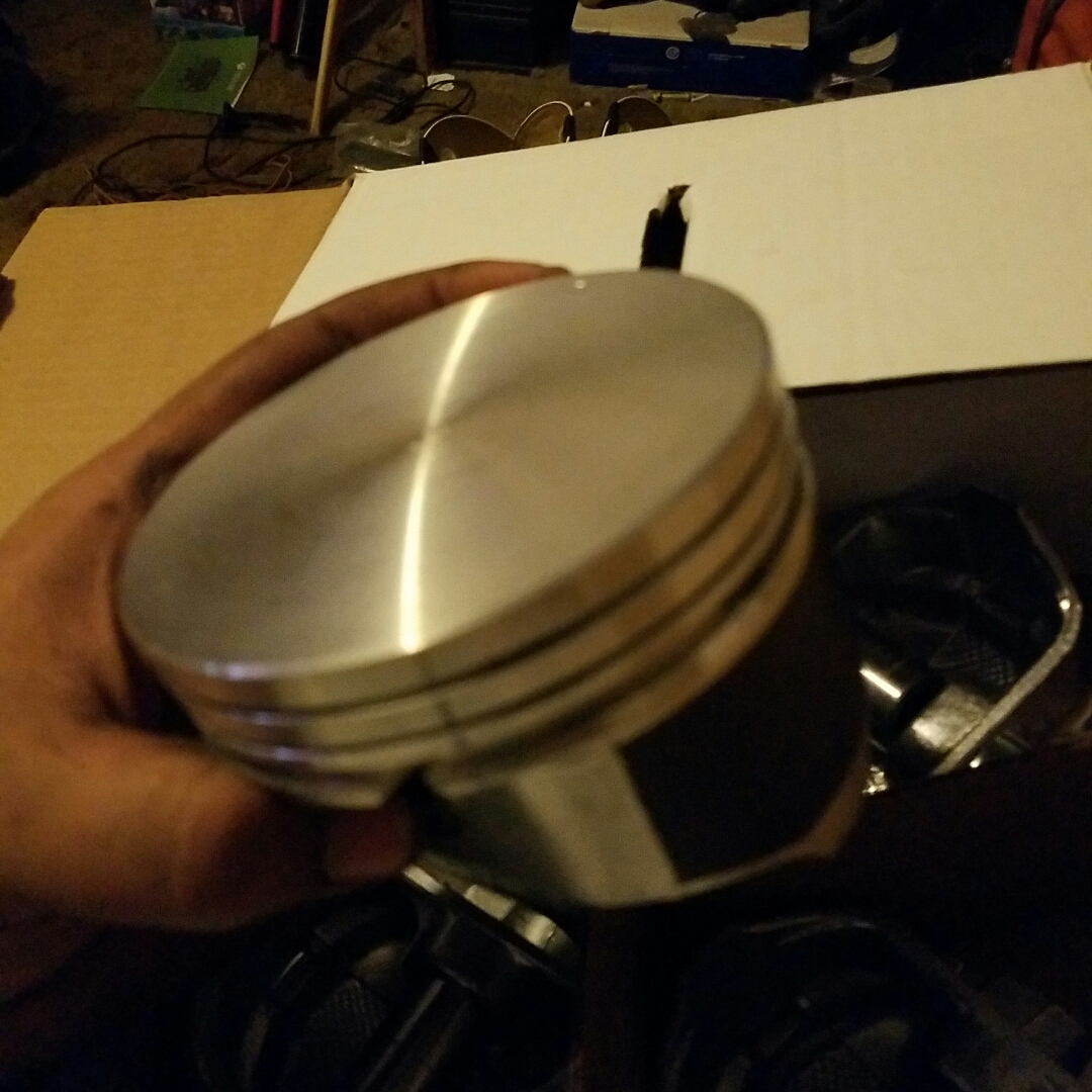

Pistons are in. 3.82 diameter (not exactly but didn't want to do the exact decimal) 1.324 compression distance.
Silv-o-lites flat tops from kieth black
