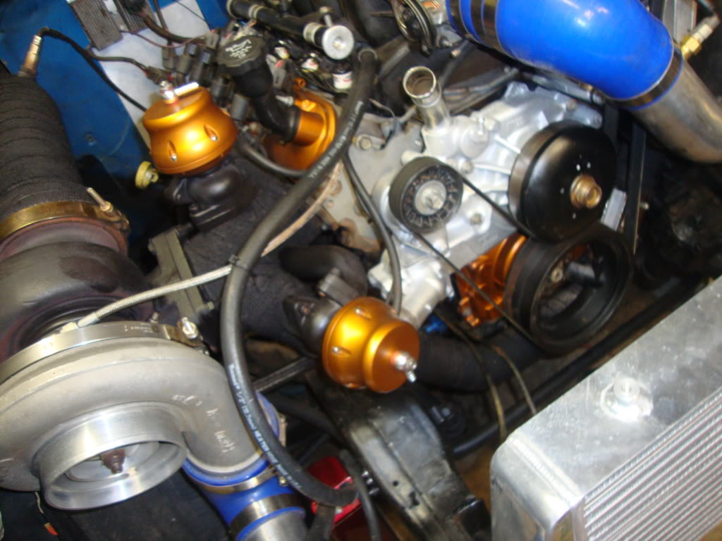

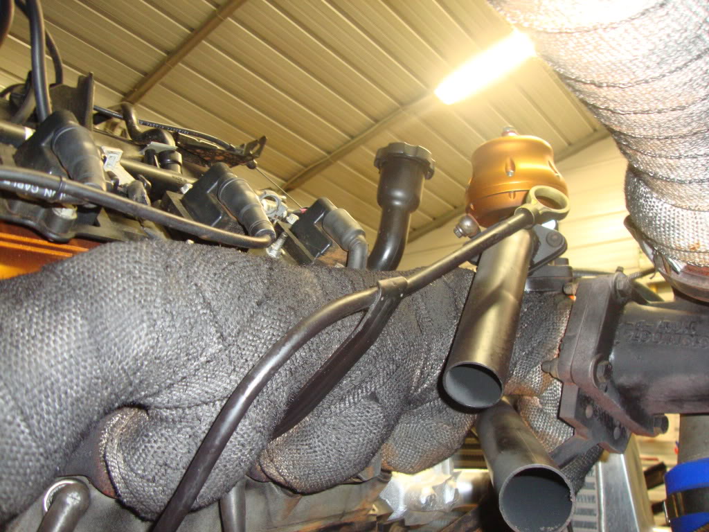

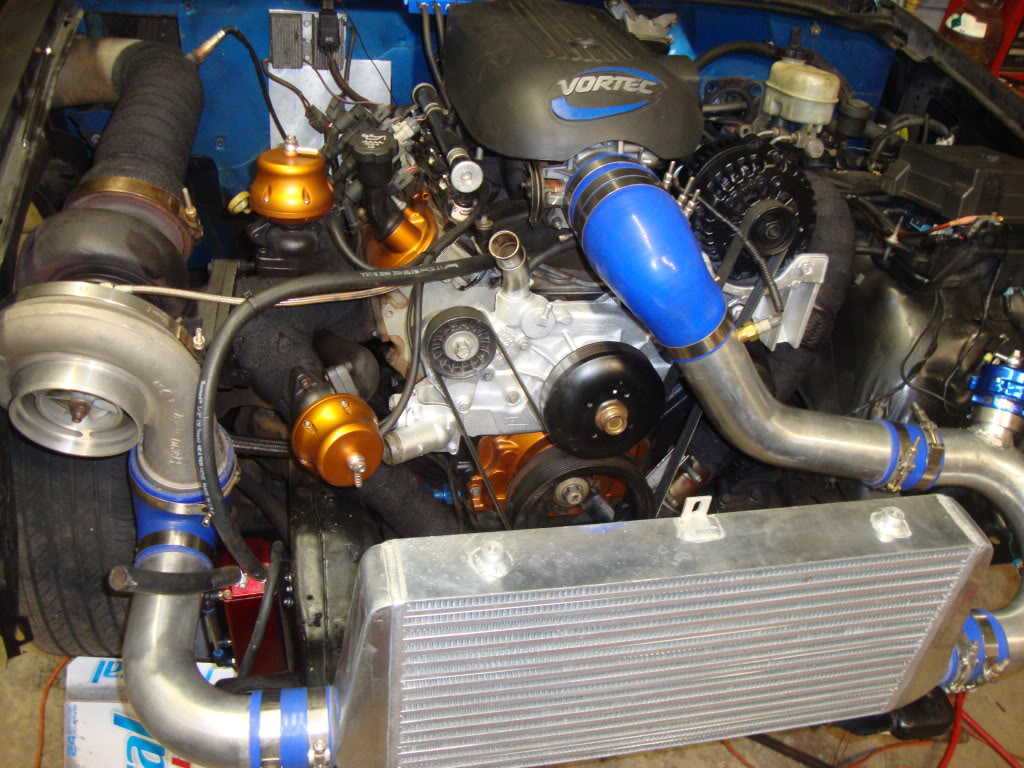

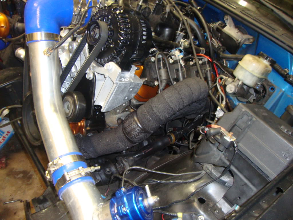

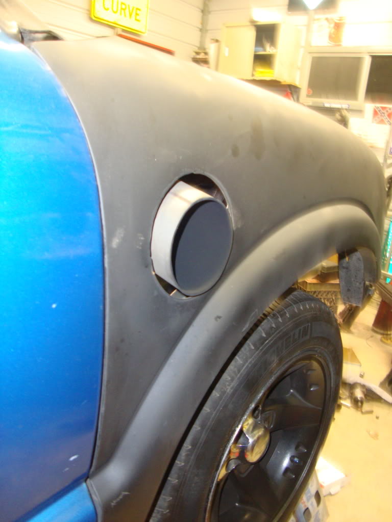

Got the cam and springs in. Heres a few pics of the set up.
