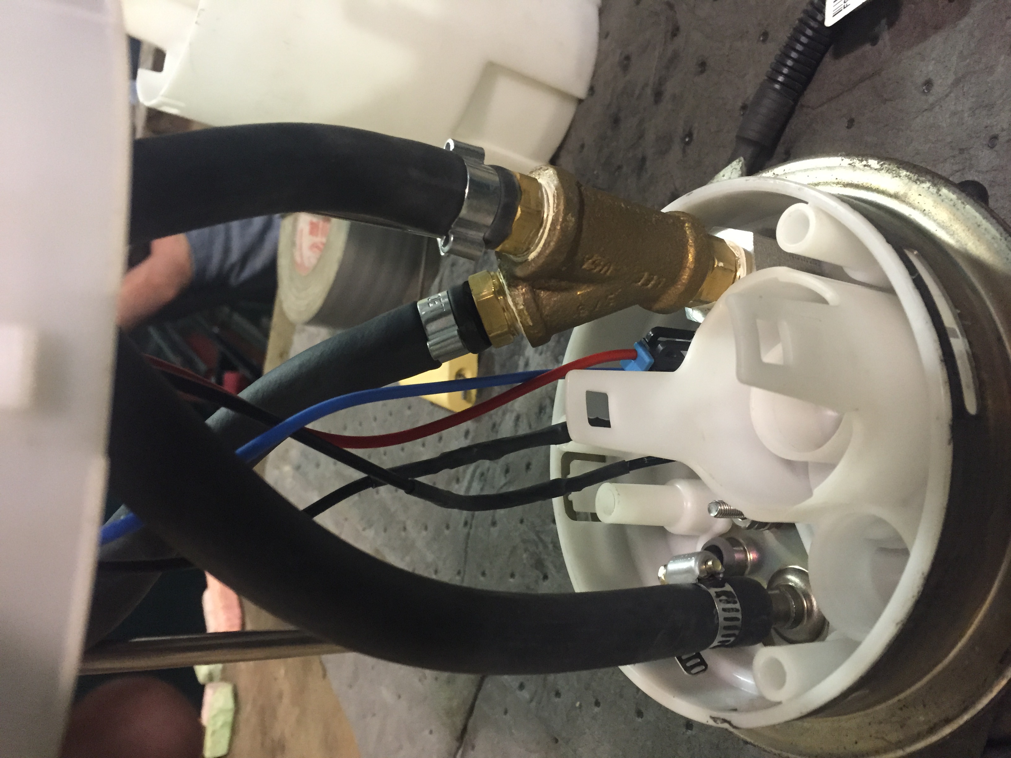

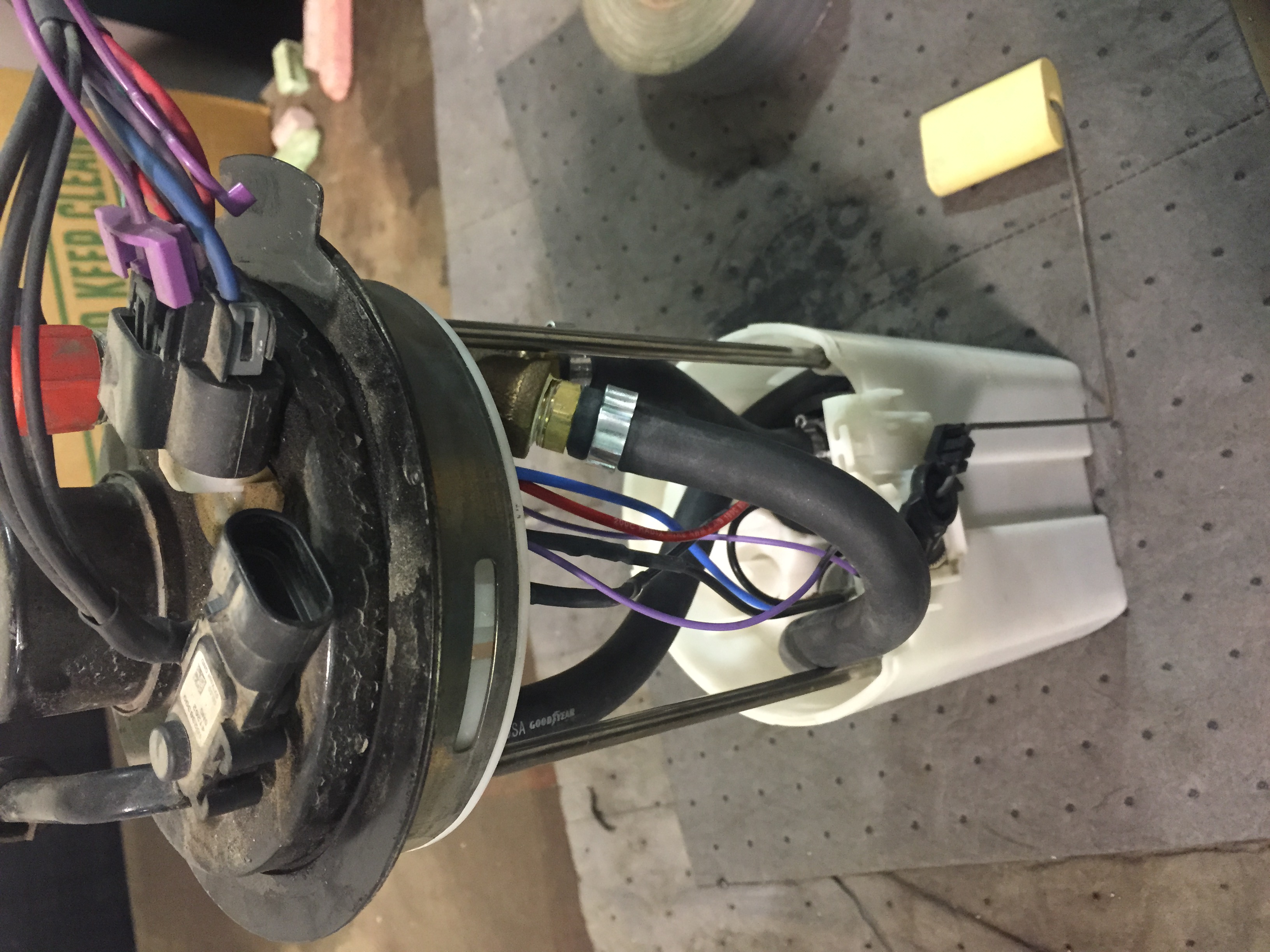

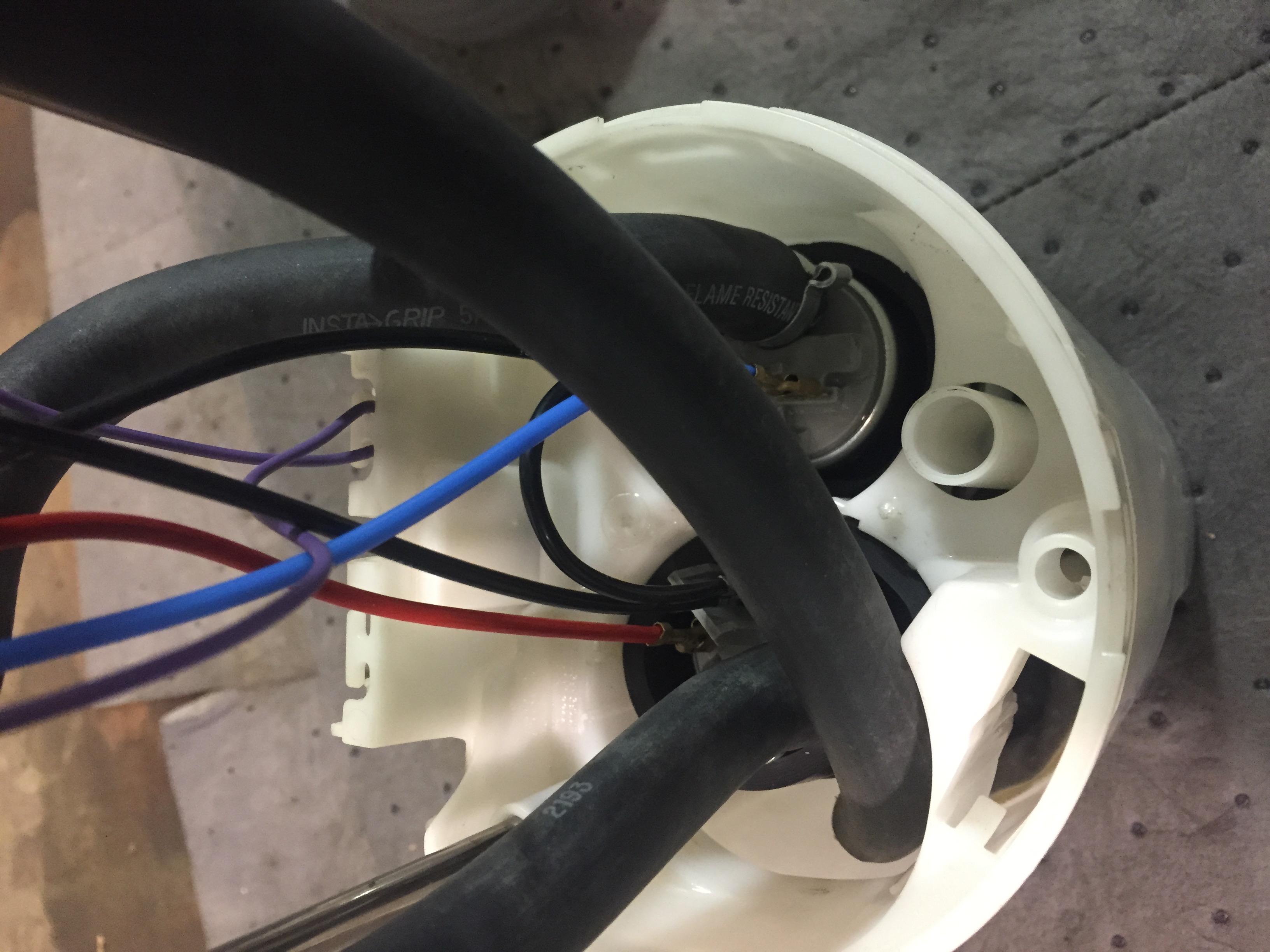

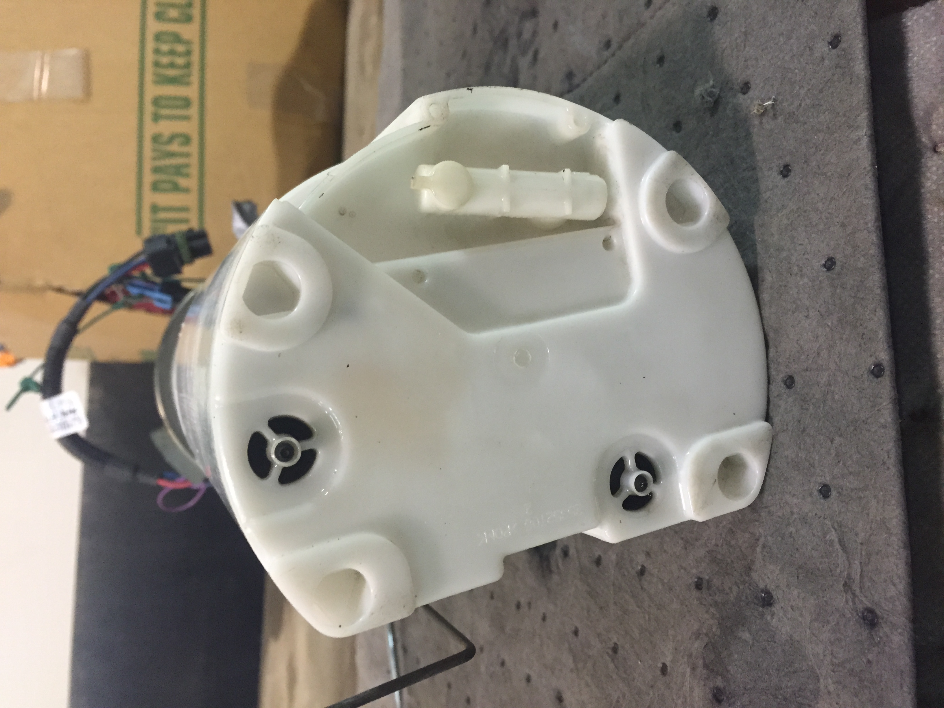

I'm hoping one of you guys can see something here that I don't.
I have dual 400 pumps with a racetronix harness. 7psi hobbs setup. My blue wired pump was originally the primary pump. As I started tuning my truck and I got up to about 5psi the pump started dropping pressure. I didn't think a 400 should have any problem keeping up with my setup under 10 psi. I swapped pumps to the red pump as the primary and I had to take a bunch of fuel out of the tune because the pressure was stable. Then I continued tuning up to about 7psi with no problems. So I am assuming it is a weak pump out of the box. Take a look at my pump setup and let me know what you think? Plumbing or pump? I have a lot more pics, but photobucket is being a pita tonight.

Can you pressure test it on a bench? Put it in a cooler of water and hook the output to a regulator. Is the hose submersible rated? It might have a crack or split in it somewhere thats not obvious. Are the socks getting smashed in there so it has a suction issue? When you bench test it you can test the voltage drop at the pump.

Posts: 16,282
Likes: 438
If he is running straight off the hobbs that would be an issue, but hopefully he is just using the hobbs to trigger a relay. Wouldnt affect the always on pump though.
The hose is submersible hose. I have made that mistake a long time ago when I had to redo the hose on my first 255.
The socks that I got come out at a 45* angle. I thought that would save me from smashing it on the bottom and cutting it off from supply. I could be wrong, But I don't think that is the issue.

The way my harness is setup, you can swap which pump is the primary and secondary pump by just swapping plugs around. Or I can take the Hobbs switch out and run both pumps continuously. It is actually pretty handy if you have a pump fail or in this case a weak pump.

Posts: 16,282
Likes: 438
You should probably test them up to 100psi or so. You could make something work with some home depot parts or you could use a real fuel regulator. 0psi test wont tell you much at all.
