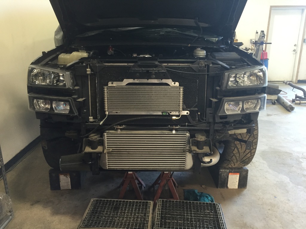

Well. I got to drive the truck last night. n/a first time in almost two years. Thing feels like it should run ok. Didn't do to much. Since it was 1am and I drove it to the gas station 3/4 mile down the road. Put 10 gallons in it and drove back to the shop. No bumper, grille or license plate. Lol.
Fuel fill mod worked great! That makes me happy!
Here is my filter mod for running it with out the turbo.
