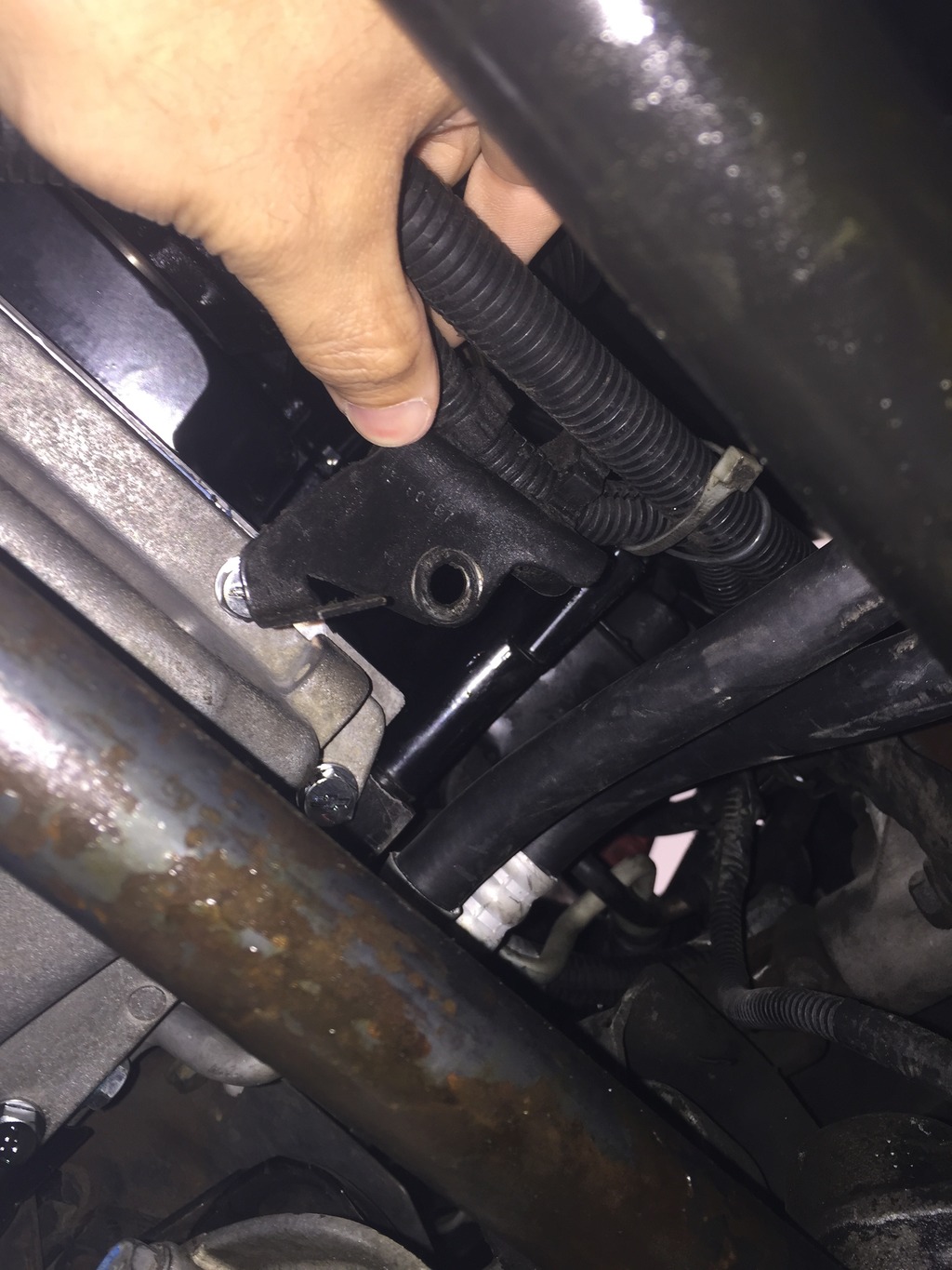

Does anyone know where this bracket goes? I unhooked it from the motor when I pulled it. I left it hooked to the wiring and I still can't figure it out. I thought it bolted to the front of the pan. But I can't figure out how it went. Ideas?

Kinda looks like it goes on the transmission. Is that the front or back of the transmission pan?

I guess I could have been a little more specific. Sorry. It is at the very front of the engine oil pan. I thought it went to the front of the timing cover on the front bottom driver's side. But it doesn't match up right.

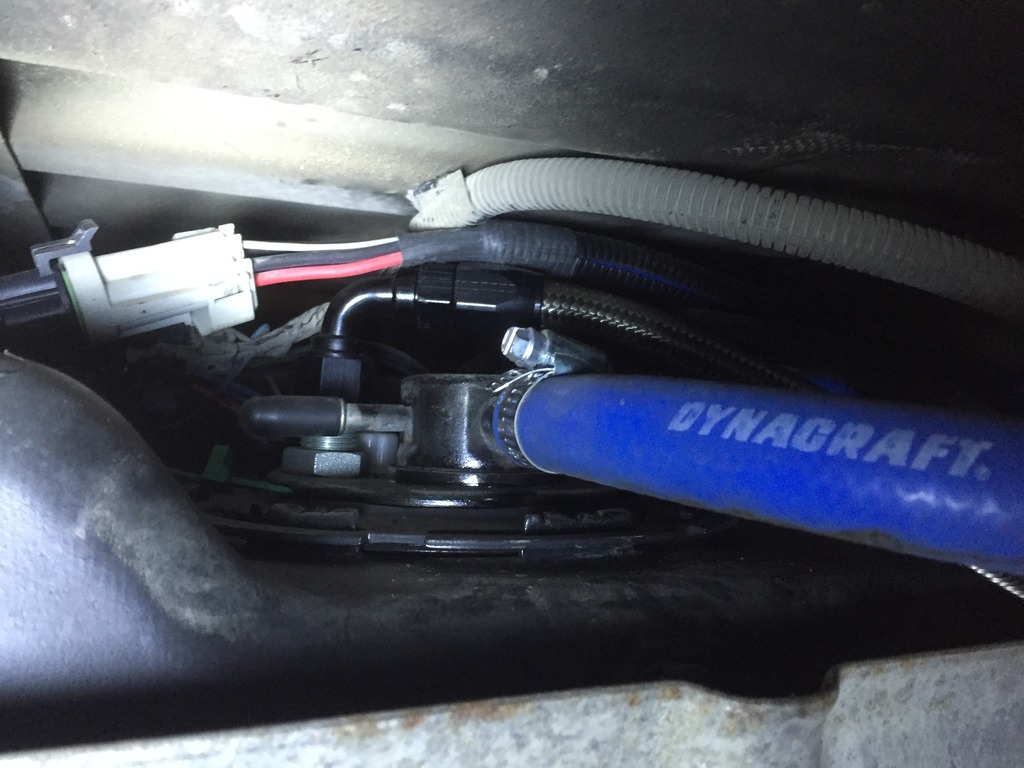

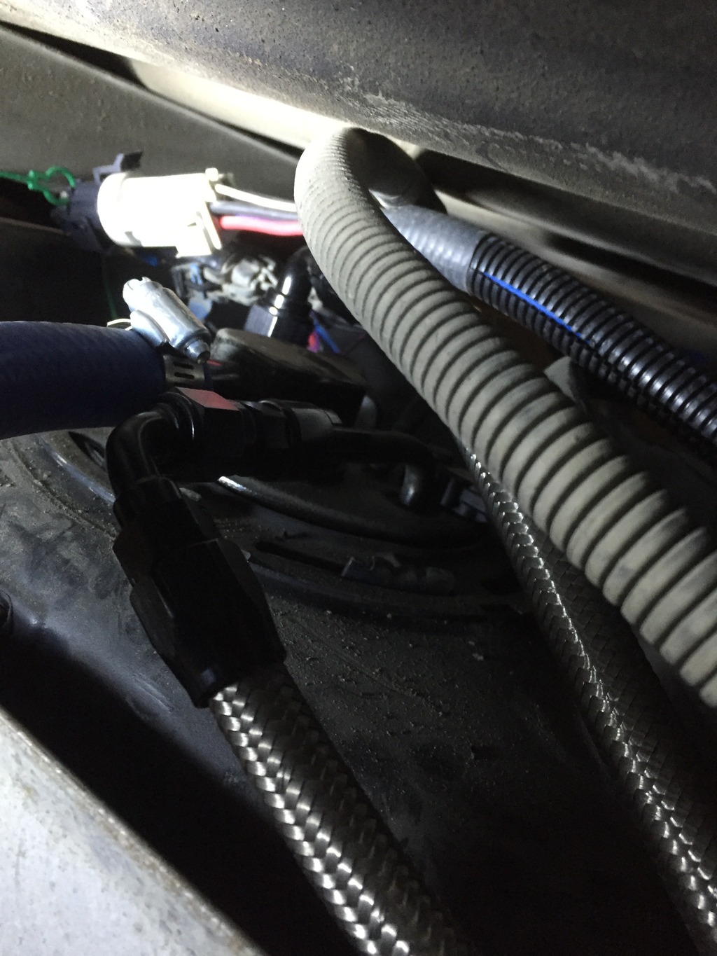

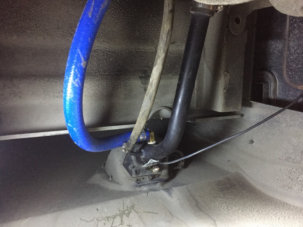

I worked on my fuel tank vent today. I remember someone talking about having problems fueling up their pickup after removing all the emission equipment on their truck. So I ran an extra 5/8's line from the rollover valve to the top of the filler neck. Hopefully this works for me. I think atomic is who originally told me about this.

Yep, that was me! Thats basically what I did except yours is much cleaner. I just had mine going to a littler filter up there.
