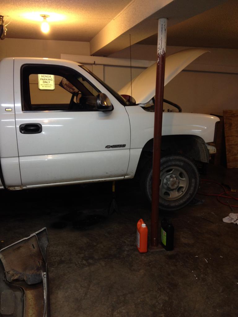

Couple days later:

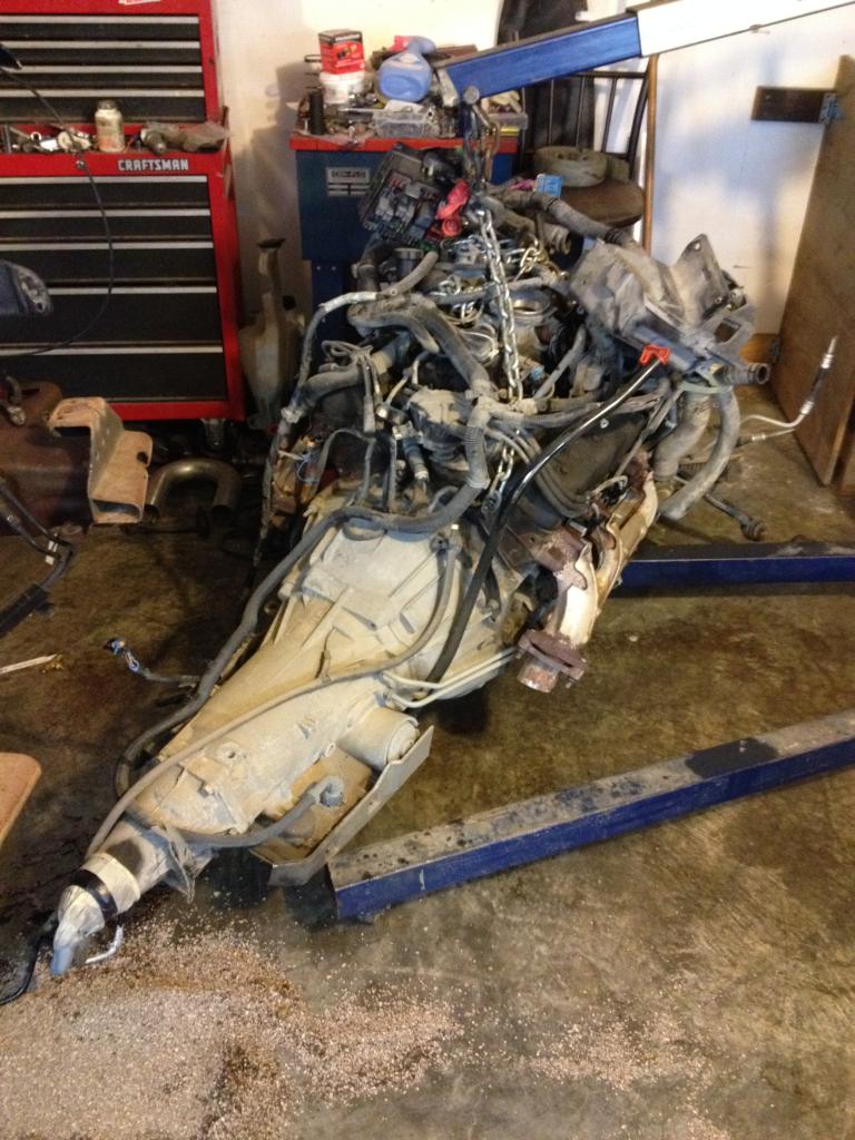

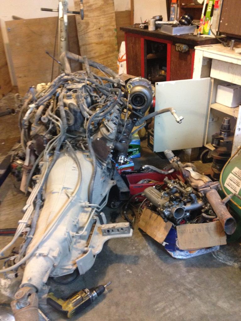

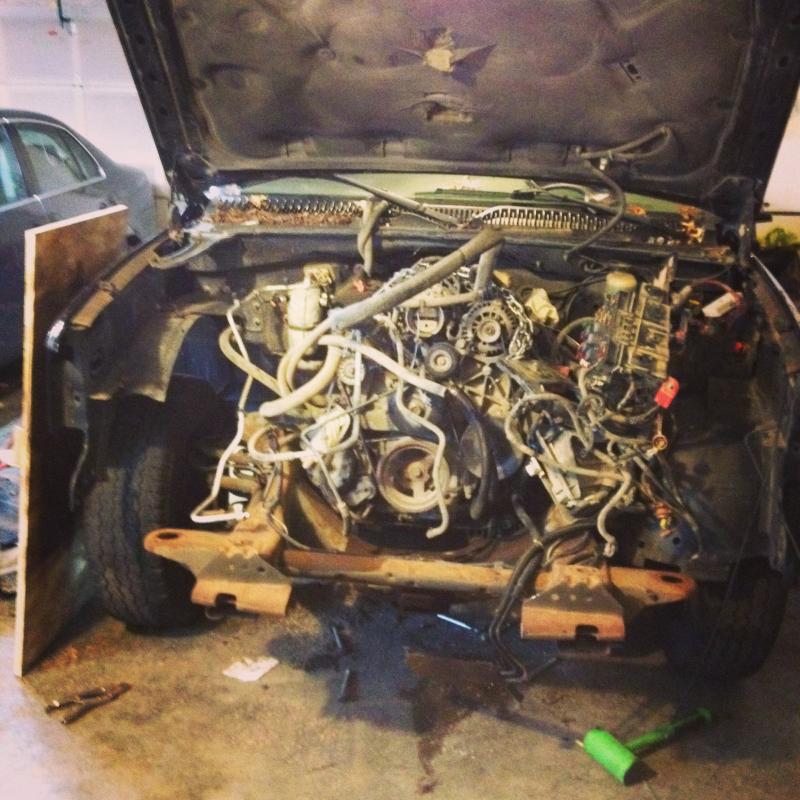

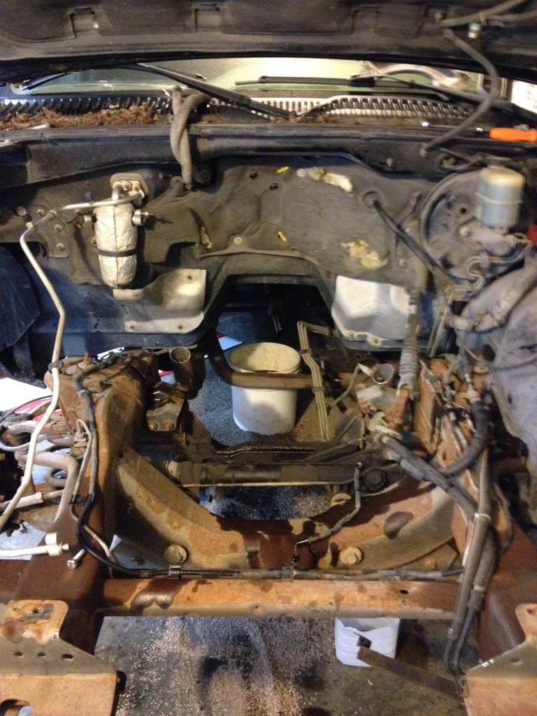

I took the 4.3 and 4l60 out last week:
This is where I have left off...
Just had our son a couple of days ago, so when te time permits I will put it all back together.
Comments and suggestions are welcome

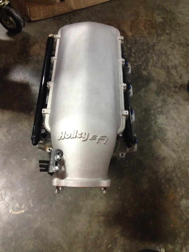

Future plans:
Holley high rise intake
80# injectors
Walbro 450 in tank pump
Braided lines from tank to rails
Areomotive 13109 regulator
Triple 12 cam
Isky matching valve springs
E fans
Ls performance wiring fan harness
Trans go HD2 shift kit
Circle D 3400 stall
4:56 gears (not too sure yet)
KB turbo manifold
On3 gt45
Tial MVR wastegate
Air to water intercooler

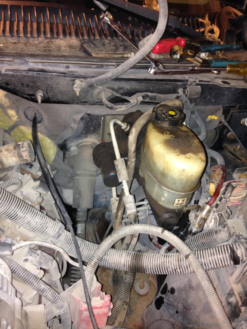

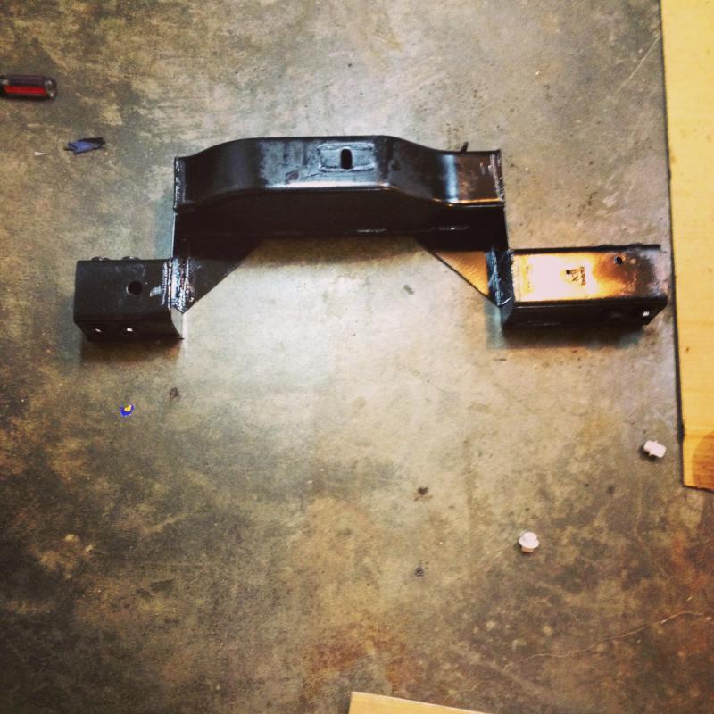

Got a few things done, engine is in, and hydro boost is installed..
It's a slow process right now..
For anyone wondering I cut pieces of 14 ga metal that was 9.125" long to move my Trans crossmember to the correct location for the 80e swap.
Anyone know what part number the rear Trans yoke is?
I remember when I did my 80E swap in my 03 longbed that I didn't need a new driveshaft, I just got a different yoke.. But if took me a little bit to find the correct yoke!
