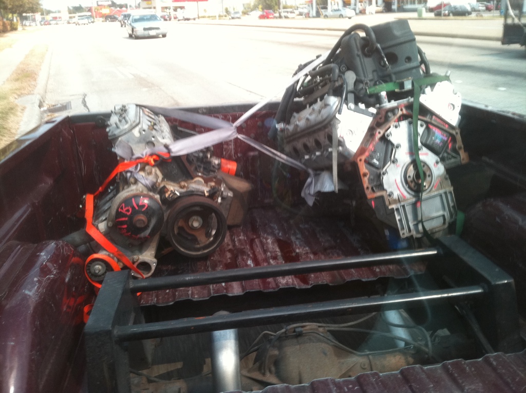

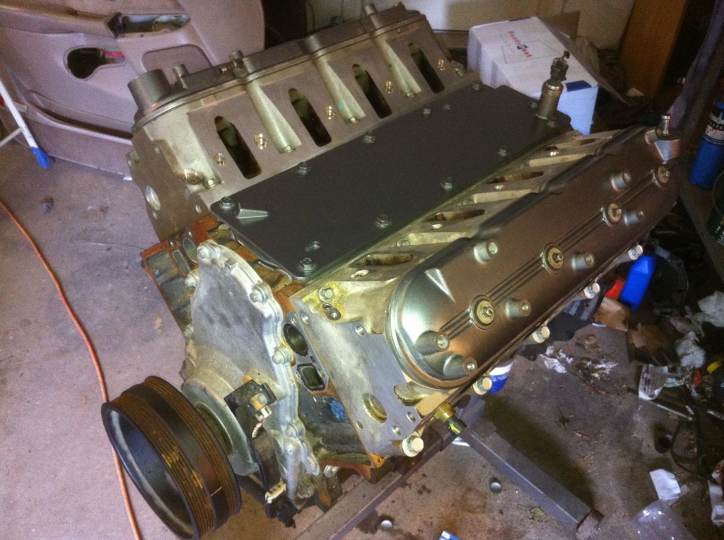

Well, went to return the 4.8 to get another, or a 5.3, ended up swapping the 4.8 out and buying the old one back for 200 as a core with a couple bent valves on the 243s, LOL. So, a 2009 4.8 is going in.

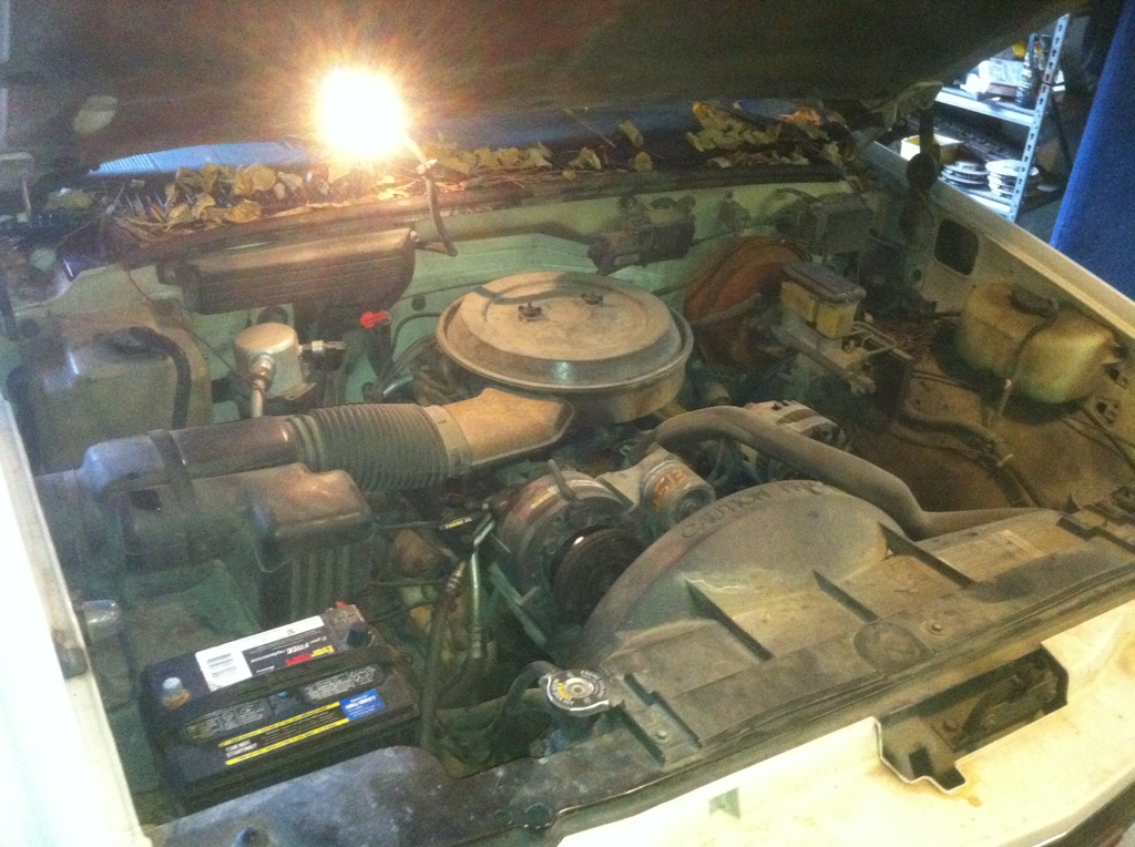

So it begins, started taking the old TBI 350 apart, still need to take the DS out and then remove the motor and trans and prep for the new setup to go in.

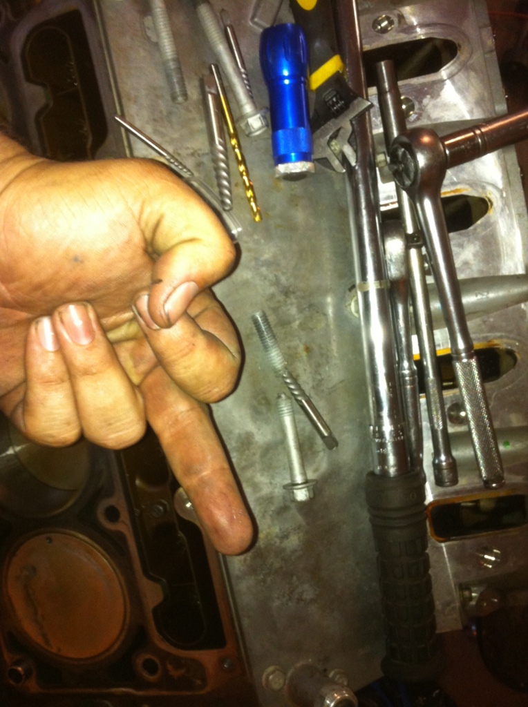

Well, nightmare of the day, GM OE bolt broke off while attempting to install(yes, they are brand new):

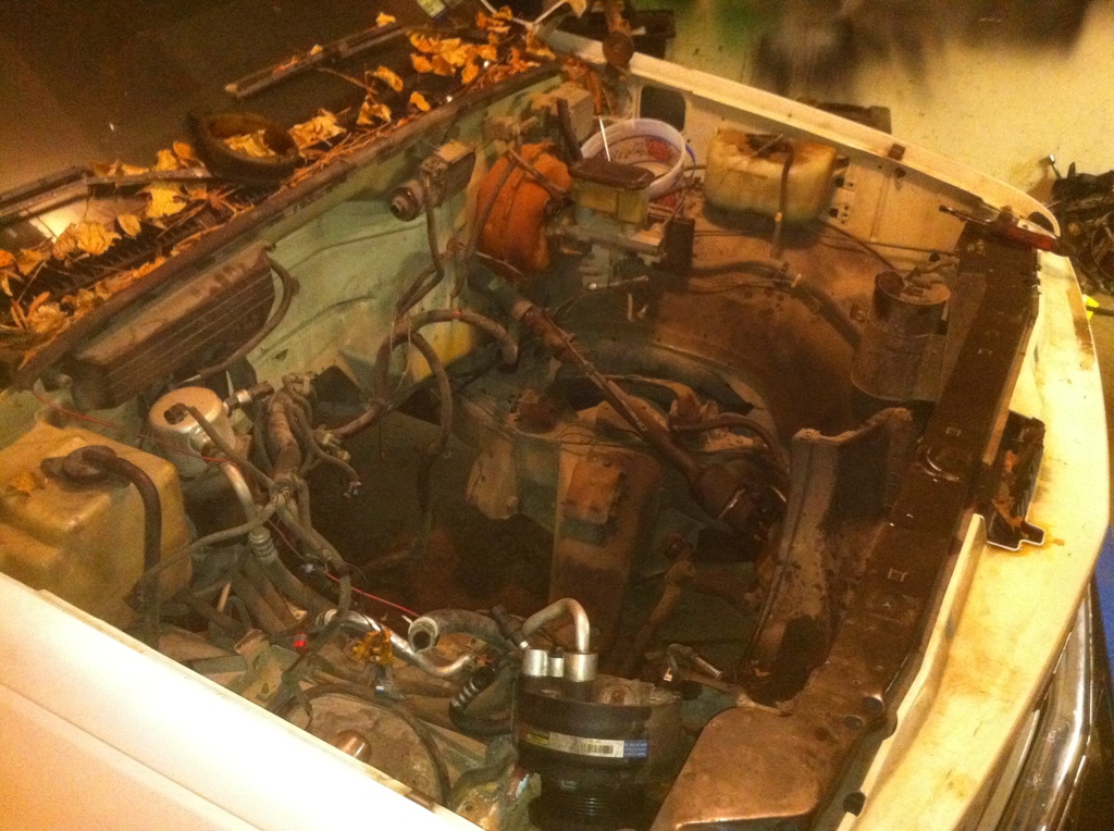

TBI motor is out:
