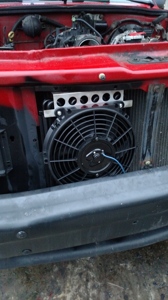

The trans cooler plumbing and mounting is all done. 1/2 lines flowing to a dual row dereale fan cooler with a thermostatic switch. I just need to finish wiring it.

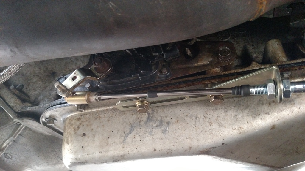

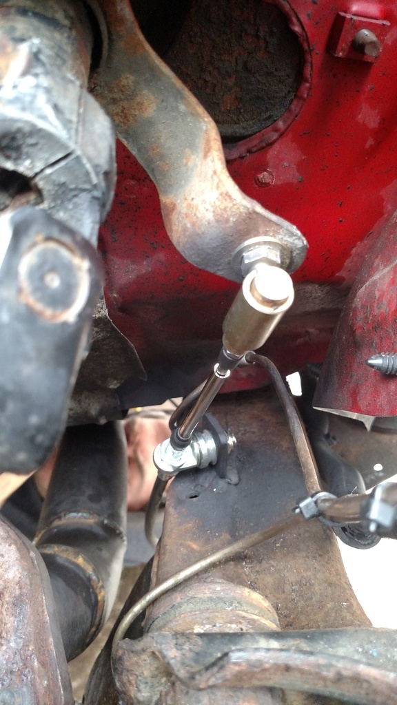

Got the exhaust 90% done today. Only need to finish a tailpipe. Also have the cable for the trans shifter done completely, very happy with how that turned out. The cable setup is very rigid and it gives a good feel of the detents in the 4l80.
Column side, with "forgot to turn the gas on" weld boogers

Trans side.

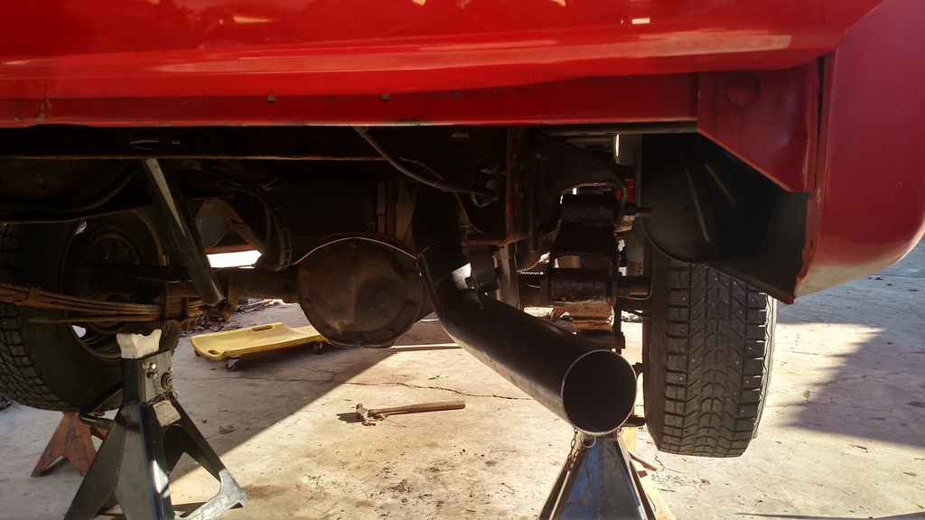

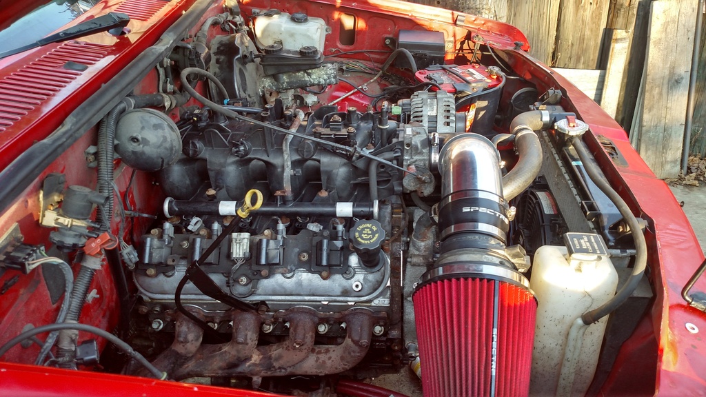

Got a good amount done today. Bought a cheepo intake kit from advanced, got that checked off the list. The exhaust is finally done, not pretty, but it will get me by untill I get a nice set of headers and a fuel cell so that I can run true duals. The cooling system is done, had enough spare hoses laying around to make something work. The bleeder from the heads is routed into the upper radiator hose. I had to heat and bend the stock transmission dipstick tube pretty seriously to get it to work in the truck, but it came out OK. Also modified the stock cable throttle bracket to work with the Koda cable, it pulls off the normal cruise control pivot on the T/B
Main things on the list now are the fuel system, rethinking my transmission cooler lines, routing all the vaccume hoses, wiring the trans cooler and some other small bits. It looks like I'll be doing OK to get the truck done tomorrow besides having the EFI harness.

215/65/15 snow tires and a 3.5 inch tailpipe do not look like they belong together.
