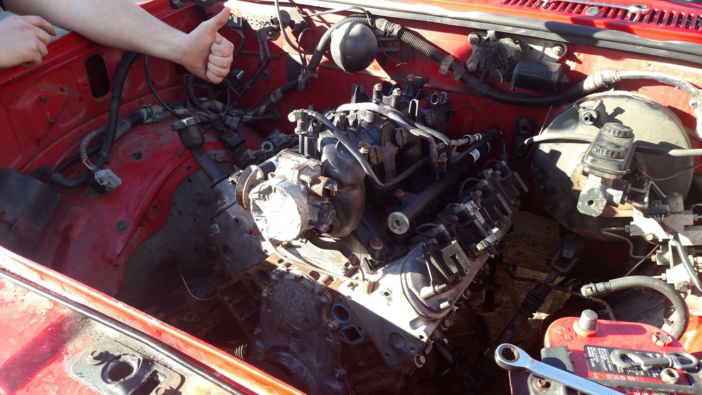

Today was the first day I have actually worked on the swap, got the 2.5 and trans out, swapped in some v6/v8 Dakota engine mounts(frame side) and bolted on some engine adaptor plates I made. Slapped the engine and trans in as a unit and it fit well, marked the plates and bolted the rubber mounts to them and the engine is mounted, I'll be making a trans crossmeber tomorrow and starting on the smaller stuff like exhaust, cooling, transmission linkage and fuel supply. I've got the week off from work so I hope to get it all wrapped up by next Sunday. I have my stock GM harness out at lt1 swaps getting simplified for a 3 wire hookup, should have that by next Friday (I hope!)

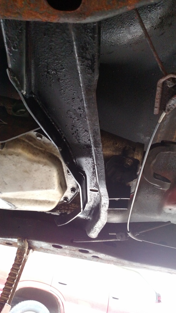

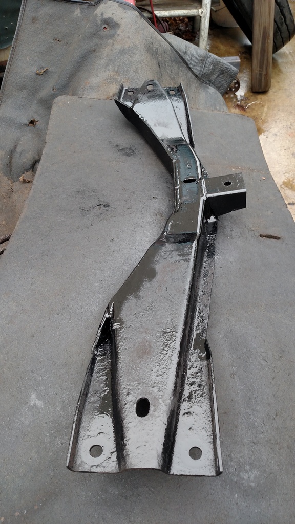

Cut the stock trans crossmember apart today and hacked it a bit to get it to work with the longer 4l80. Not my best work but its light and it gets the job done. I have a driveshaft measument now so I'll.get that made tomorrow. Got the power steering hooked up to the stock Dakota rack, looks like I only need to plug the hydroboost return on the stock Chevy pump.

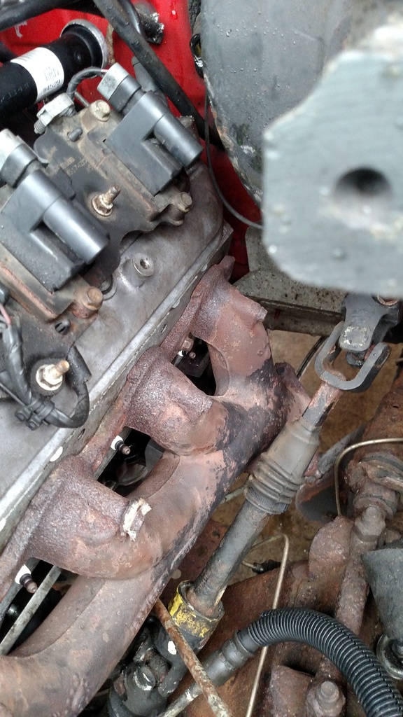

The exhaust looks like its going to be zero fun because there is very limited clearance on the passenger side and both manifolds spit the downpipes into the frame more or less.
Anyways, pictures. Sorry for the crappy snapchat pics.

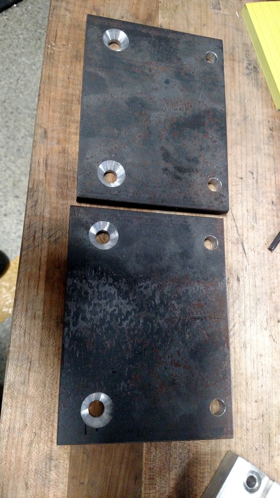

The engine adaptor plates, not drilled yet in this pic.

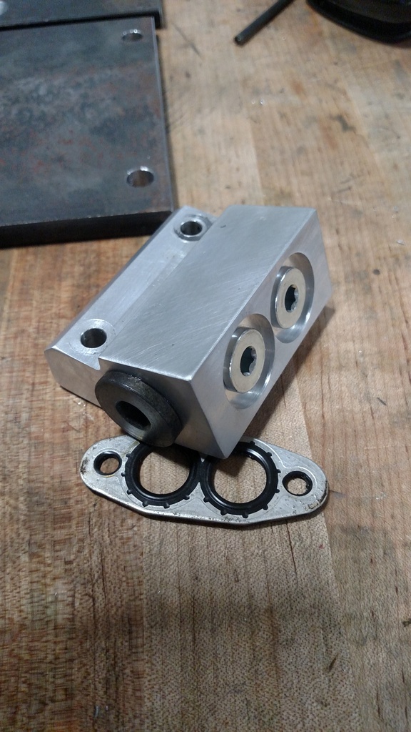

Oil line block that I cut the lines off, removed the relief and plugged with ORB-6 plugs.Name:  IMG_20151224_114847062_zpsxrbqmofx.jpg

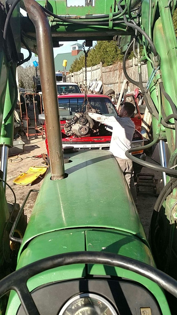

The engine sitting in the Name:  IMG_20151226_131301732_zpsa2lzcv9y.jpg

CrossmemberName:  IMG_20151227_131739375_zpsjljsapiu.jpg

Lots of room on the drivers side, besides the steering column.
Not so much on the passenger side

man my s10 had less room then that. I would try stainless works 1 7/8 long tubes. here are some pics of my motor when I was mocking the headers up and this headers are made for the 4l80e trans.

Those are the first long tubes in anything close to a 2 inch primary that I have see that look even close to working. I'll try a set of those, thanks.
