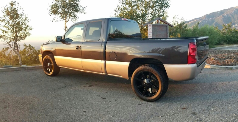

Finally stepped in to the LS world. Picked up this 03 silverado 1500 last week for $5000. It has 209,000 miles but overall is in good shape. Driver seat had a tear but previous owner sewed it up. Other than that, the interior is spotless.
Also, it needs a good cut and buff since someone inexperienced decided to buff it.

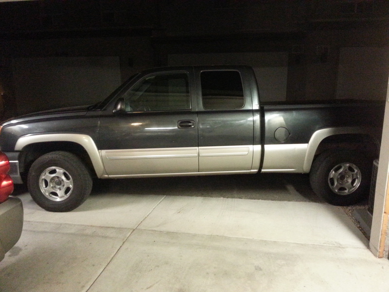

Here it was in stock form.

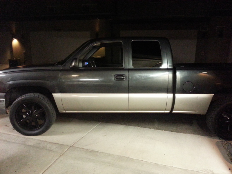

On my drive home, I stopped at Napa and picked up all new rotors and pads for it and switched them out. Also bled the brakes and flushed the power steering.
The next morning I went and got wheels and tires, 20" KMC slides with 285/50/20 tires. Removed all the door trim, bed rails and fender flares.

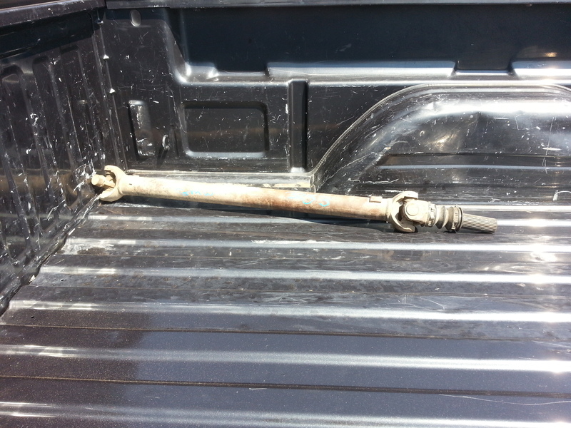

Looks as if the stock front drive shaft from a duramax powered truck is a direct swap, so I called the local wrecking yard and picked one up for $50. Once I get the swap finished, I'll measure for the new rear shaft and have one built locally.
