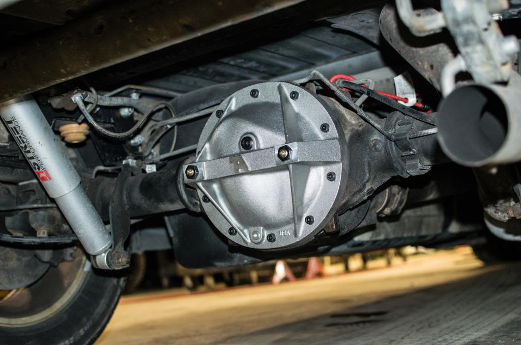

Rear end mmmmm....

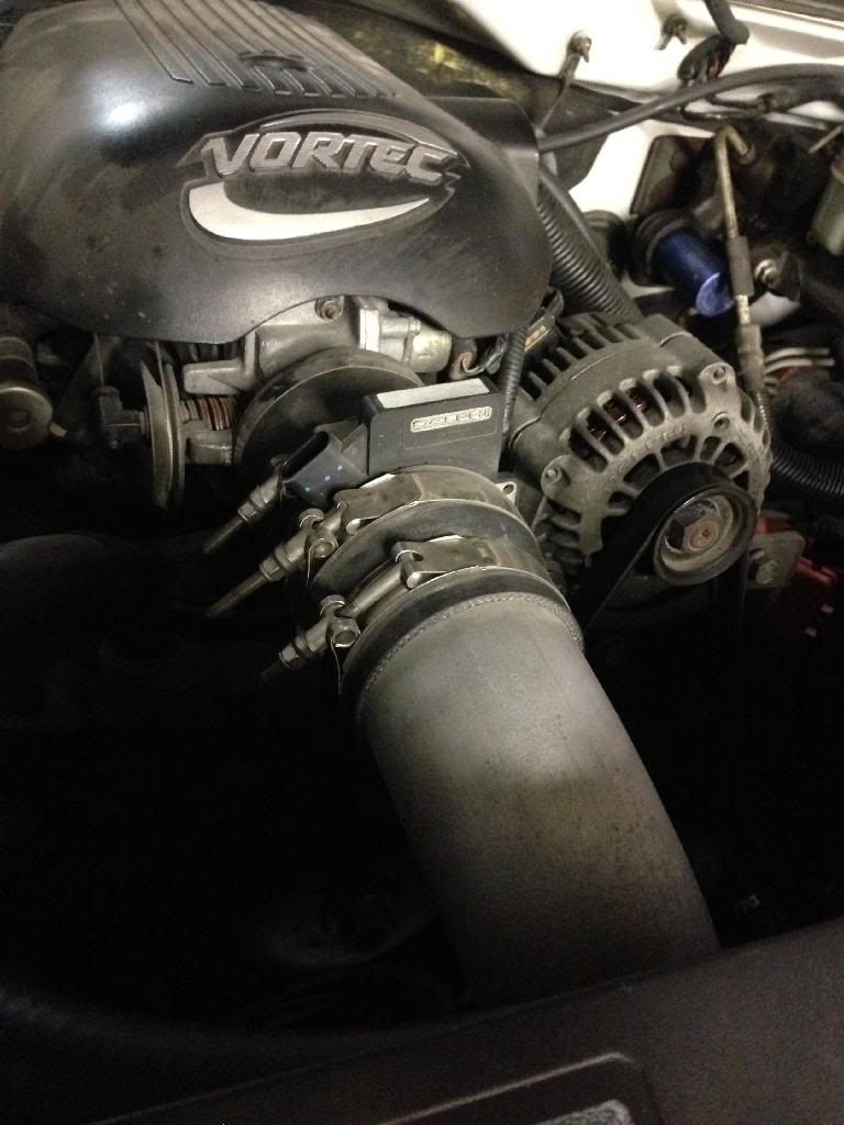

MAF delete

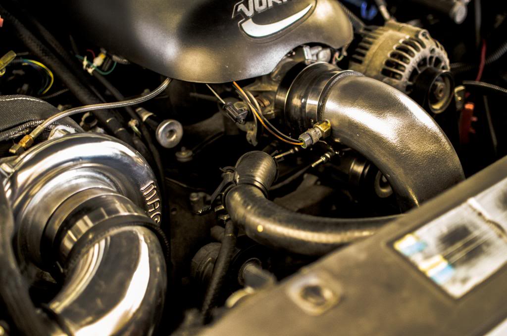

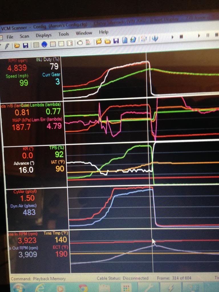

Well its been a while since I've update my build. Dont worry not much has changed. No I still haven't swapped in the 80e yet
last night i had some free time so i cranked up the boost controller and did some logging. Got the truck tuned up to 9psi and it felt like a whole new truck.
fast forward to today, made a 10 hr round trip to pick up a L33 and 799 heads.
got back home and i got the bug to turn up the boost a little more. few more clicks on the boost controller and its at 11-12 psi.
and now the 60e is begging for mercy 2nd gear is gone but it 3rd is still doing great!

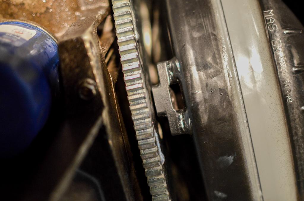

Coverter pad spacing was about .075-.090 thou

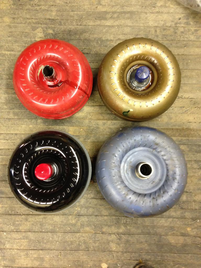

Got Torque Converters?

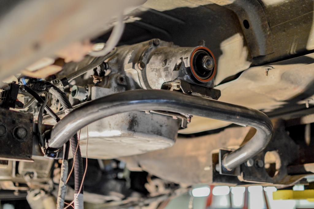

Things to do...
add the ISS sensor
swap the yoke on the driveshaft
looks like ill have to trim on the right side of the trans for the exhaust cross over to fit.
