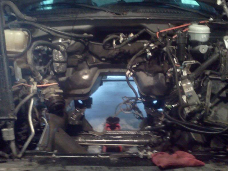

Here is where I am at today, got the engine out and some kitty litter soaking up the mess I made. I put a rag and bag over the end of trans, but it developed a small leak that put trans fluid all over.
