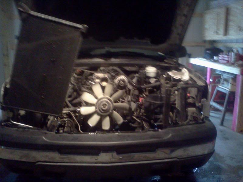

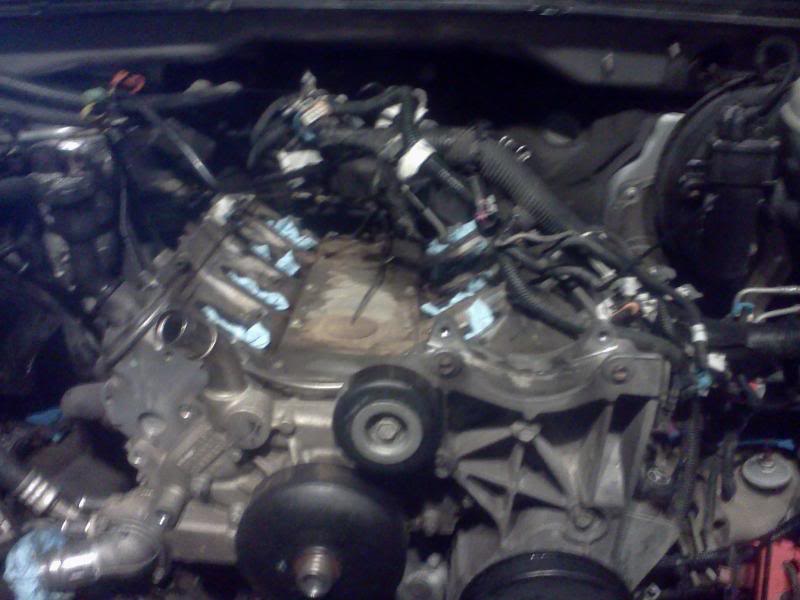

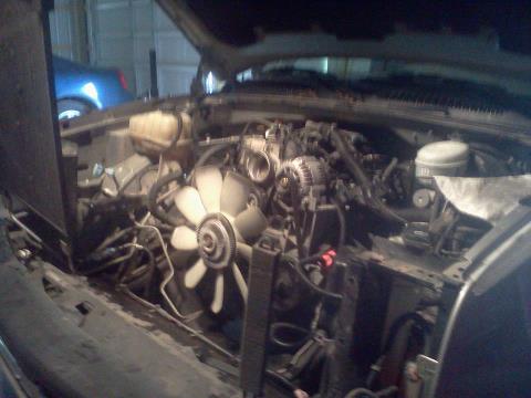

Got the engine stripped down, cleaned the grime off of it. Started pulling stuff off the truck. I had to find all my tools first, just built this garage and broke the new concrete floor in good with some new stains. Fighting with the fan at the end of the day, even leaving the belt on its not budging.
