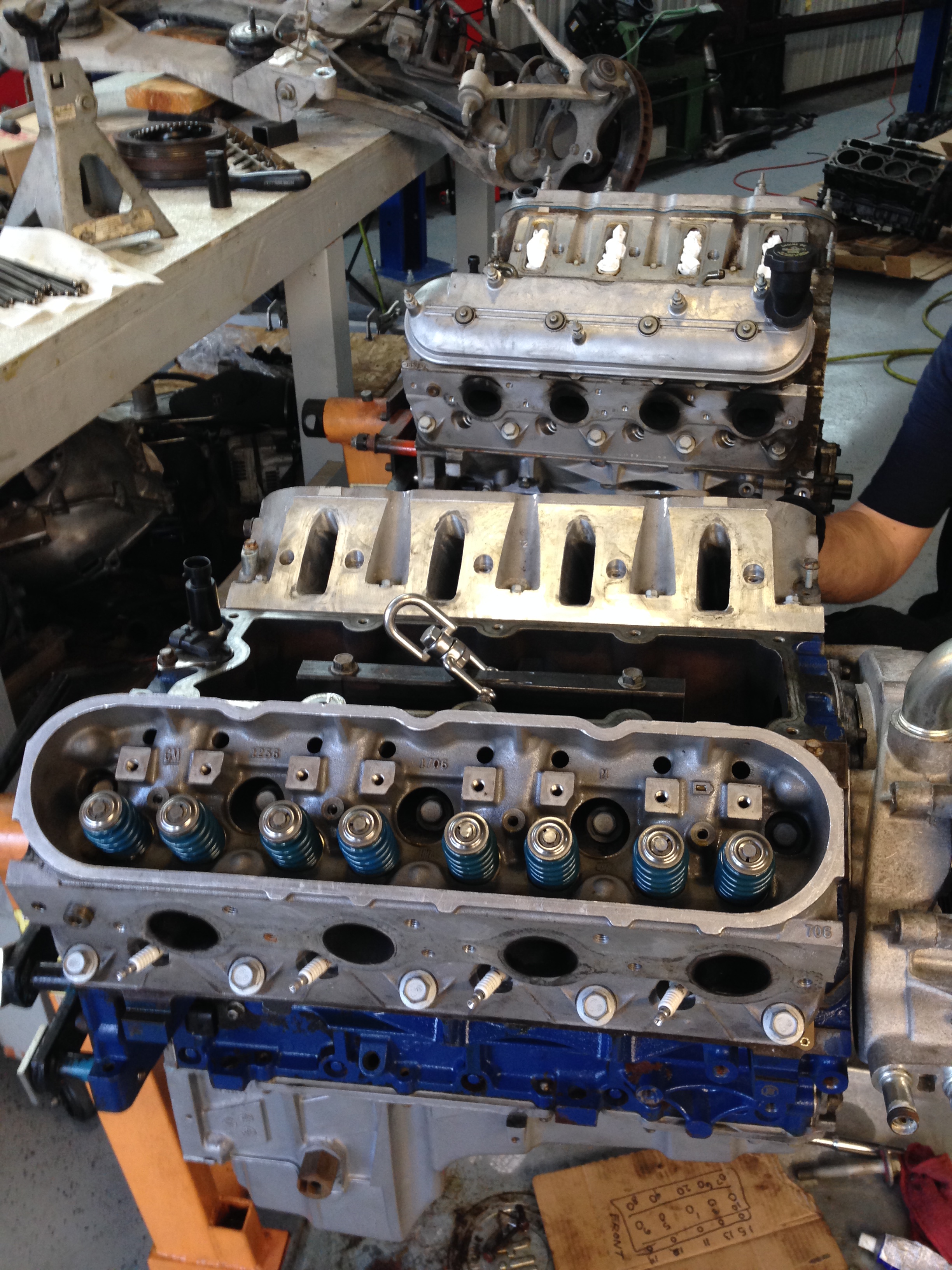

Thought I'd post a small update...
The original 5.3 that was swapped in had massive blow-by and was swapped for another hi mileage shortblock with a LS1 camshaft from my dad's C5, LS1/LS6 MLS head gaskets, and ARP bolts.
This setup made 276whp with a slipping 4l60e. There was more left in it, but I was fighting a exhaust leak that was throwing my widebands off.

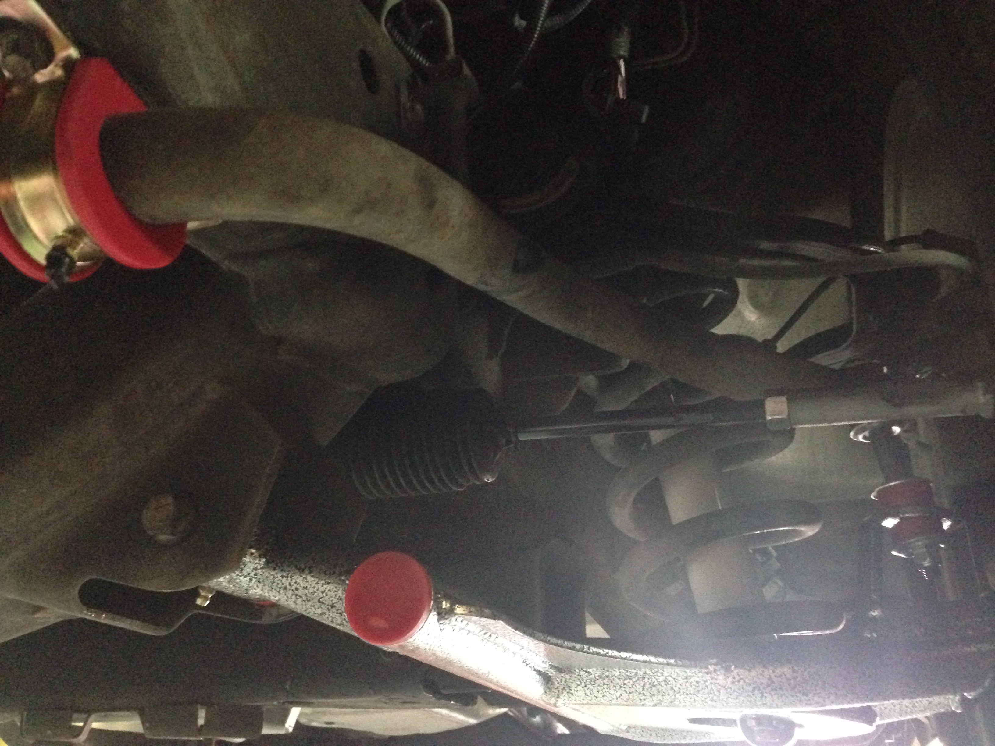

A little update... Last week all the suspension parts came in.
-Full DJM 4/6 kit with new 4" drop lower control arms and rear flip kit.
-DJM CalMax shocks front and rear. Will get replace with something adjustable at some point.
-CalTracs
-new inner/outer tie rods
-Energy Suspension poly sway bar kit with end links. Can't say enough good about these guys... were too good to me during my Lightning build for The Texas Mile.
Front end is completely done and wheels are back on so we could see the stance. The 31" Eagle/GMC 20" stocker combo is on it's way out and will be replaced shortly with 16x8 Cragar Soft 8's with radial fronts and 28" Hoosiers for the rear.
Rear is completely disassembled and the new solid aluminum bushings are pressed in the leaf springs (what an ordeal to get the old ones out). Front CalTrac mounts are on as well. I'm still trying to decide if I want to keep my 2" shackles and net more of a 7" drop or go back to stock height ones. Will probably do the former and see if the Hoosiers will clear first. I'm not really interested in that "Cali lean" so we will just have to see how it plays out.
One other thing to note; The truck has the Chevy lean which I compensated for with GM's state of the art 1/2" plate, but obviously that won't work now with the flip kit. I'm torn between placing it on the other side or just seeing how it sits without. Any input would be welcome.
Some awful shop shots. It was afternoonish and the Houston sun was at full strength....

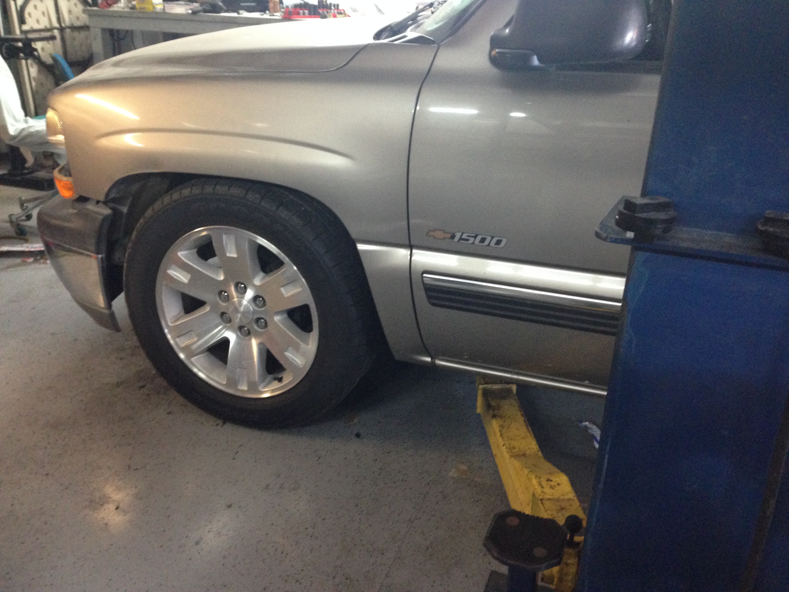

How the front sits now. I apologize for the multiple posts... if I don't caption each set of photos as a new post, and load the image as a file attachment, my "websense" blocks the image.

Old Jun 2, 2016 | 03:17 PM
treylittlefield's Avatar
Joined: Oct 2013
Posts: 224
From: Alabama
What size tire ? Truck looks good.
Old Jun 2, 2016 | 03:26 PM
slvrram's Avatar
Joined: Sep 2005
Posts: 154
From: Houston
Thank you Trey. Which tires? The ones mounted currently are factory sized GMC 20" 275/55r20. For the new set, I'm leaning towards the Hoosier 28x10 slick. Front I'm undecided yet. Something like a 235/60r16 maybe. Would work out to be a 27.1" tall tire. They will be mounted on 16x8" wheels.
