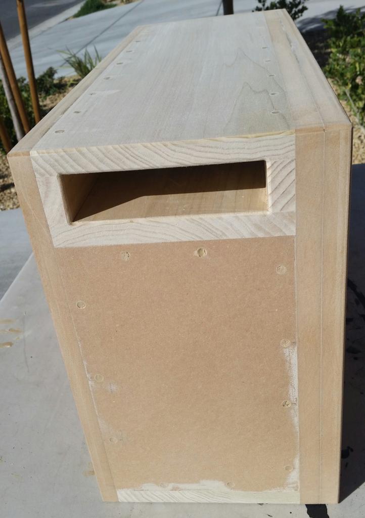

Some pics of the box.....far from perfect.....but not so bad using a circular saw and Dremel as a router, lol
9 1/4" hole
Slot port
Some of the bracing

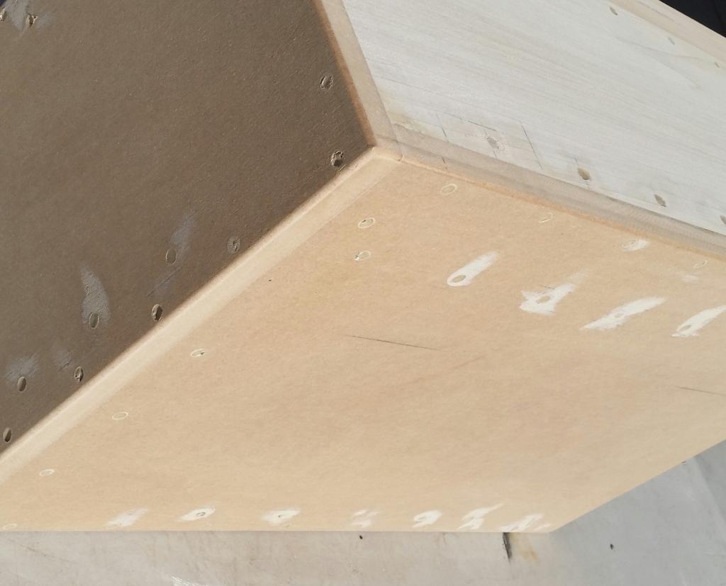

hey, that little dremel did a decent job on the edges! surprised!

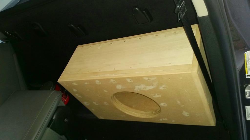

Good fit
