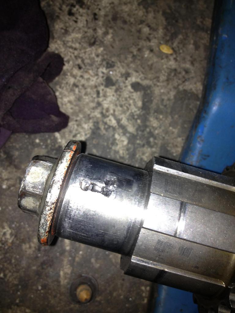

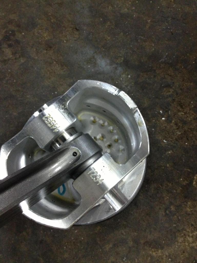

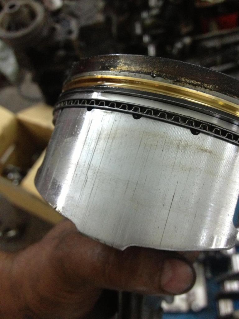

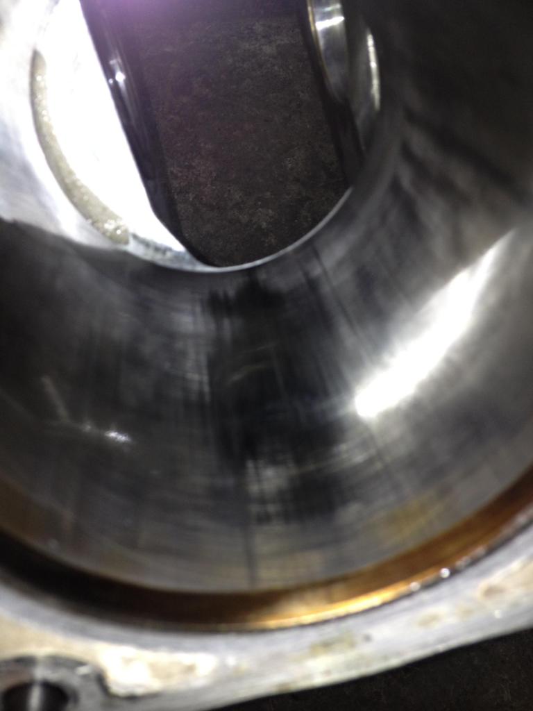

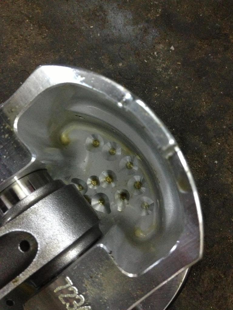

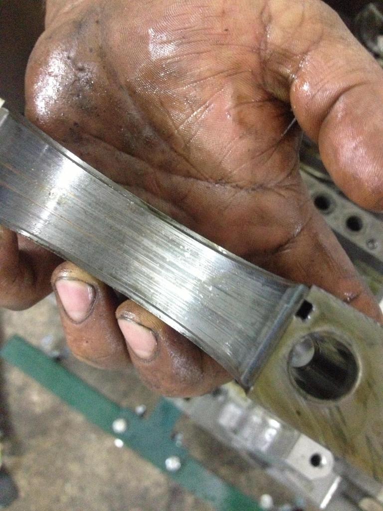

500-600 miles only
so called balancing lol
bearing to rod journal and bearing to rod clearances were stock.. with aftermarket bearings.. he did not machine anything at all just the block.. he screwed that too.. 6 thou piston to wall clearance.. lets hope this doesn't happen again
