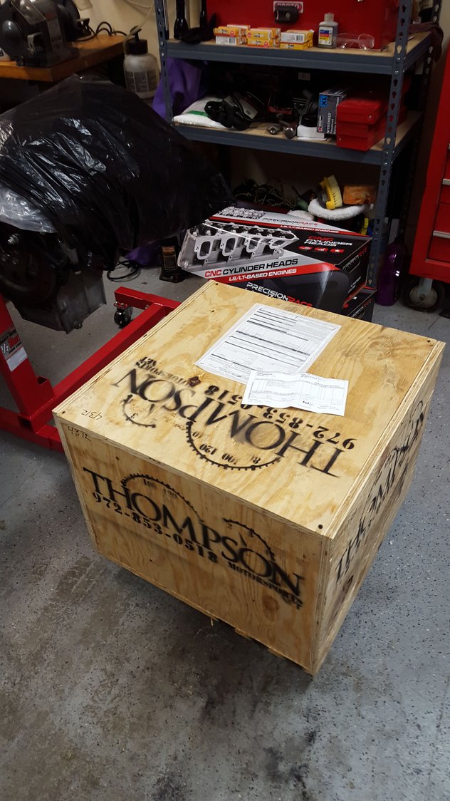

Actually got the engine Friday after some issues with fedex having the wrong phone number.
I got it uncrated and on the stand next.
I am pretty happy about the new engine. Seems like they paid very good attention to detail. Came already with the cam gear and all the block plugs installed.
