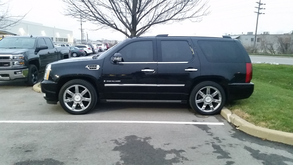

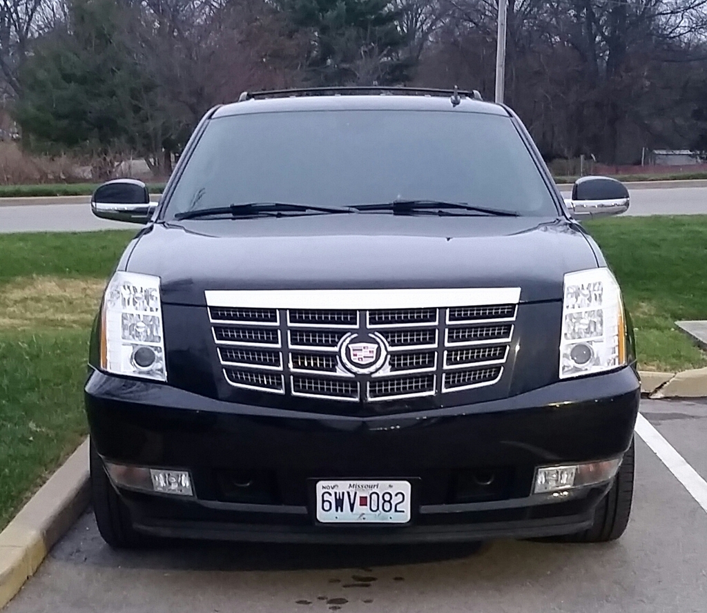

I picked up a 2007 Escalade back in October 2015. I am working on making it the way that it should have been offered from the factory. 6.2 with a 6L80 is already a pretty strong running setup in these trucks, but they need more...

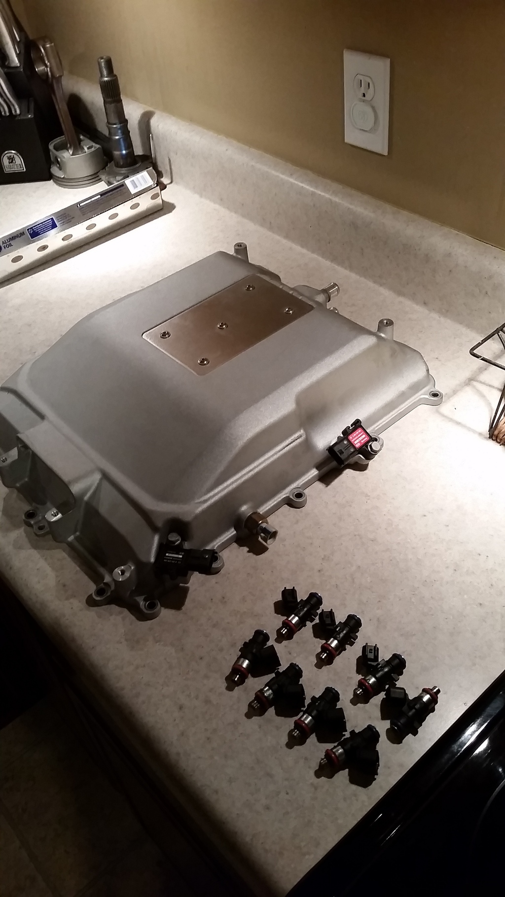

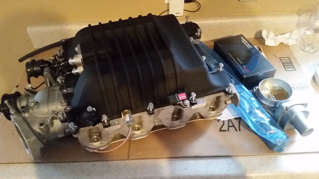

LSA blower

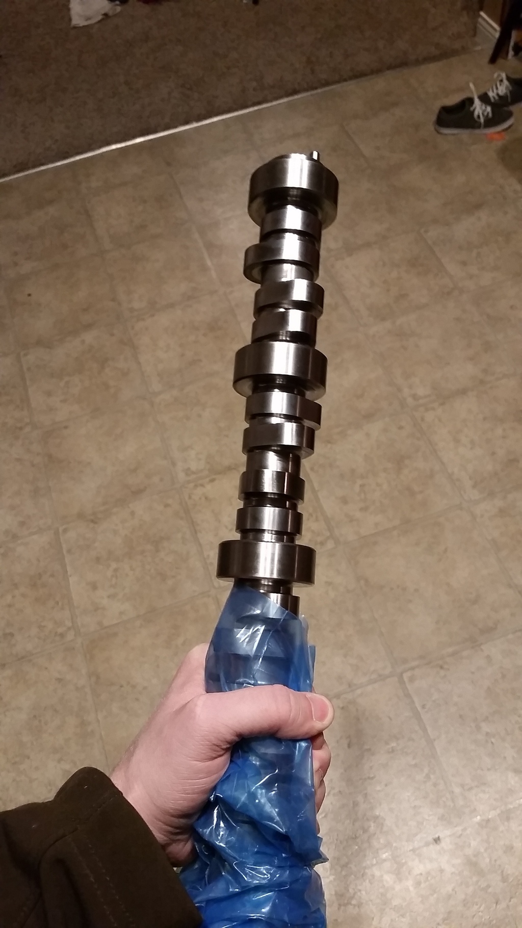

LS9 Cam
LS9 Valve Springs
ZL1 blower lid
CTS-V fuel injectors
ZR1 fuel rails
CTS-V heat exchanger
CTS-V heat exchanger pump
LS7 Throttle Body
LS7 MAF

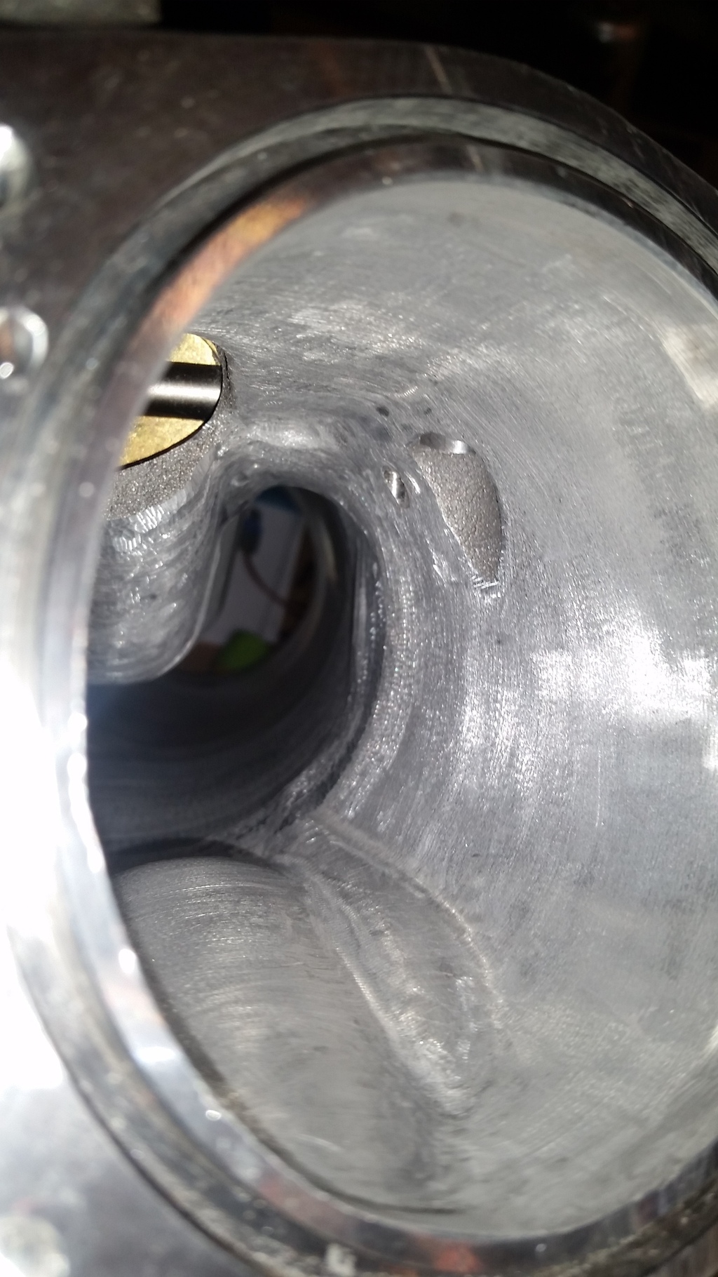

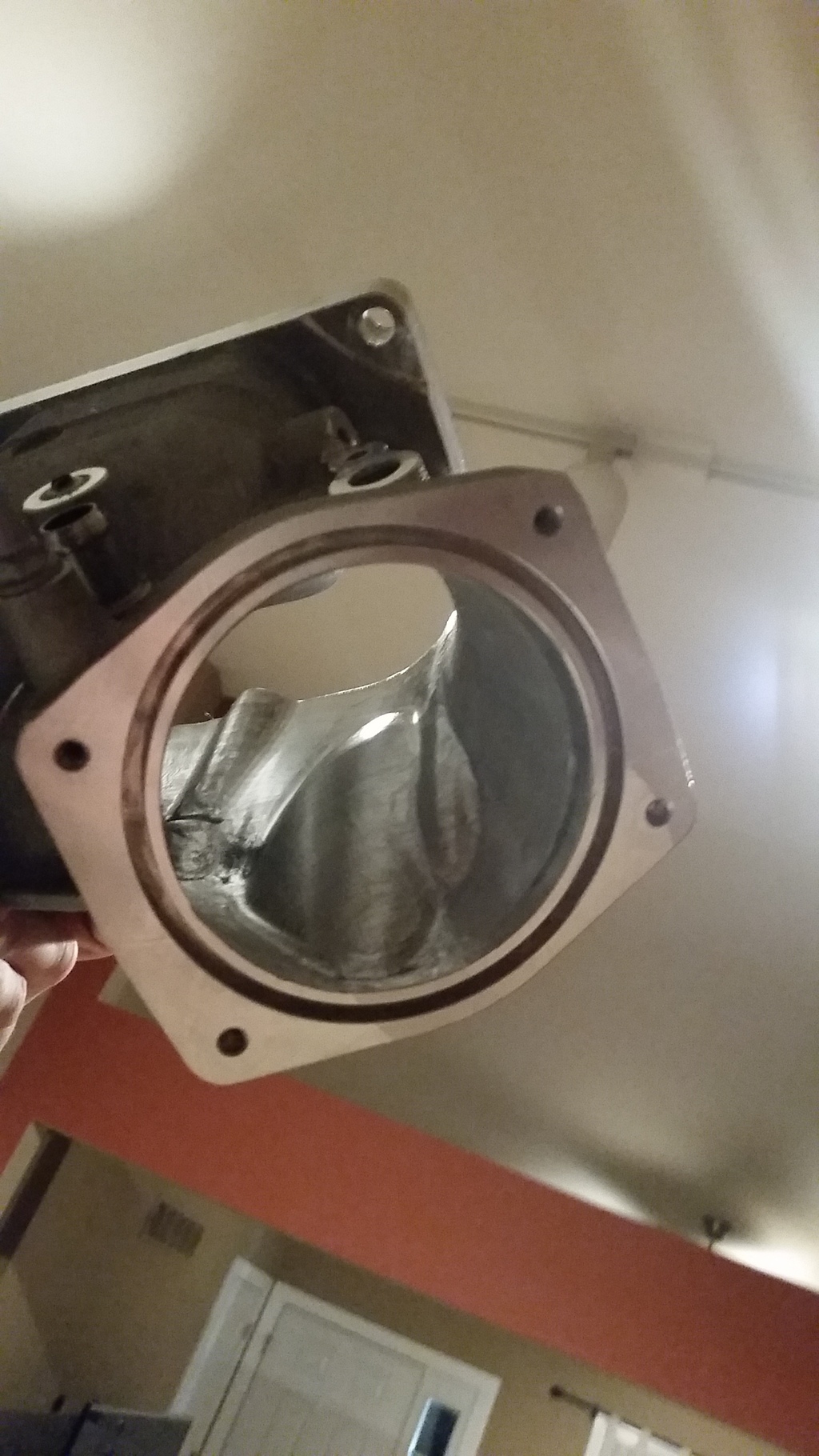

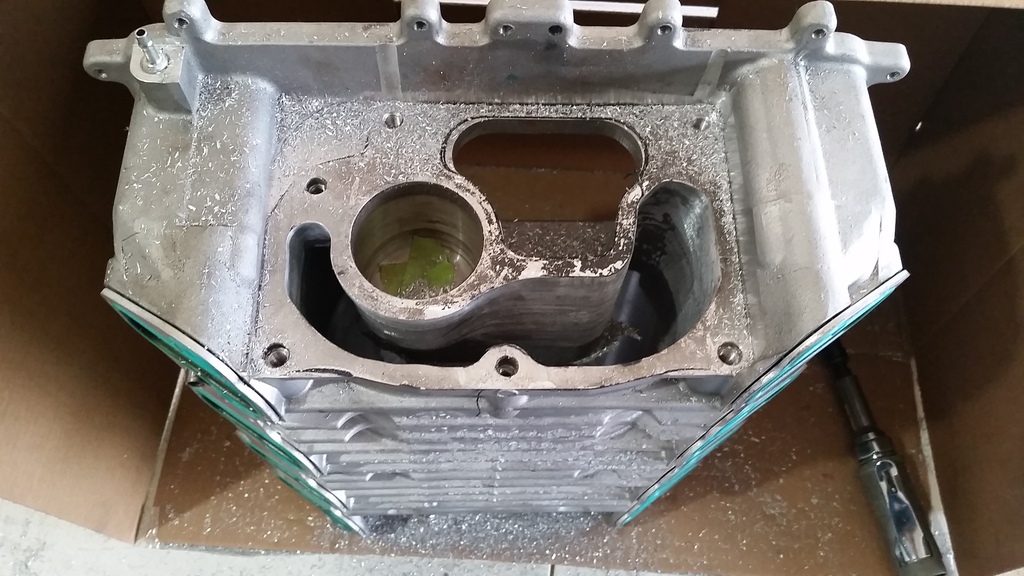

Ported blower snout/matched to case
Edelbrock Fuel Pump (since mine isn't Flex Fuel)
LSSimple Accessory Drive (to get the LSA to work with the stock truck accessories)
Pinned Crank
Custom 4" Cold Air Intake

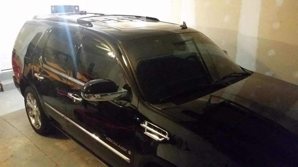

20% window tint, 35% windshield tint
2" drop spindles, 3" Eibach lowering springs
ETC....
I'm going to run the stock 2.95" pulley with the stock truck balancer...so 6.5psi.
I am still gathering parts, but I hope to have it together and running sometime in the Spring. With the 10.5:1 compression of the L92, that should be enough to get started.

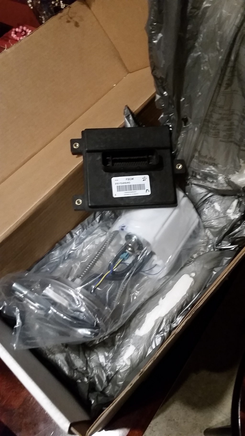

OK....so my Escalade doesn't have a FPCM. Apparently that wasn't implemented until late 07-08. My build date is 12/06....and it's not there. WTF.

Fuel pump control module
