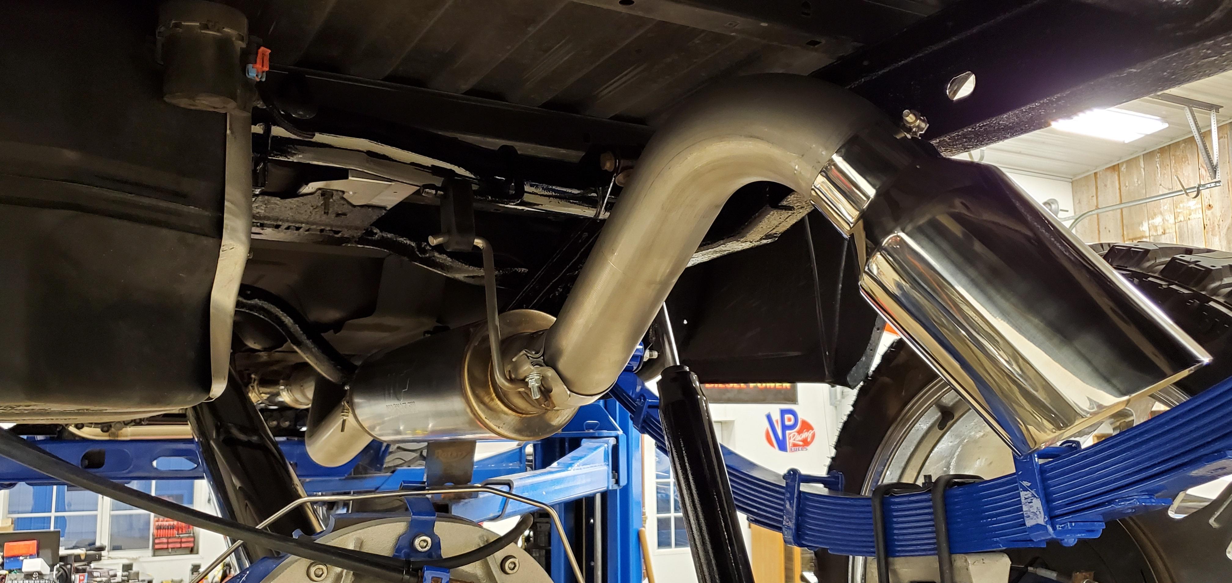

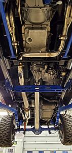

Time for exhaust and driveshafts. I did a LOT of research on what exhaust I wanted to run on this truck. I have always been a huge fan of Magnaflow because when done right they aren't super raspy and they don't drone much either while still giving you a great sound. I had bought Speed Engineering 1 7/8 longtubes with 3" collectors and the y-pipe that goes with them, but I didn't want to run the standard dual 3" into single 3" Y with a full 3" exhaust. I was wanting a 3.5" or 4" single exhaust, and in hindsight I am sure I could have saved some money if I would have bought individual bends, but I found a 4" stainless downpipe back kit for a 99-06 Duramax and figured that I could hack that up and use the bends that are already there to make things much easier.
With the help of my good friend (the one who has helped with all the fab and welding on the truck up to this point) we started with the y-pipe. I chose to use v-bands on all the connections, and to weld all the other pipes with our welder we set up to do stainless stuff instead of using clamps. I got a hold of a 3-4" flared reducer and cut the 3" end of the Y down as much as possible. Since the Y has sort of a flare down to the single 3" exit, when cut way back, it opened up closer to 3 1/4-3 1/2". Cut the reducer to fit and welded it all up so I had a dual 3"-4" Y with v-bands on all connections. We test fit it to the headers, welded the other ends of the v-bands on the collectors (we had to shorten the collectors a bit to get it to fit right) and I was very pleased with the result.
The rest of the exhaust was laid out with all 4" pipe, a Vibrant 18" resonator as close to the Y as it would comfortably fit, a Magnaflow #12772 4"x24" - 7" round muffler, and a 6" exhaust tip dumped over the axle. I was extremely happy with how this all turned out. It looks great, sounds nice and aggressive without eardrum bursting drone or any wild rasp. Super pumped. Driveshafts showed up about the same time as well, I had ordered custom length shafts from Driveshaft Specialist of Texas. Rear is a 5" aluminum with 1350 joints with the conversion yoke for the 10 bolt rear. Front is a custom length Auto Trac shaft with CV joint since the truck is lifted 9" and I hated how much noise/vibration I had in 4wd with the stock shaft. There was a mix up with the front shaft u-joint size when the shafts showed up so I had to send it back to be corrected and the guys down there were super helpful and apologetic. I think it was less than a week and a half including shipping times for them to turn the front shaft back around and get it to me. I was very pleased and am very happy with the way they fit. Rear shaft got polished my me.

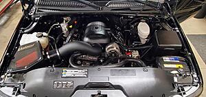

Here are a couple engine bay shots. Its not the cleanest engine bay or really anything special. Looks pretty basic, nothing fancy but cleaned up a bit.

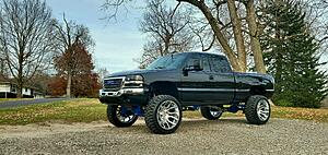

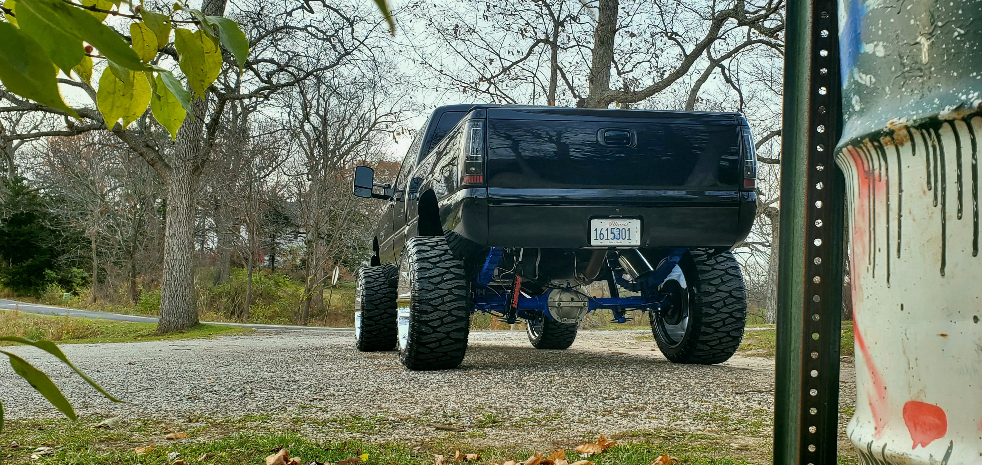

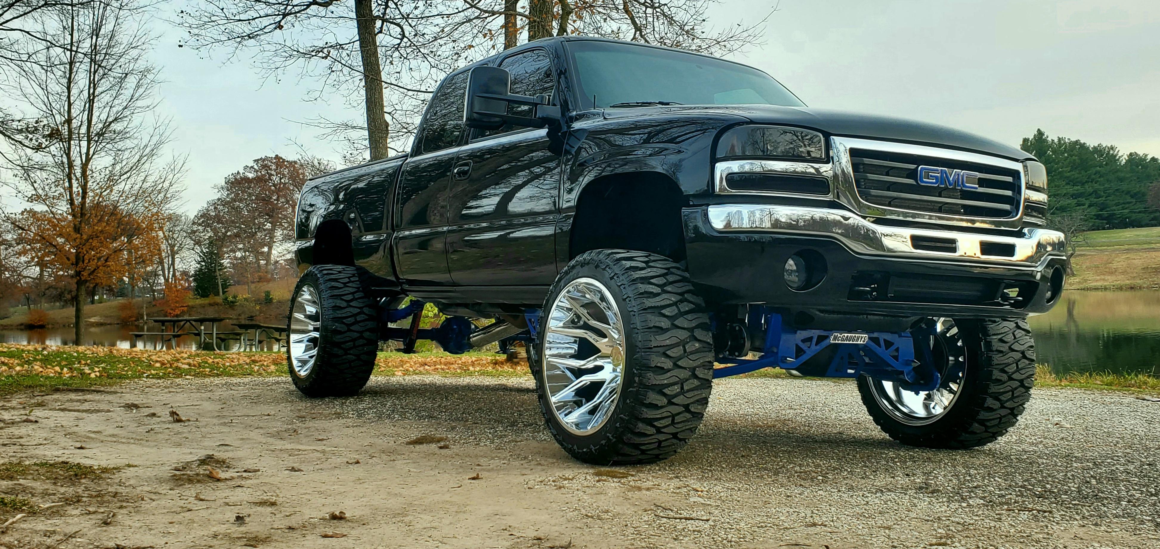

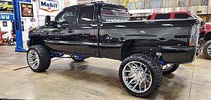

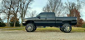

And here are a few completed shots of the truck after a fresh detail. Also this is the best summary of a "build list" I could come up with.

So after getting to drive it and enjoy it some this summer/fall, I really think it needs more gear. Probably 4.88s, but I am seriously considering 5.13s too. Maybe that's a bit too much?
Otherwise, I am supper happy with how everything turned out. The engine runs good. Pulls strong out to 6200rpm which is where we have it shifting right now. Trans shifts quick and firm, I really like it. The only downside to the 4l80 is that tall first gear. But with 4.88s that will be less of an issue.
Yeah that 1st gear a baaaad on the 4L80
a blower will help you get through it nicely tho!
def agree on gears, when I did the math on a 4L80 swap I would need 5.13s to get nearly the same effective ratio in 1st with 35s, compared to the 60e/4.10/33 combo. And even then, I don't feel like my truck ever had enough gear
totally different build path but I decided on 6L80 and 4.56 for 35s
