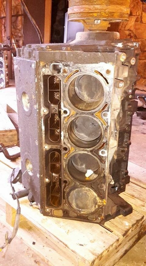

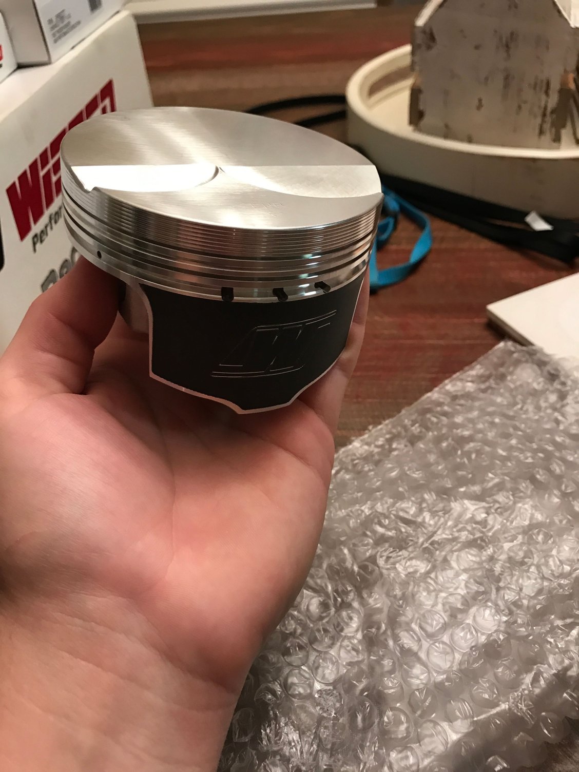

Well I decided I wanted to slowly build a nice motor on the side and swap it out and upgrade the turbo down the road and really throw the boost at this truck! So I picked up a 5.3 long block for 50 bucks! Stripped it down to get it ready for the machine shop! Going to slightly home it out to a 3.800 bore with some nice Wiseco boost pistons LJMS style, and some nice Callie compstar rods!

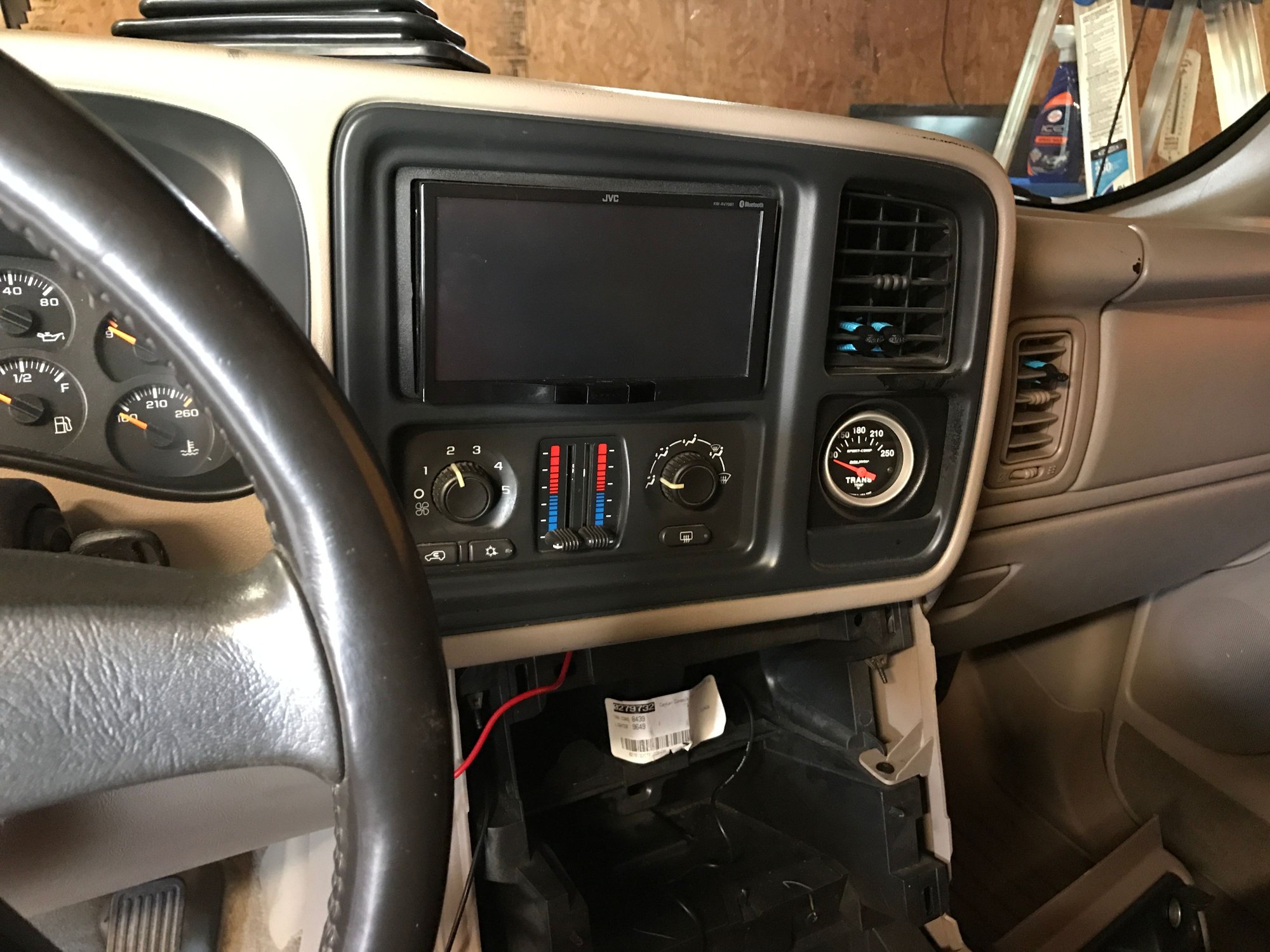

The shifter looks right at home. Did you have any alignment issues using the djm lca?

Do you have more pictures of the shifter install with the console?

i have the same shifter that console made it look clean ..
yes ended up having to get the Djm uppers to get it in spec. It wasnt even close but good thing is I bought the 4/6 kit for 350 off Jc Whitney, and djm sold me the uppers for 170 since I had there kit already so they cut me a discount!

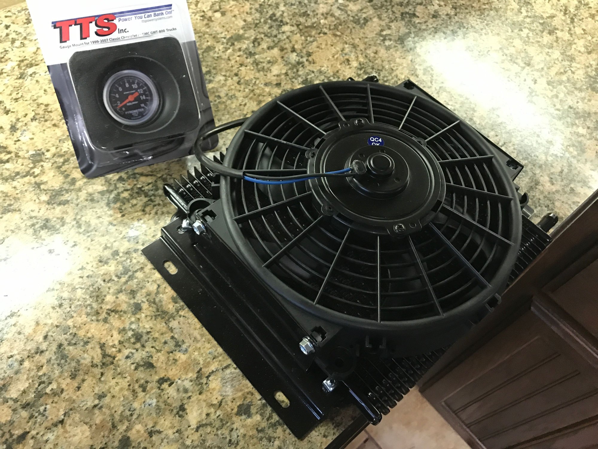

Idk about y'all but I love some new parts!!
