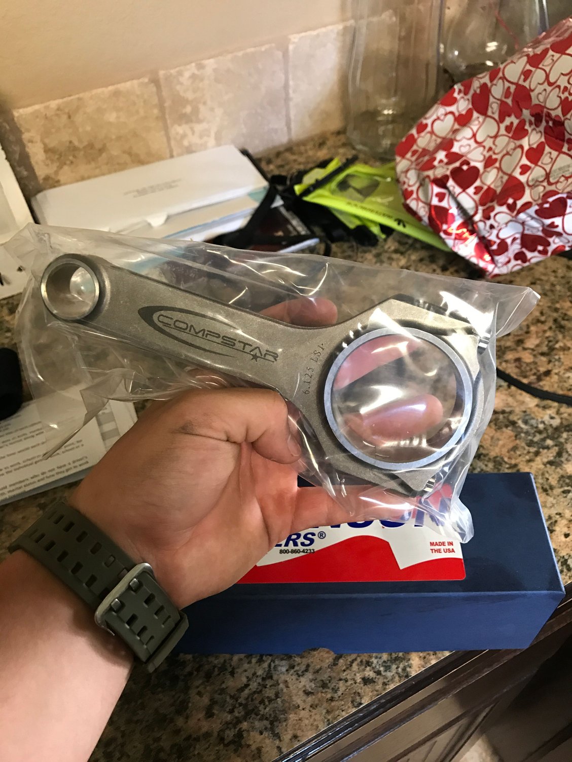

Default Few new parts!
Should have the shortblock ready to roll next week! Forged Callie's compstars, wiseco boost pistons, stock crank, btr/ljms stage 2 cam, jp billet timing set, Johnson link bar lifters, prc 2.5 ls6 heads. With new turbo billet wheel race cover 76mm with 92 turbine 1.25 AR t4 from reed at works turbo! Decided to do a nice sfi balancer too and arp studs for the mains and heads.

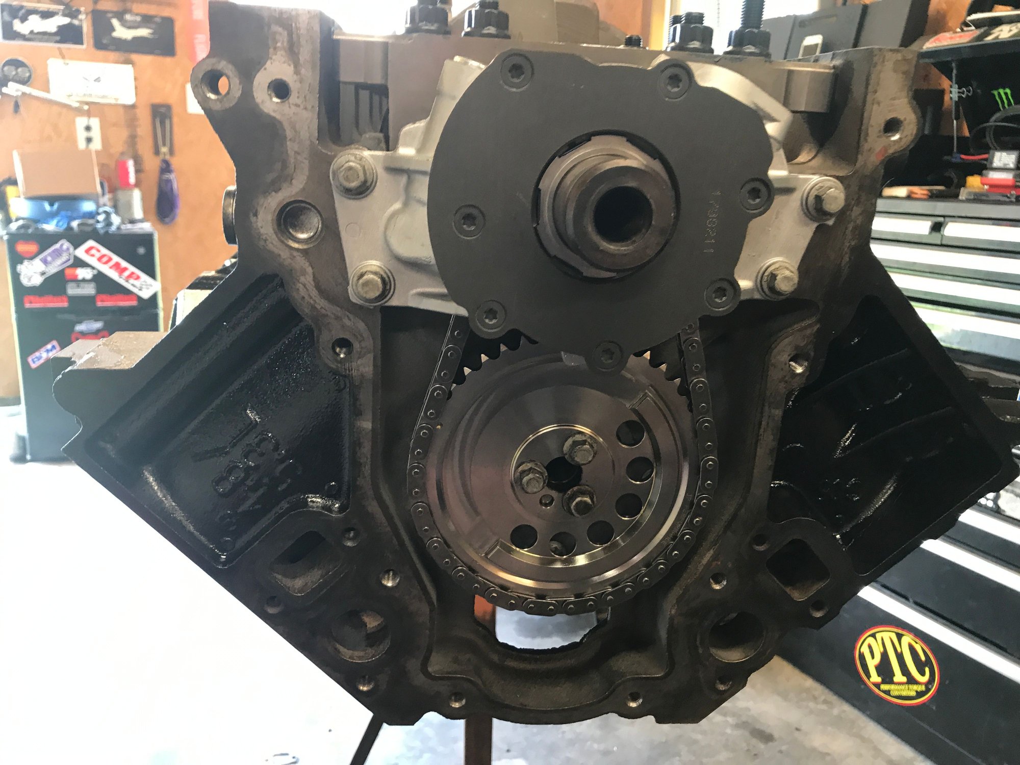

Default Motor!!
Well picked up my short block from the machine shop! And get it slapped together!!
