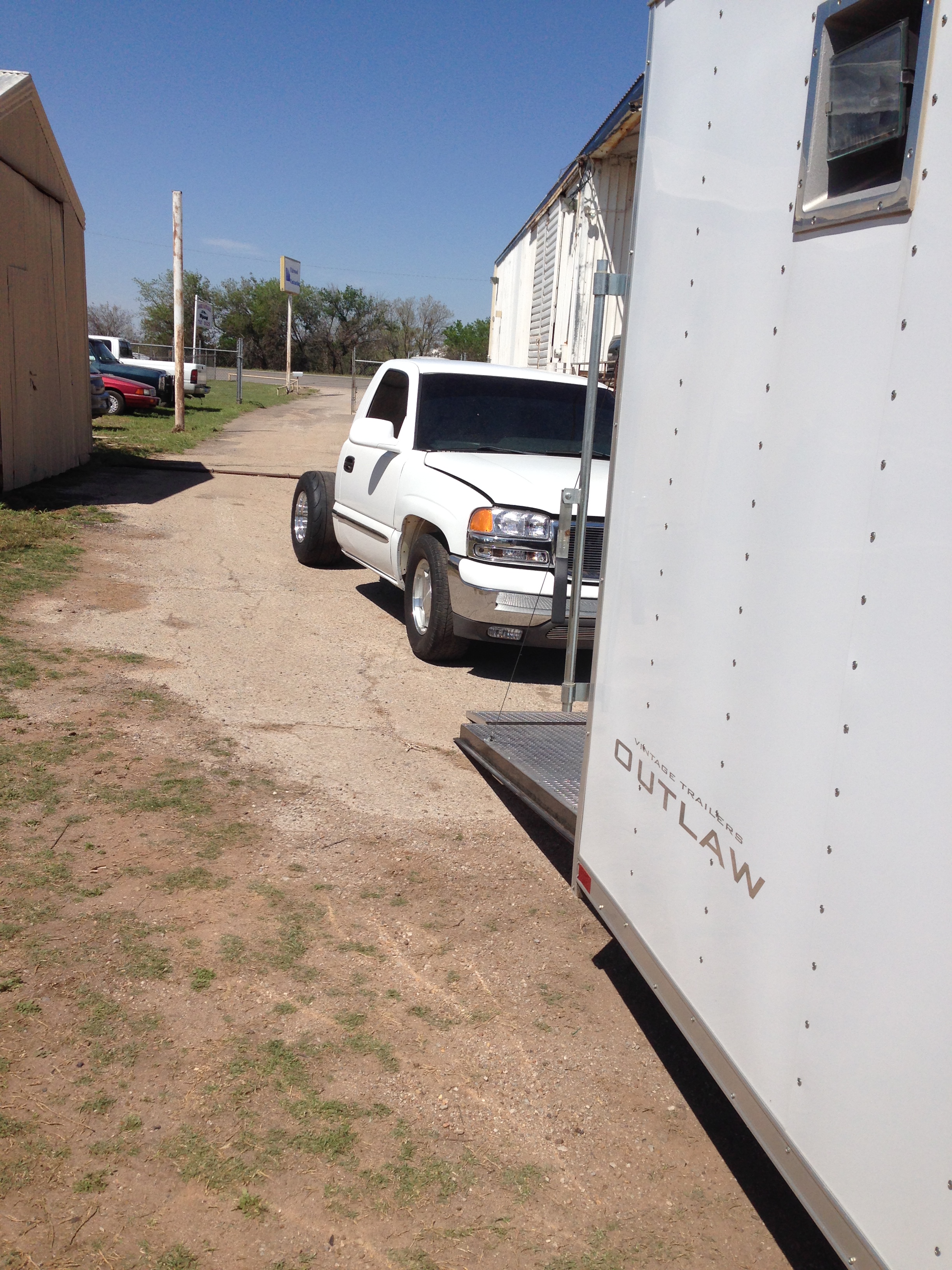

Here are some pics of the truck when I got it. I pulled the bed off right when I got it to get a roll pan welded in and the gas door, stack pockets and shave the tailgate. Also widening the factory wheel wells.

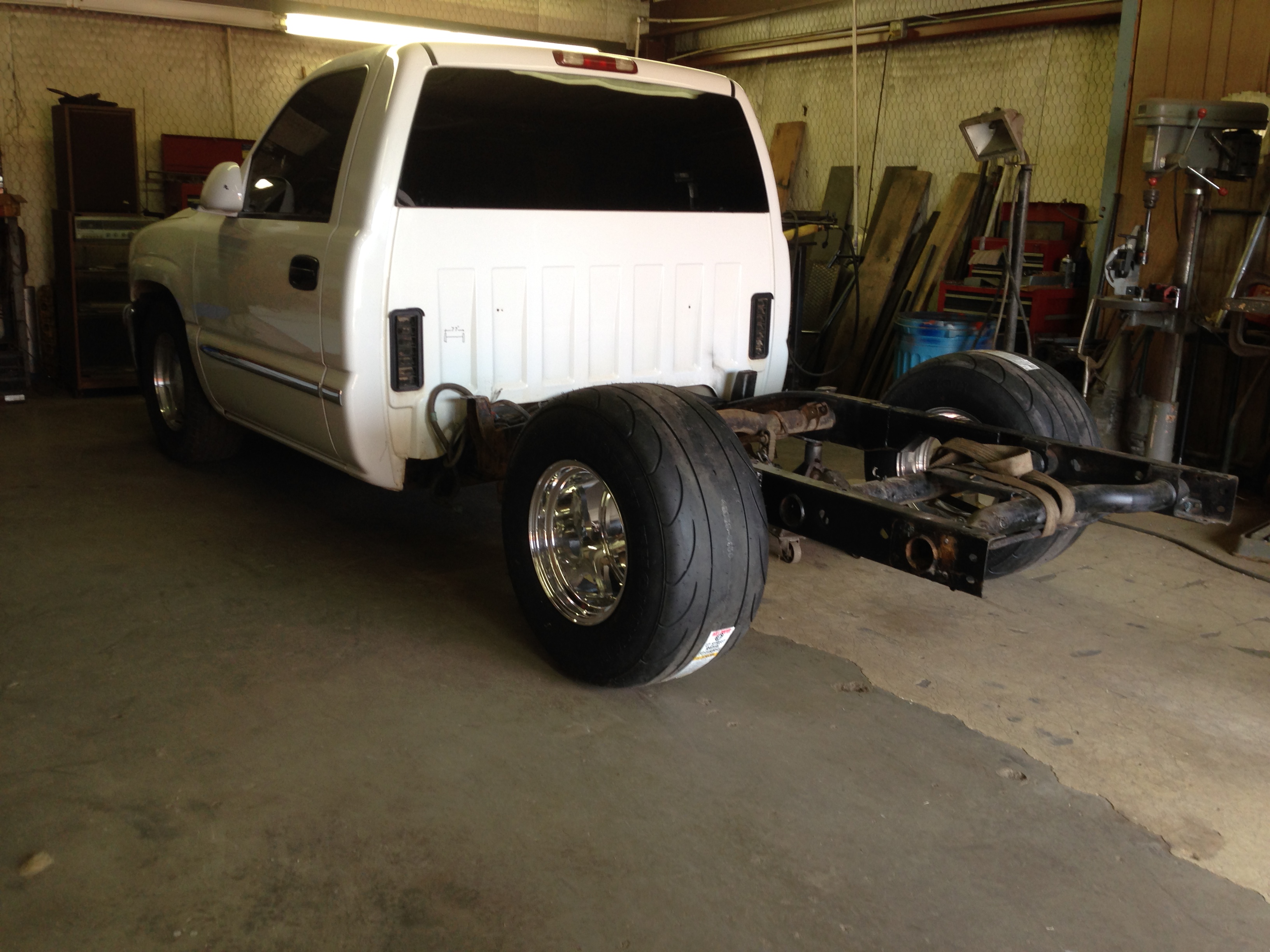

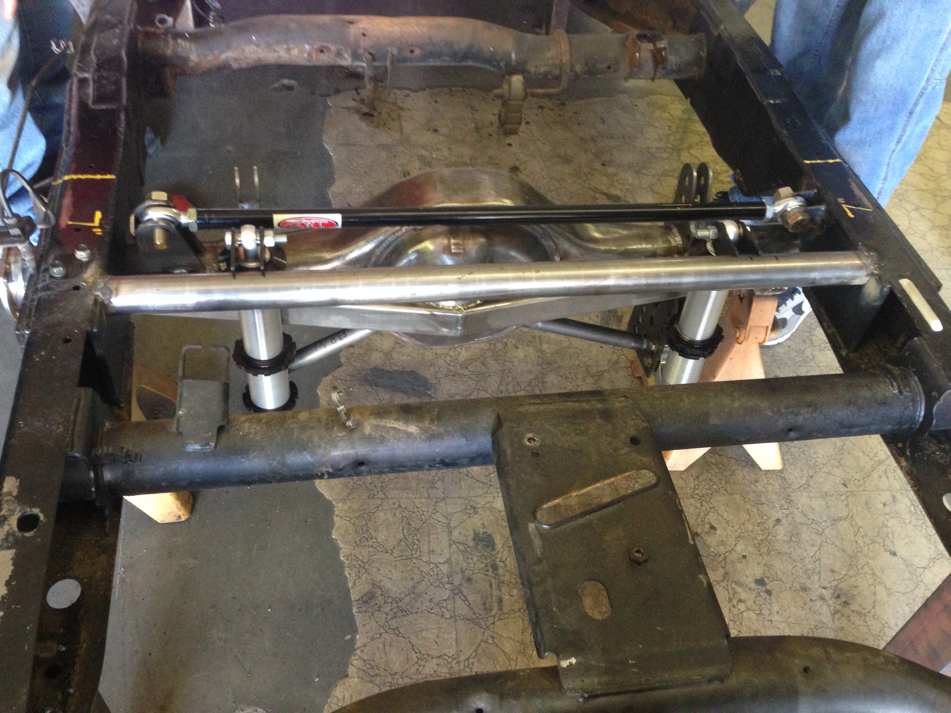

Now we have pulled the whole rear out and started on the new 9" rear end and the 4 link suspension. I am converting the truck from 6 lug to 5x4.75 for better wheel selection. I bought a set of Billet Specialities Street Lite wheels in 15x12 with a 3.5 bs and put a set of 315/60/15 Mickey Thompson Drag Radials on it. Still need to do the front hubs and get my front wheels on. I ordered a set og Strange 35 spline axles that should be here Friday. I get more pics up as I get futher along.

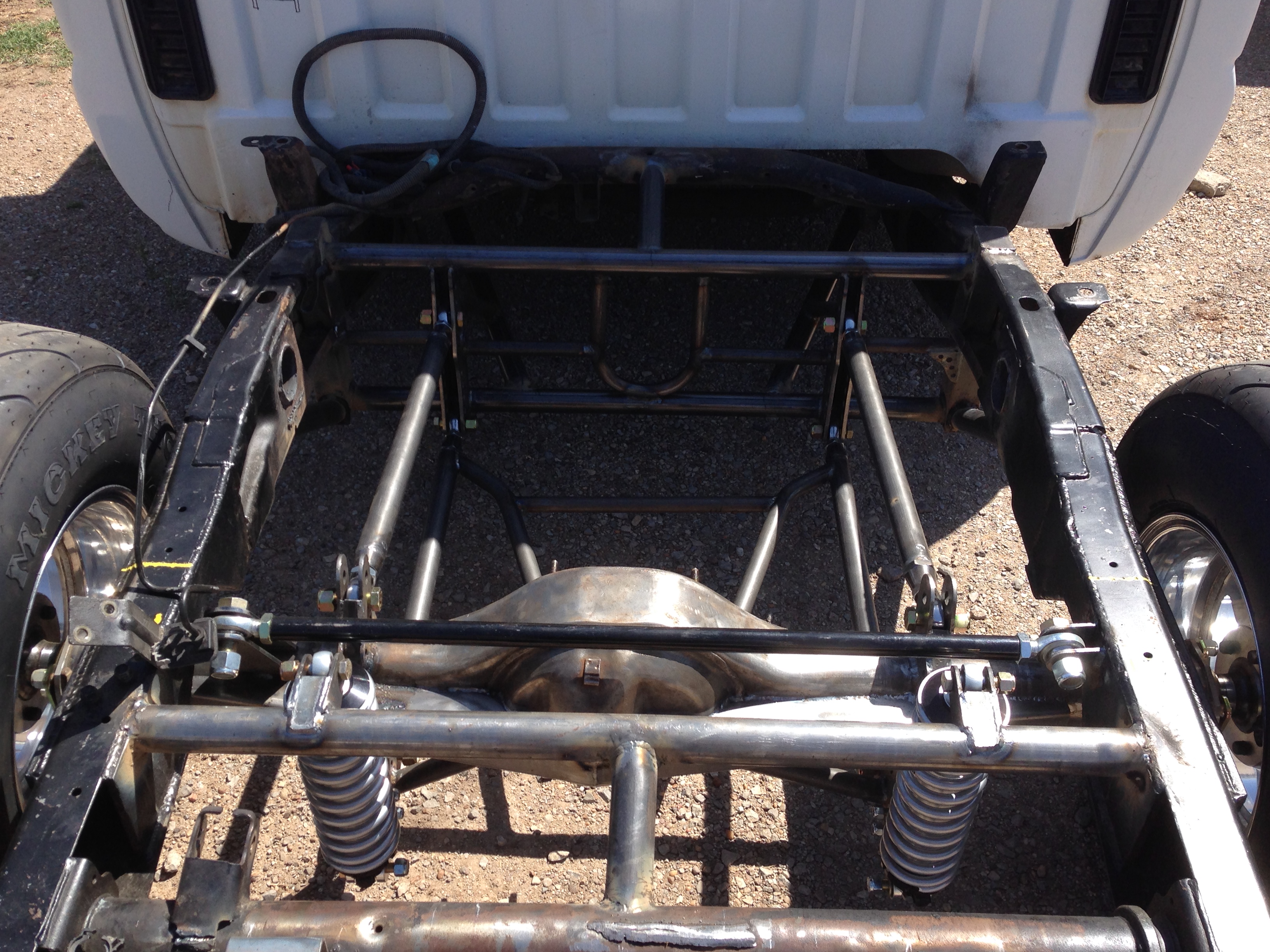

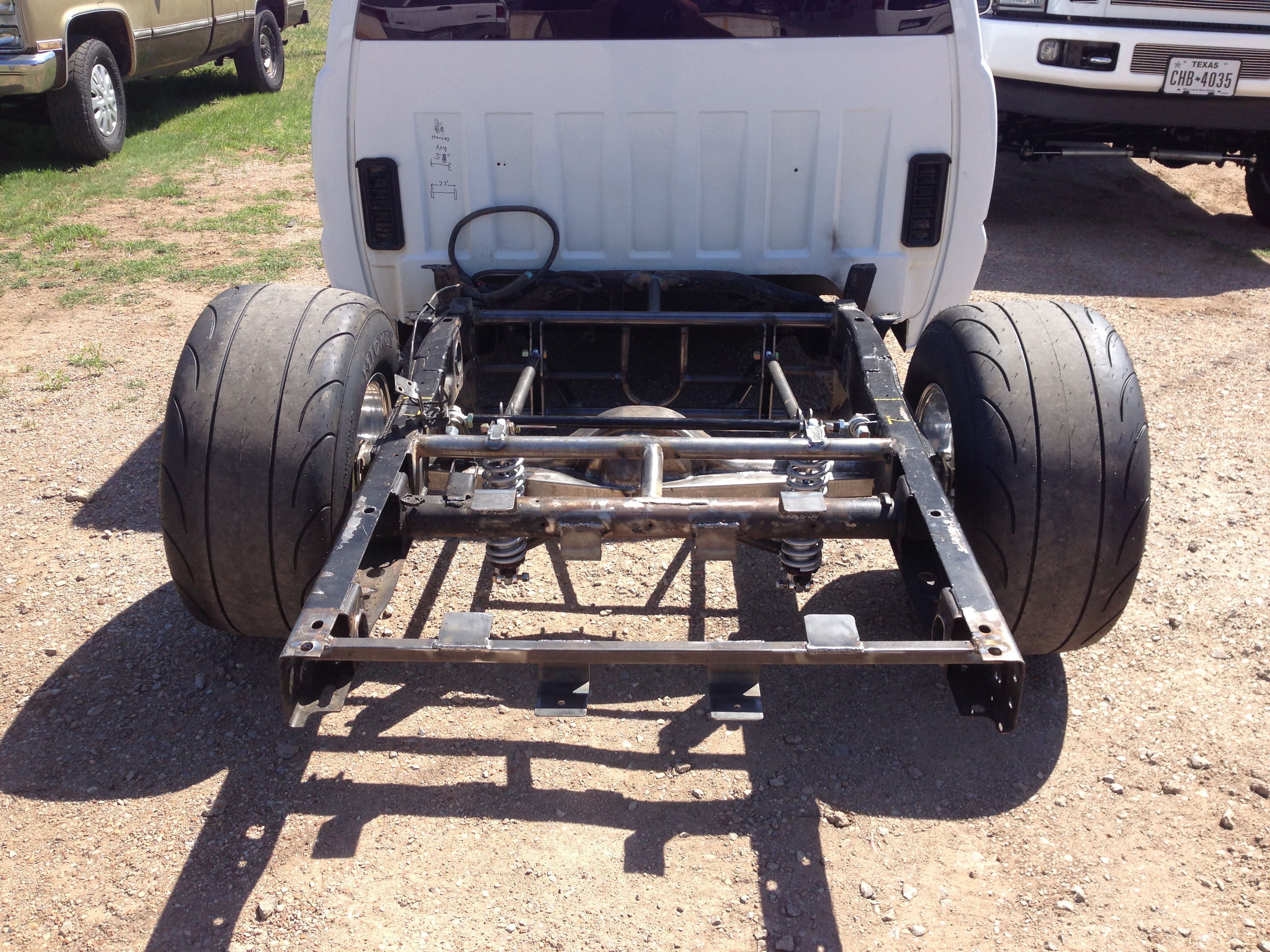

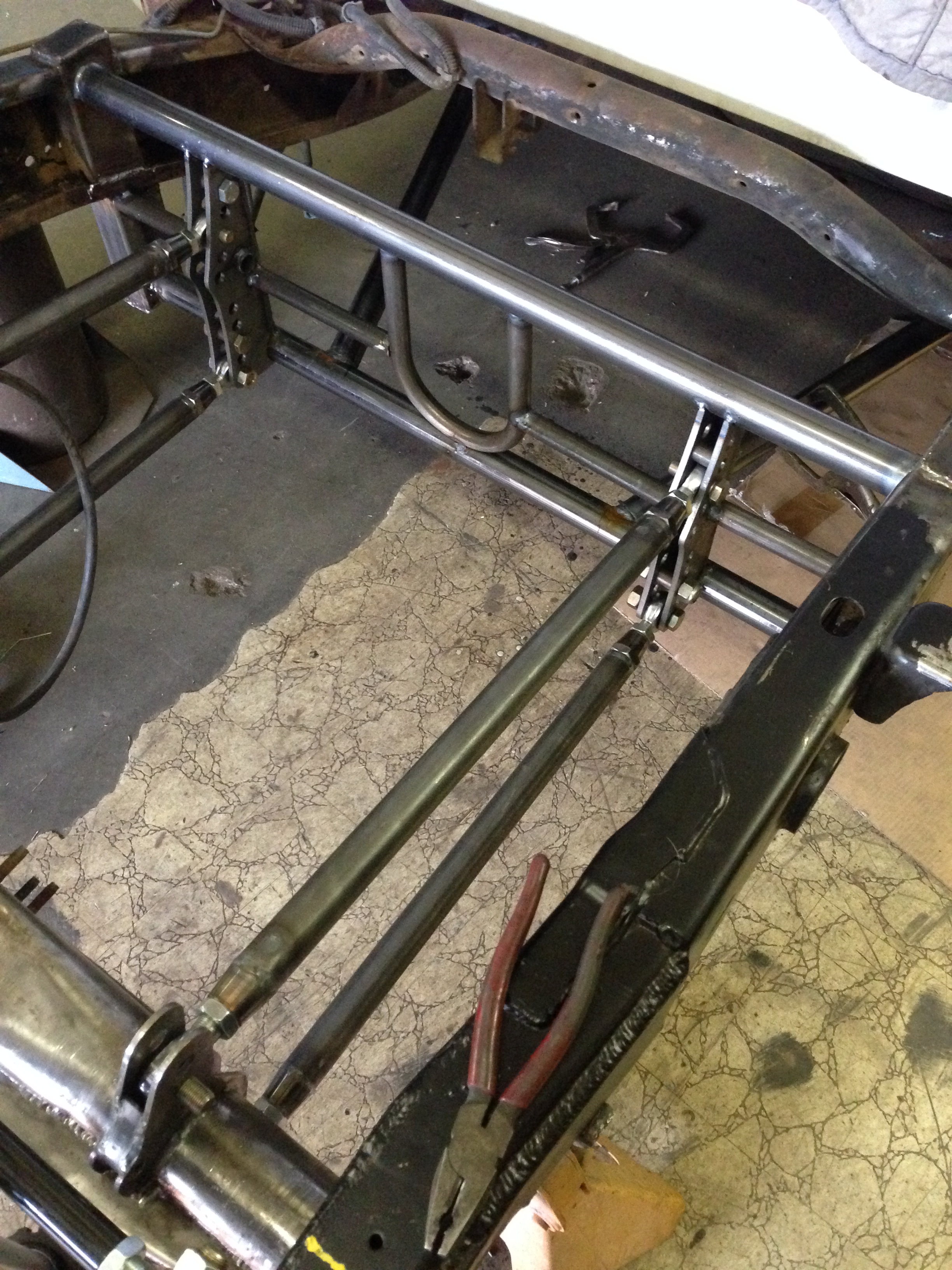

Getting a little closer on the rear. Still have quite a few bars to add in and brace up. Going to try and not have to put a cage in it but I am sure its going to have to be done if I do go to a track somewhere?? Strange sent my axles I had them make. They are 35 spline with 5/8 studs. Will have this thing rolling pretty quick.

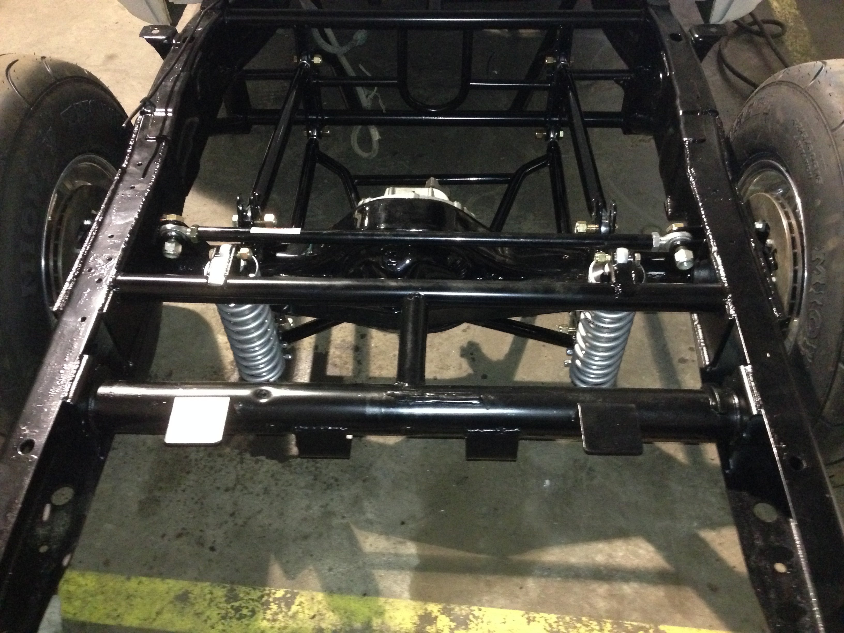

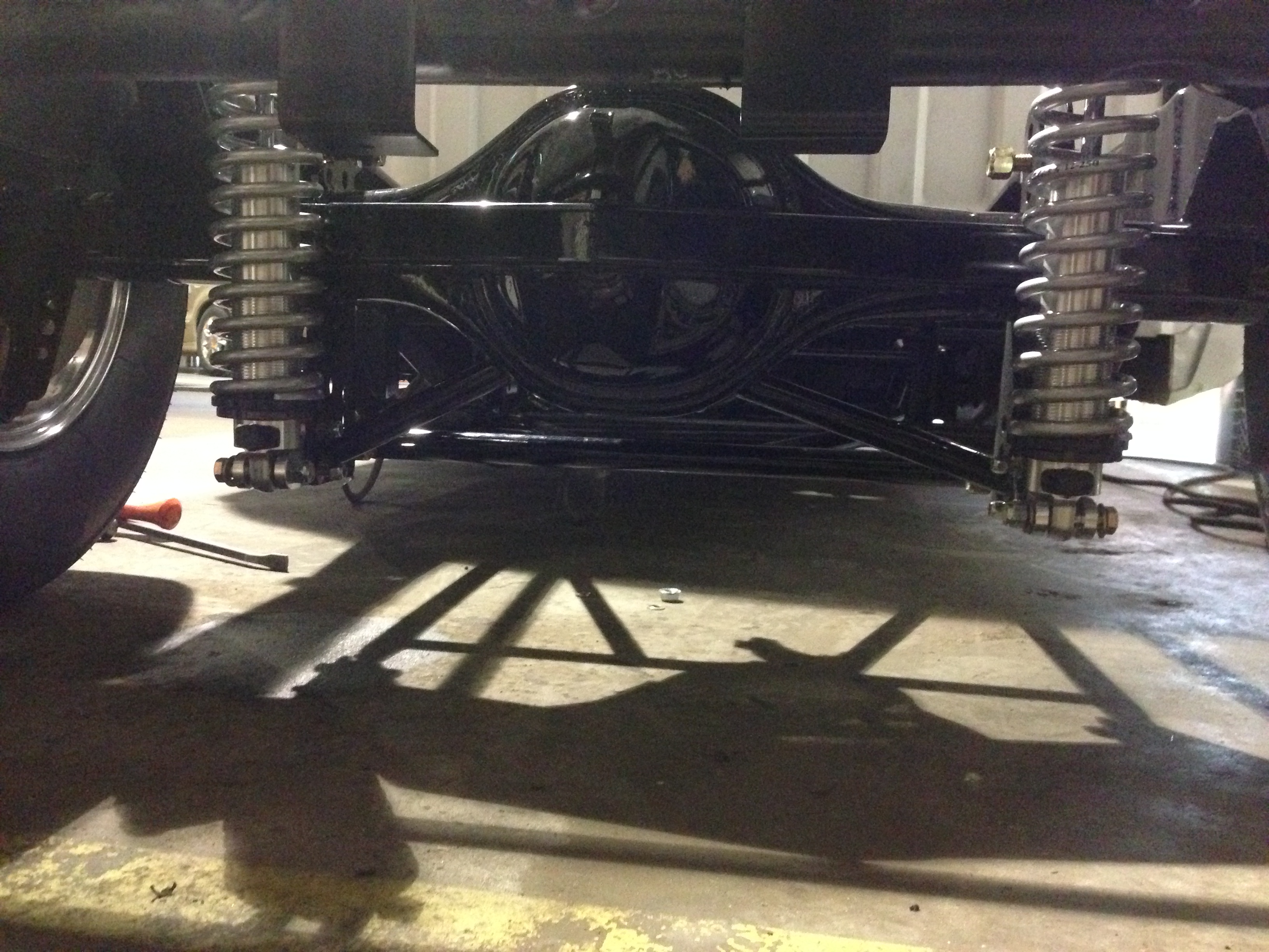

Well I guess my build is pretty boring but finally got it back as a roller. Now coming back apart to paint and powdercoat. Hopefully it will be more interesting once I get the engine and tranny slid into it.

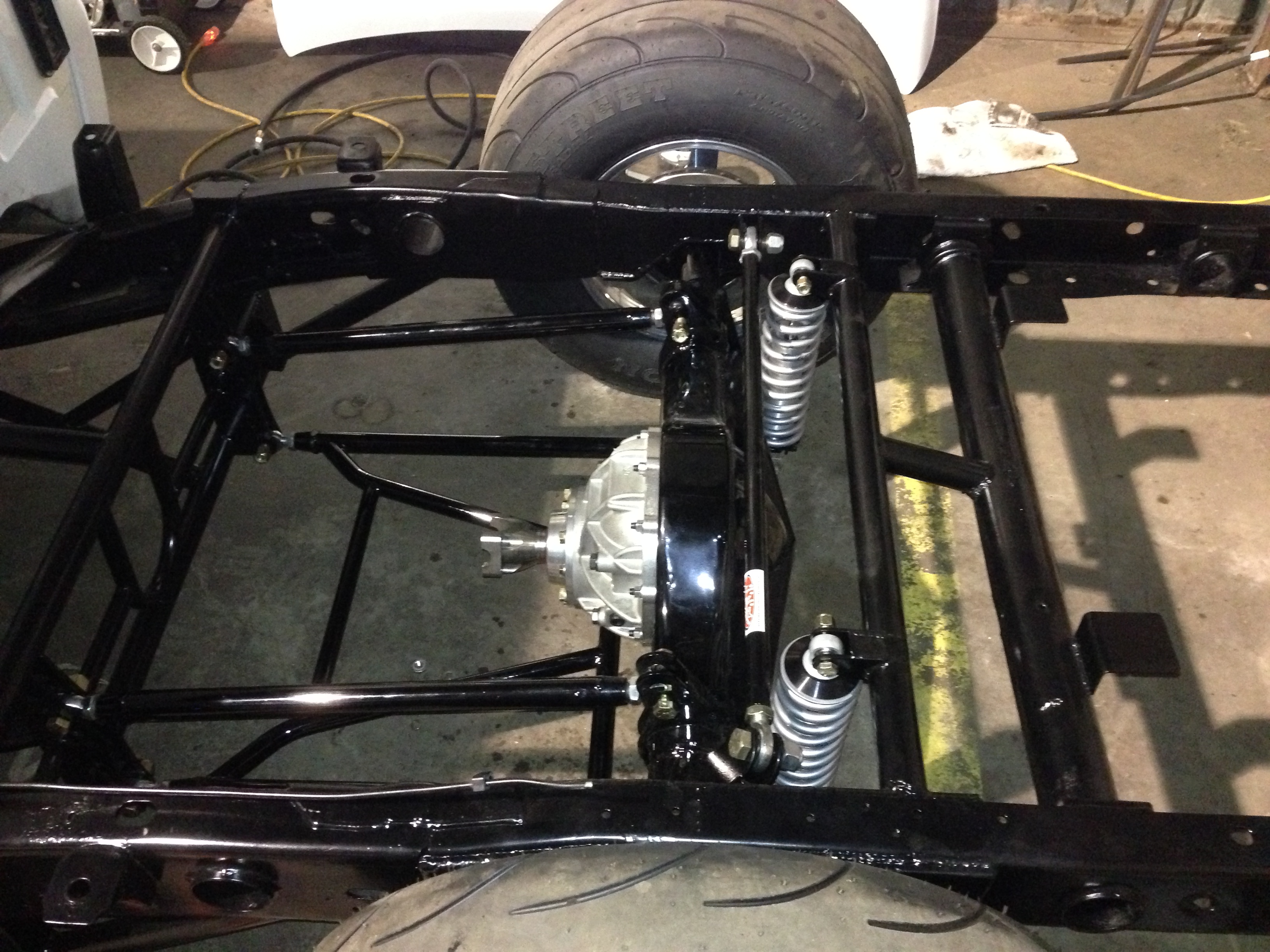

Got the engine stuffed in and still have a bunch of crap to do as far as wiring and all that and got the rear stuff back from the powder coater and painted the frame and threw it together. Got the third member put together and stuffed in the housing. It is a strange bolt-through aluminum case with a 10 bolt pinion support, 35 spline Detroit Locker and 3.70 Richmond gears. All is coming together pretty good and ready to get the tranny in it in the next day or so.

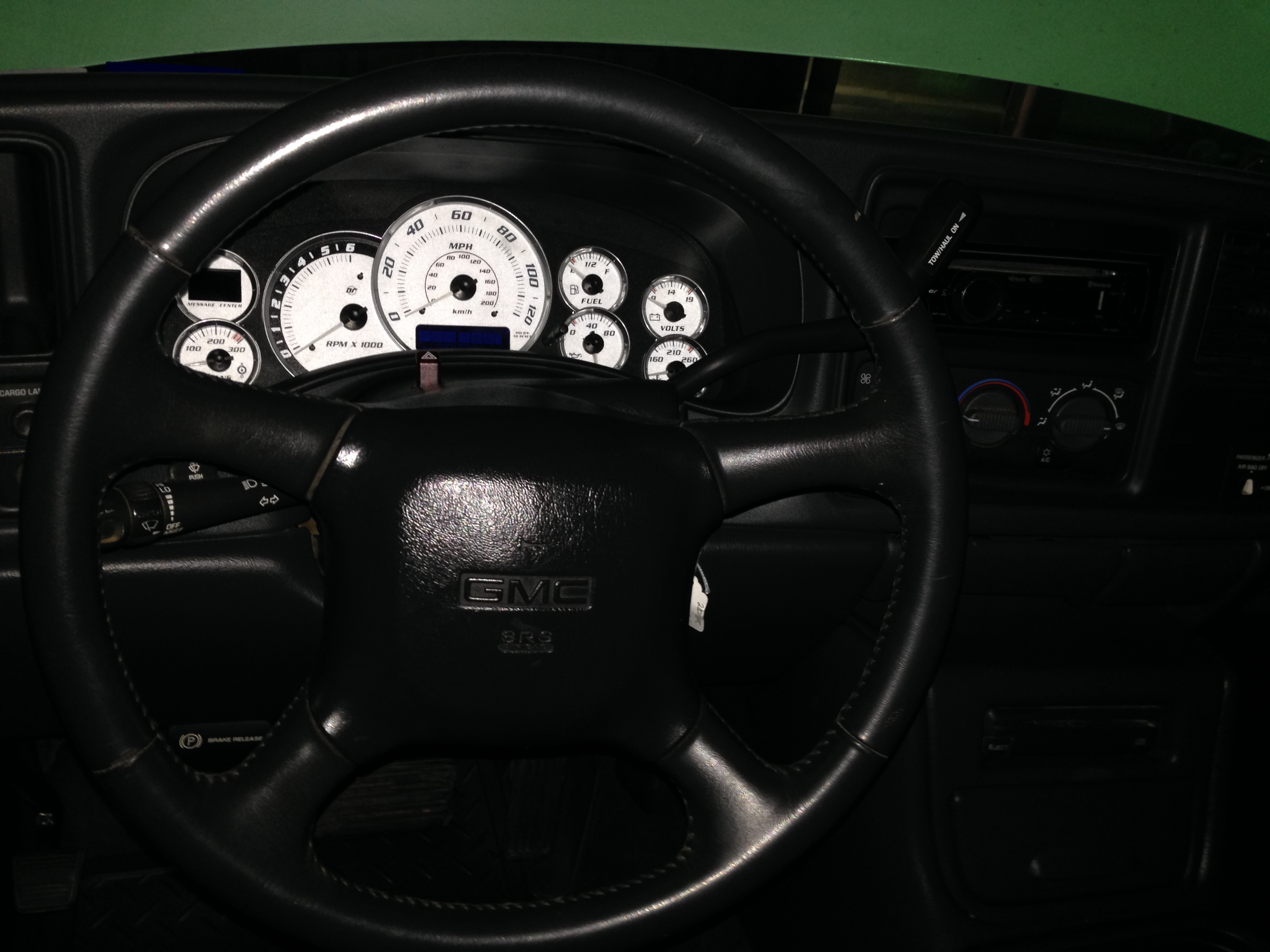

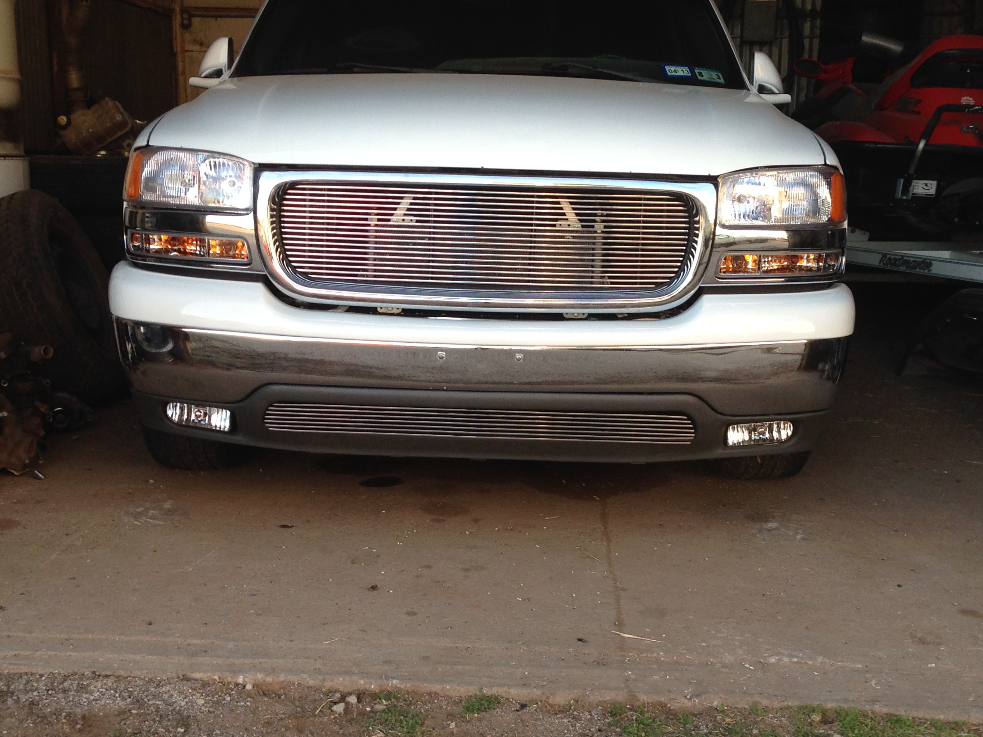

I also put my caddy cluster in with the white face. I think it looks pretty good.
