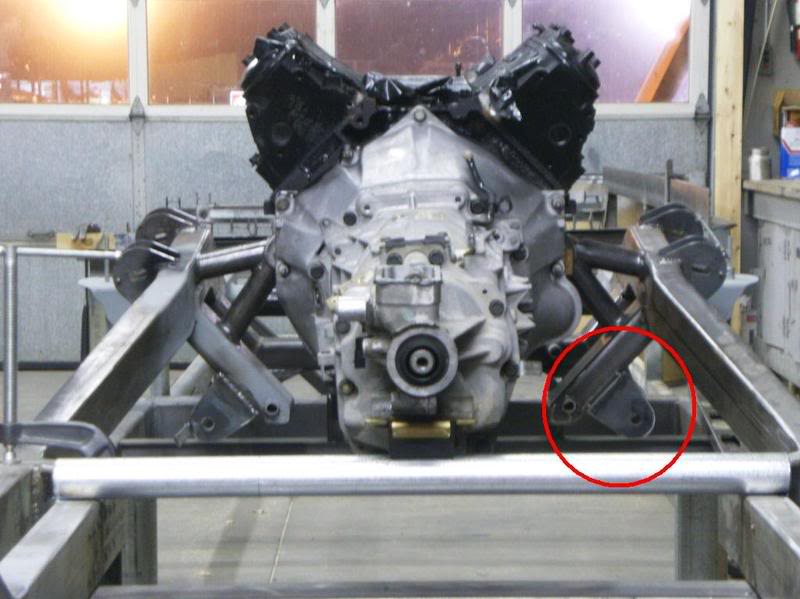

This project is amazing, please for that frames sake double check everything, I see that the right side (LCA?) bracket is only tacked, donno if you want it that way or not but dont want to see it missed.
