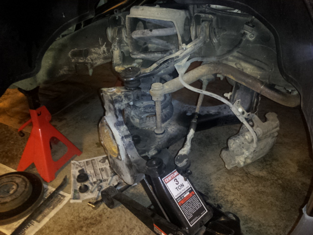

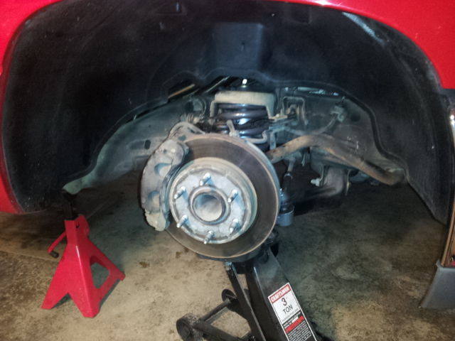

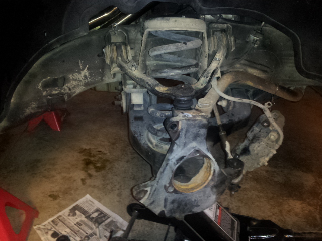

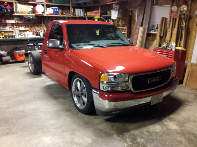

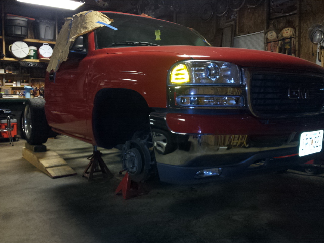

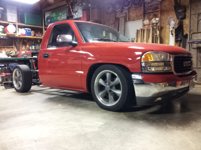

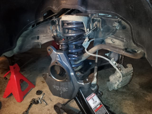

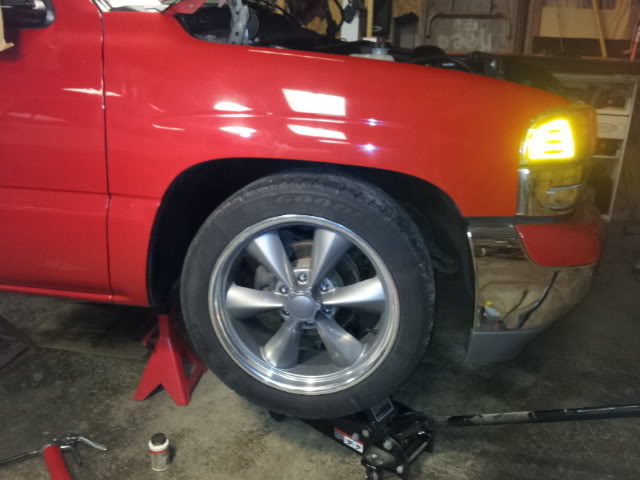

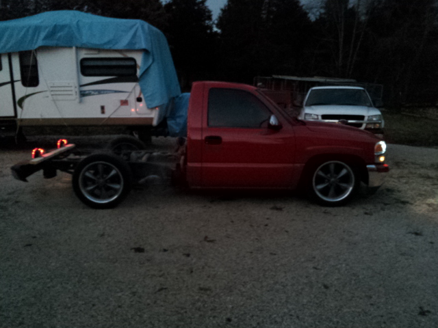

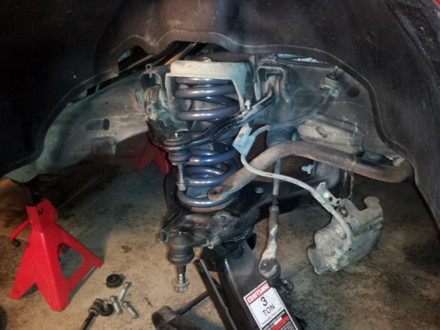

Got the front done, took it on a short drive with no bed. Rigged some tail lights so I can drive it for a few days and retorque everything down.
