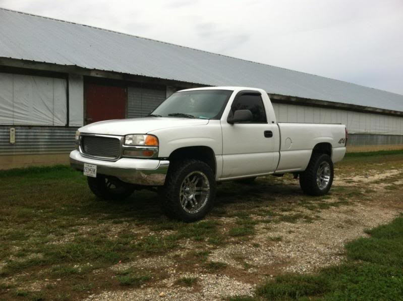

I recently purchased a 2000 gmc with 247k miles. It has a 4.8 and 4l60e 4x4. All said and done, I'd like for it to be a 6.0/80e. But Im going to build around the 4.8 for now to see how far i can push it. Going to try to retain driving ability to be able to jump in it and go anywhere needed whether 10 minutes to the grocery store or a 2 hour drive to the beach. Currently justin@blackbear tunes the truck. I got the truck for cheap and put the wheels and tires on it which i had already, a roll pan, and tinted the windows.
My plan for power at the moment is....BOOST IT! I have a 3000 stall converter and the trans doesnt have many miles on it since it was refreshed with alto power pack, transgo kit, and servo. I already added ls1 style fans along with ls1fans wiring kit. A spectre intake that i got for a couple dollars my buddy took off when he procharged his truck, and has true dual exhaust with super 40s
Here is the truck:
It has high miles, rolly windows etc...just your basic work truck model

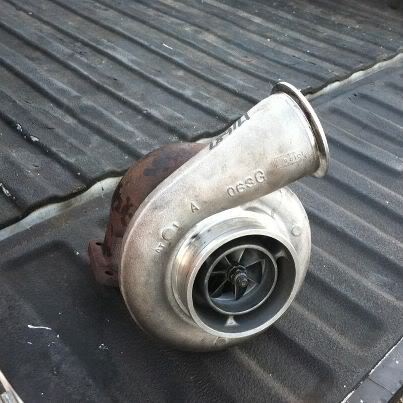

And here is the first purchase towards the turbo build:
Borg Warner s475. has the bigger 87mm exhaust wheel, t4 flange 1.1 AR
I know its probably a little big for the 4.8, but from a little research it seems like it wont be that bad with a 6.0. I purchased THIS turbo, because 1 i couldnt pass the deal up, and 2, I am only buying parts 1 time. (anyone else have any person experience with this charger)
I also talked to kyle@KbRacing yesterday and today and ordered a log style manifold from him.
Thats all I'v ordered at this point. I am a welder/fabricator and have an exhaust pipe bender so i plan on making the cross over pipe myself along with the downpipe and all intercooler tubing. I would love to have it around 8-10psi on stock bottom end. I plan on adding a cam before the turbo goes on as well, 65lb injectors, and a 044 pump. Any ideas what kind of power this setup is capable of? I was told that if i drove normal and stayed out of boost that normal driving is definately doable until it lights...then it will be a whole nother animal. Thats about all i have to report now. Ill try to get more pics up as parts roll in.. Kyle is on VACA right now so until i get the manifold from him im at a standstill for mocking up the pipes.

I just put a s476 with the 87mm and 1.25 on mine with a 6.0. Takes it a second to build up part throttle boost but its nuts going wot from a 50-60 roll or something. Good luck!
Old Oct 21, 2012 | 02:52 PM
loganlewis's Avatar
Joined: Feb 2010
Posts: 78
Is that a t6 housing? Mines a t4
Old Oct 21, 2012 | 05:46 PM
lglowe's Avatar
Joined: Jul 2009
Posts: 640
From: Monticello,MS
Yea mines a t4 too

i like it dude..im running a S475 on 6.0, no complaints here
