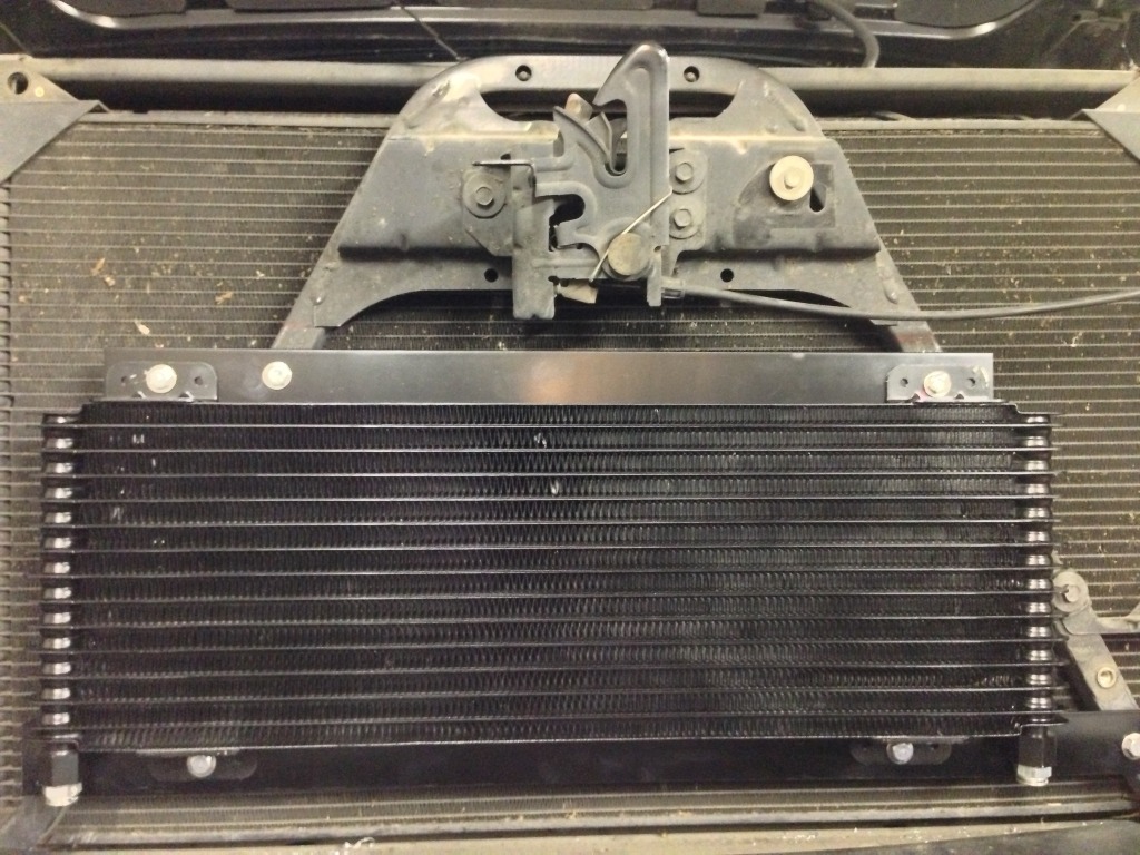

I got my humongous trans cooler mounted.
I had to cut away this air dam a little bit to clear my trans cooler lines. At least it's hooked up like it would be from the factory.

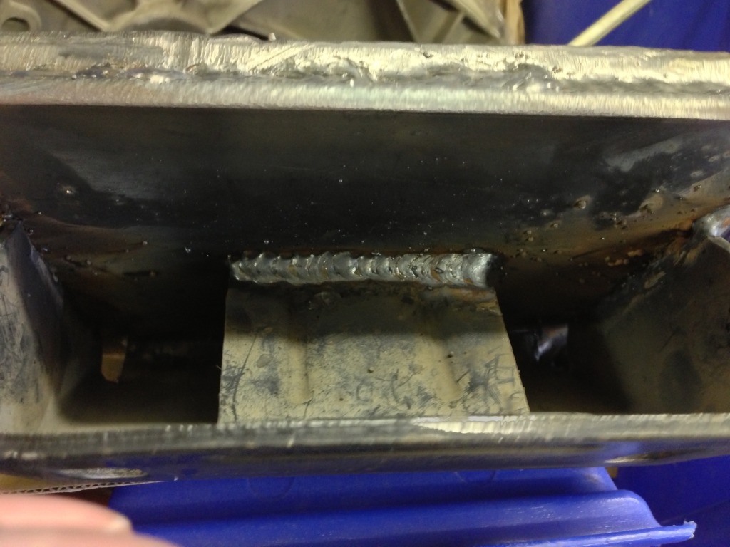

I finally got my modified crossmember welded. I have access to a 110 welder but it just doesn't penetrate very well. Still, I used it to tack my trans mount into place.
Here's a pic of me drinking a beer while my buddy weld up my crossmember. LOL.
The welding handiwork from my buddy.

It fit perfectly.
