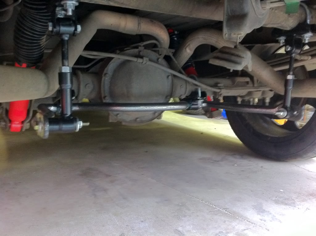

I started messing around with my rear sway bar setup.
Here's everything all lined out. I went with the Hellwig 7800 adjustable rear sway bar kit.
The first thing I did was loosely mount the front U-bolts to the rear bar.
My exhaust is in the way to properly mount the rear bar. You're supposed mount the rear links on the outside of the bar.
I centered the bar and front mounts the best I could. On the driver's side the upper shock mount was in the way. What I ended up doing was using 2 1/2 inch spacers on the drivers side. While this isn't ideal, I think it will suffice until I remove the exhaust and replace it with a single 3 inch exhaust.
Here it is all said and done.

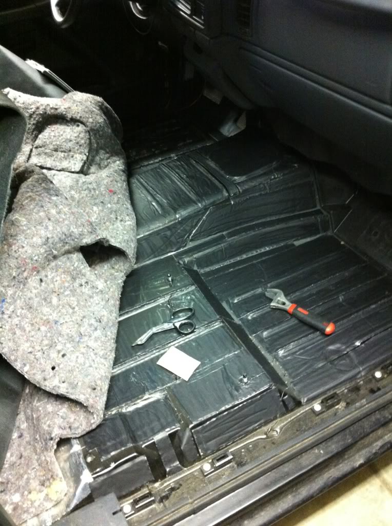

After that I started messing around with my electric seats. A while back, when I was collecting my brake upgrade parts, I noticed an all leather interior truck. I ended up picking up the 2 seats and center console. Since its so rare that there are 3 bodies in my truck, I decided it would be okay to give up my center seat.
When I bought my truck the first thing I did was take the interior apart and apply sound deadener. I ended up running out of time and only getting the rear wall and drivers side deadened.
So I took my seats and console out and pulled back the carpet.
...and applied a nice layer of Damplifier.

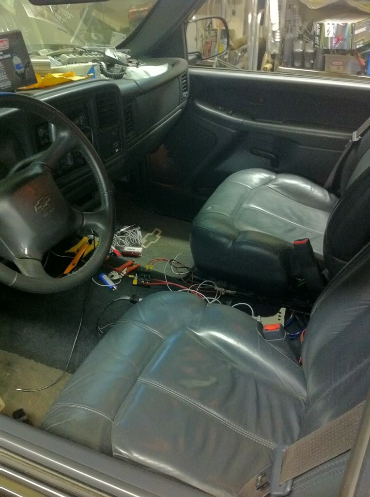

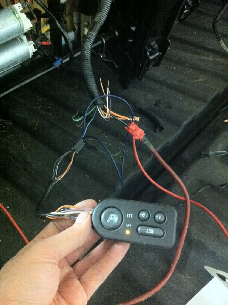

I got to messing around with the seat harness. Basically all you have to do to get the powered seats to function is to connect all the orange wires to 12+ and all the black wires to ground.
But, I want the heated seats to work as well. I started a thread asking for help. I got some wiring diagrams but unfortunately they were for 2003 seats. Mine are apparently from a 2002.
I ended up figuring it out though and with a little creativity, I got the heated seats to work.
Now, if I really wanted to be trick, I'd wire in the memory seats as well. I'm not going to do that and here's why.
With my truck being a regular cab, its possible for the seats to be pushed into positions where the seat could interfere with the cab. The last thing I need is the seat trying to move into a memory position but running into the back window and burning up a motor.
The only other person that drives my truck is my wife and that's not very often. She'll just have to adjust the seat manually.

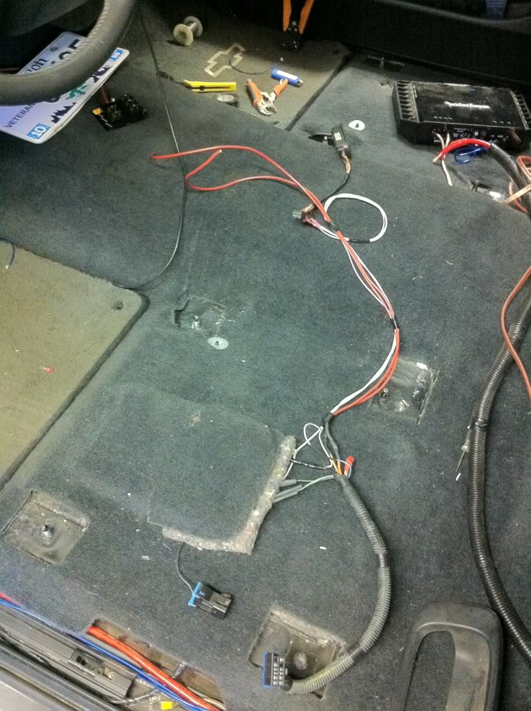

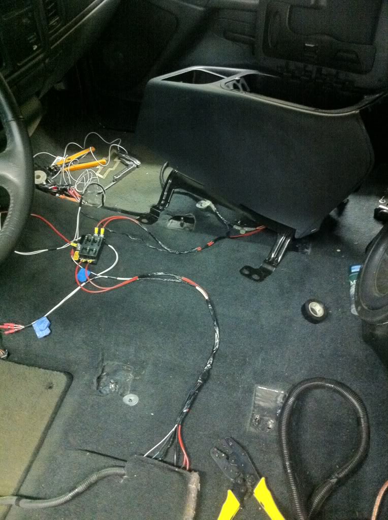

Here's a pic of the beginnings of my hand built harness. When it's all said and done everything will be hidden. I'm thinking I'm going to mount the heated seat button on the side of the console.
That's as far as I got this weekend. I'm real close to driving it soon. All I have to do is finish up the seat wiring, put in the center console, bleed the brakes and get an alignment. That would get me to driving again. I'd also like to cut and buff the paint before I drive it. (and put on my secret decals.)

I haven't had a lot of time to work on my truck like I'd like to. I have gotten all of the powered and heated seat's wiring figured out.
I didn't take any close up shots of the actual harness itself. I have no need to have the memory function of the seats work, so I didn't wire that in, but basically it goes like this:
To power the seats you connect the 2 orange wires to 12v+ and the black wire to ground. You can tell which wires they are because they are larger than the others. (Like 10-12 gauge wires. Don't forget to install a fuse.) That's it for the powered seats.
To make the heated seats work you're going to need the switches out of the door handles. (Duh.) They have several wires on them, but all you need are the black, brown, and light blue. (Not the brown wire with a white stripe.)
The black wire goes to ground.
The brown wire goes to a switched 12 volt source.
The blue wire goes to the blue wire in the seat's harness.
That's it. That will make the heated seats work. Now if you wanted to you could wire the brown wire in with the orange ones. The problem with that is the heated sets would always stay on. I wanted the heated seats to automatically shut off when I turned the key off. Oh, and you can get a switched 12 volt source in the fuse panel under the steering wheel right beside the brake pedal.

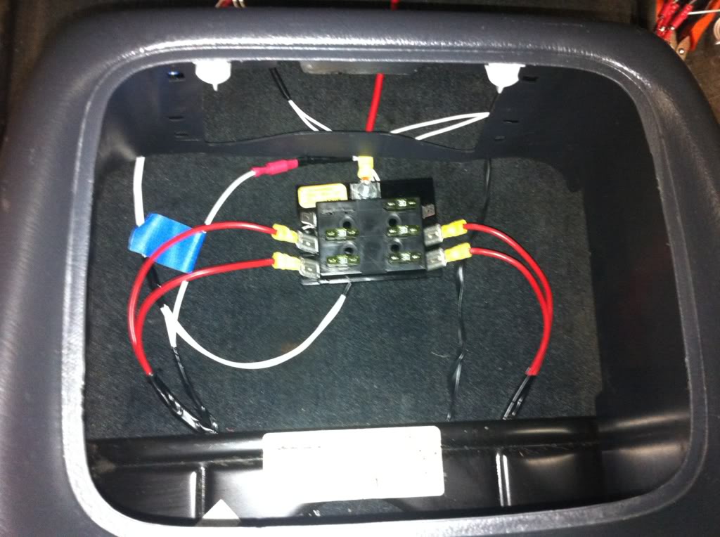

Harness is almost done. All of this will be hidden in the center console. It's almost like those seats were meant to be there!
I just ran out of time. The powered seats work 100% and I need to make 3 connections for the heated seats to work on the passengers side.
What I'd like to do next is move on to stereo installation, but I need to make a new subwoofer box and order a digital sound processor. I really need to clean up the seats and console though. The last owners were pigs!

Wiring finally done.

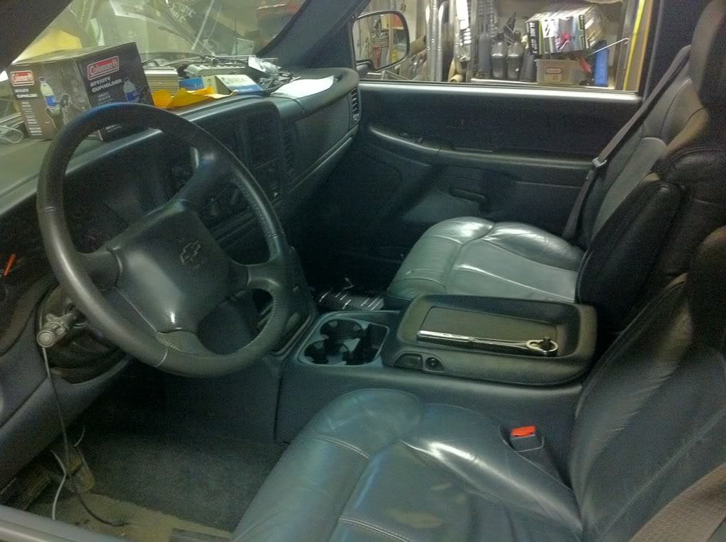

Yay console! That empty spot above the door there is where the factory cassette player was. I think I'll put my wideband there.

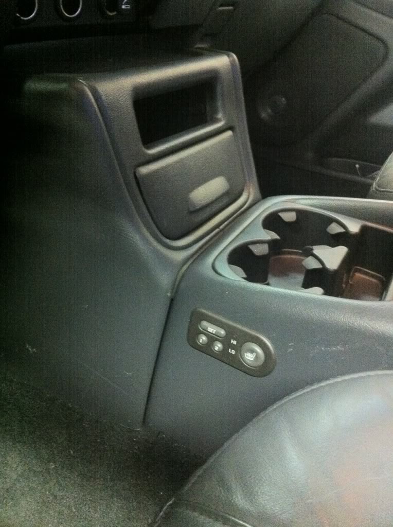

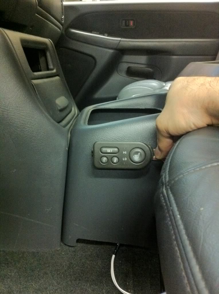

This is where I think I'll mount the heated seat switch. What do you guys think?

Heated seats switches are mounted and functional.

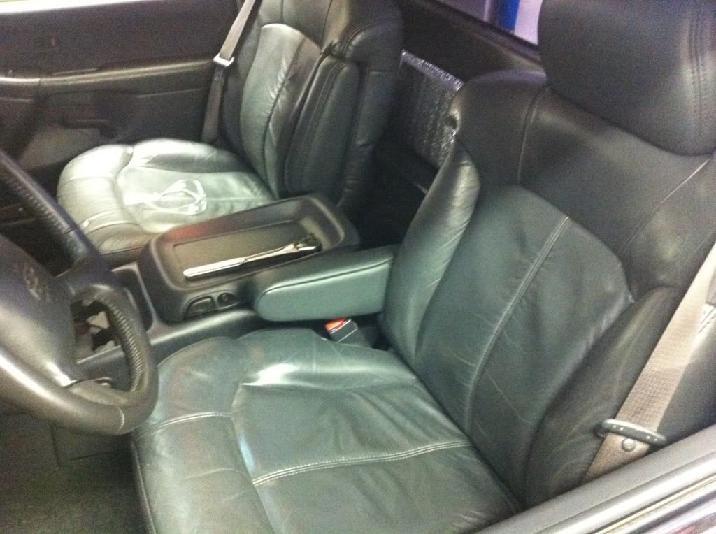

Seats and console are 100% done. Now I just need to fab up a subwoofer enclosure. I'm going to see if I can fit a 12" IDMAX.

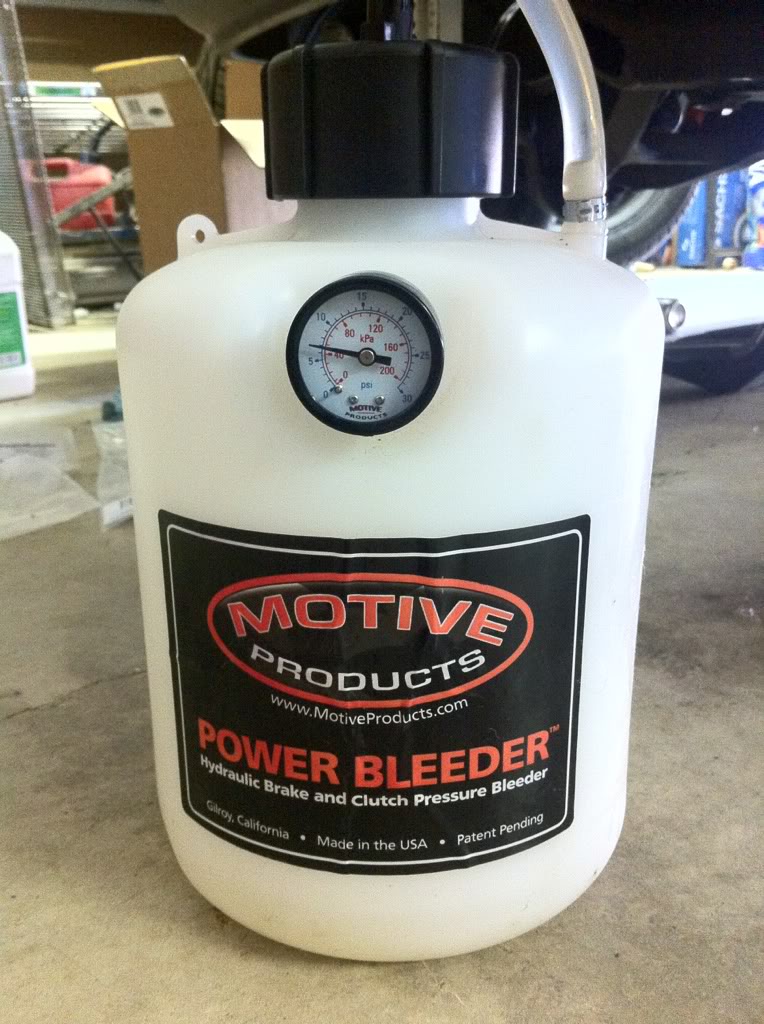

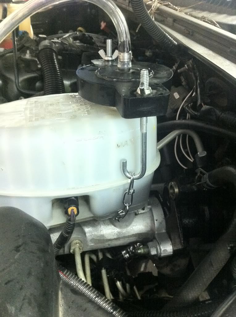

I messed around with bleeding the brakes today. My stepfather has a pressure brake bleeder. I have never used one before.

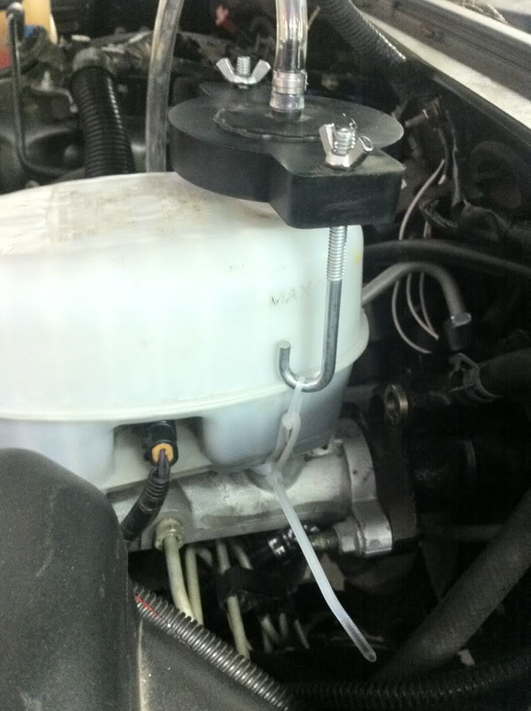

I couldn't get the hooks to secure the lid so I zip tied it on.
I pumped up around 5 psi and began bleeding the brakes.
Then the zip ties broke so I used a chain instead.
The zip tie incident caused a bit of a leak.

So far I really like the improvements I've made. The leather/heated seats are nice and the sound proofing helps. The first time I drove the truck, it really felt weird. The truck is lower, but it feels like I sit a tiny bit higher with the powered seats.
Overall, I love what I've done so far!
