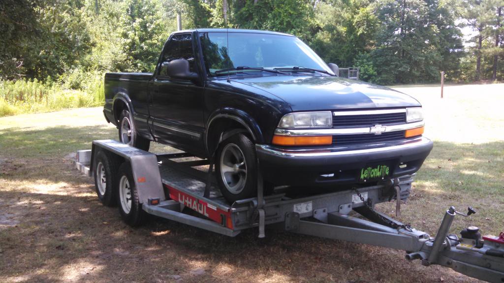

Title sums up this build. The turbo silverado is a brick, so I need something much smaller. When it's all said and done I will be happy if it's 3500lbs with me in it. Full interior street truck. I have a few pictures. I'm currently waiting on money of course. Hopefully finished by the end of the year...

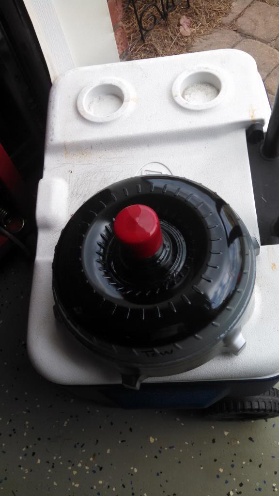

Circle D convertor

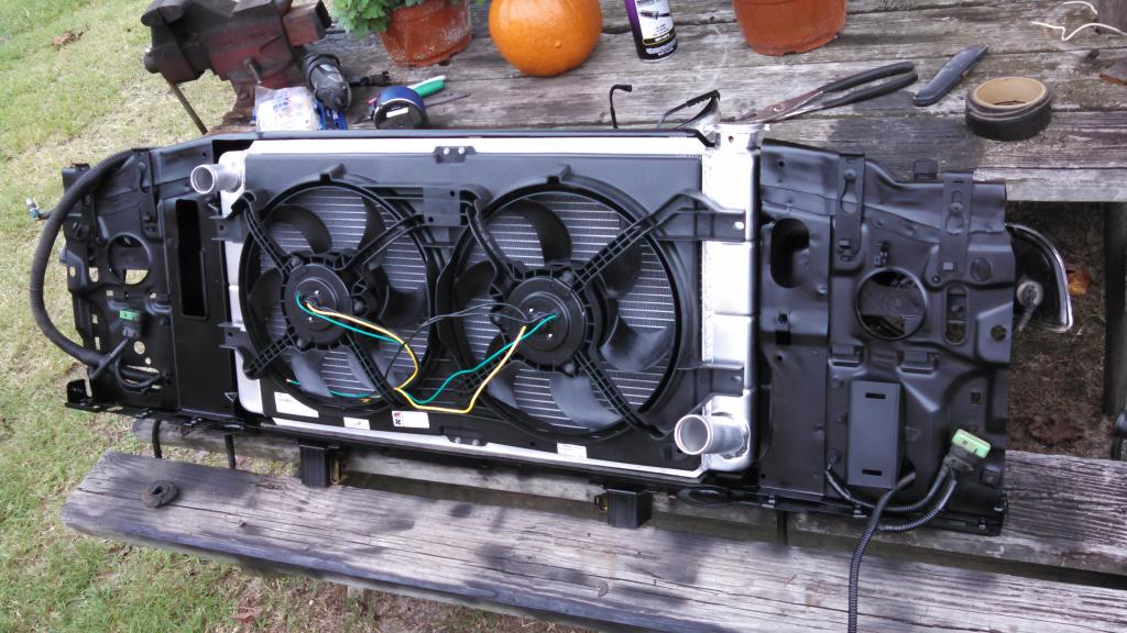

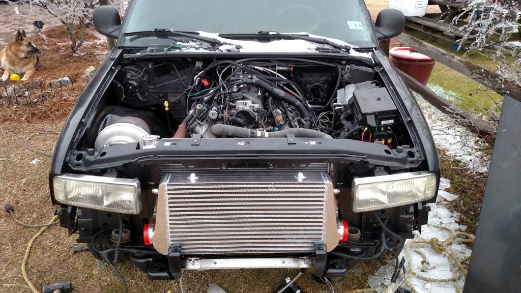

I'm very pleased with how this radiator/fan combo worked, everything just happened to fit together perfectly

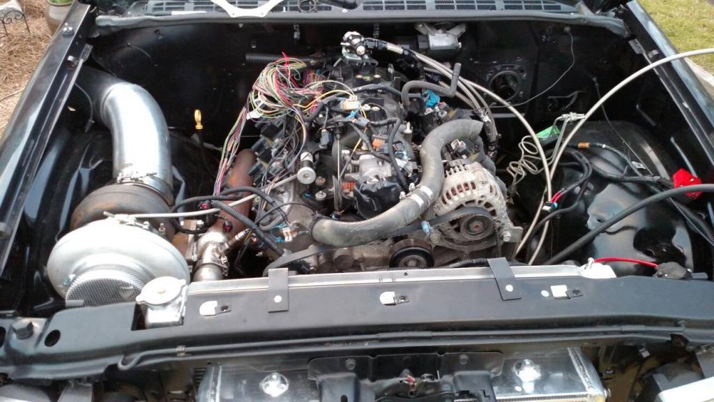

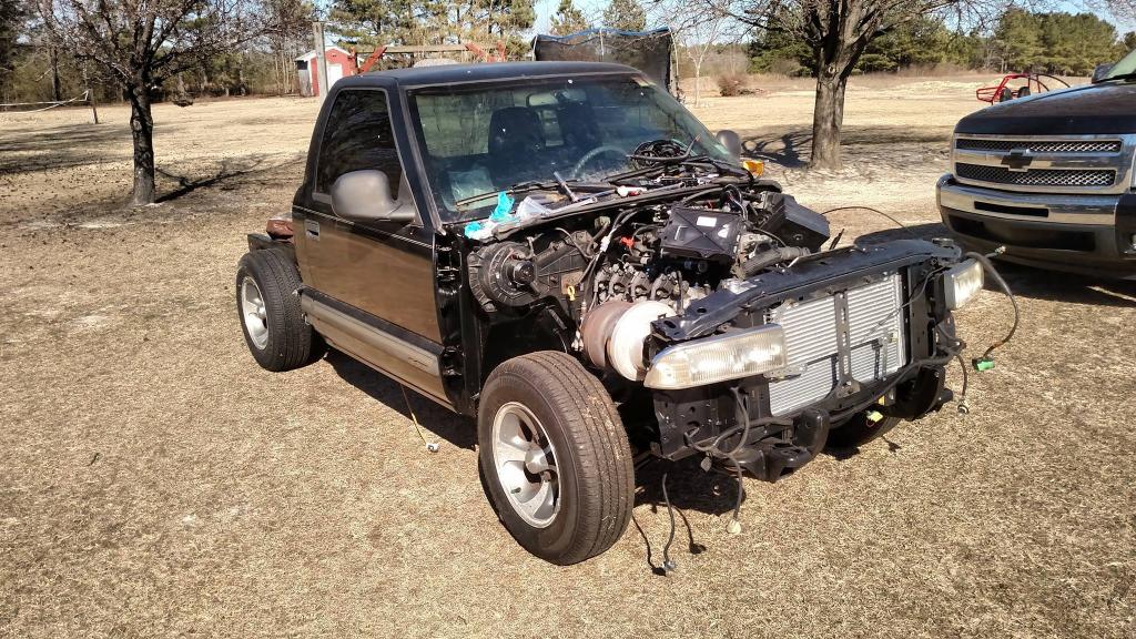

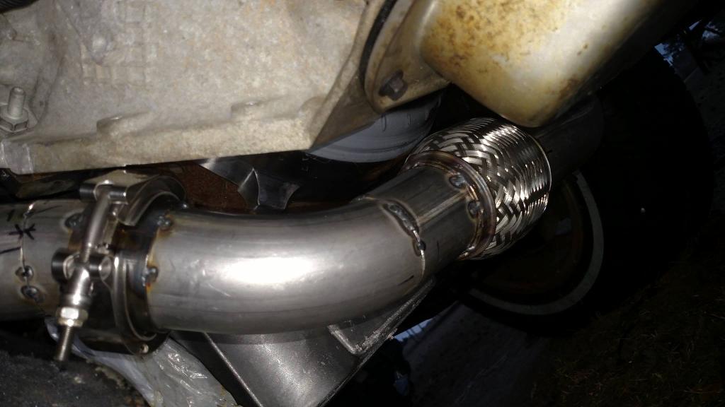

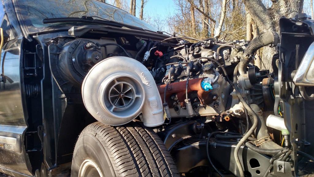

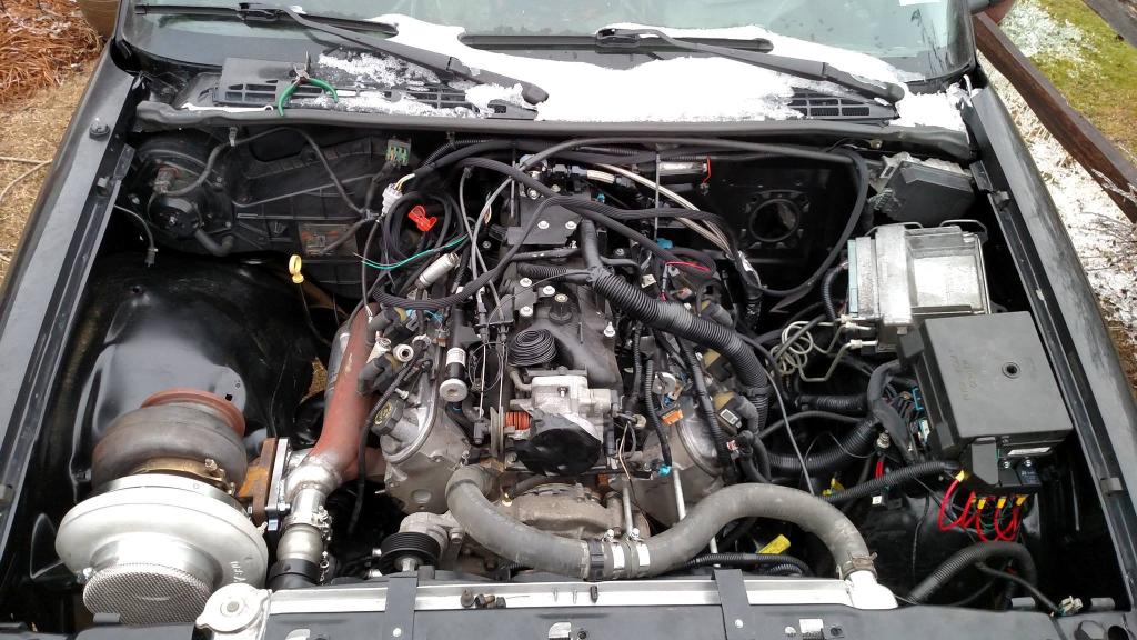

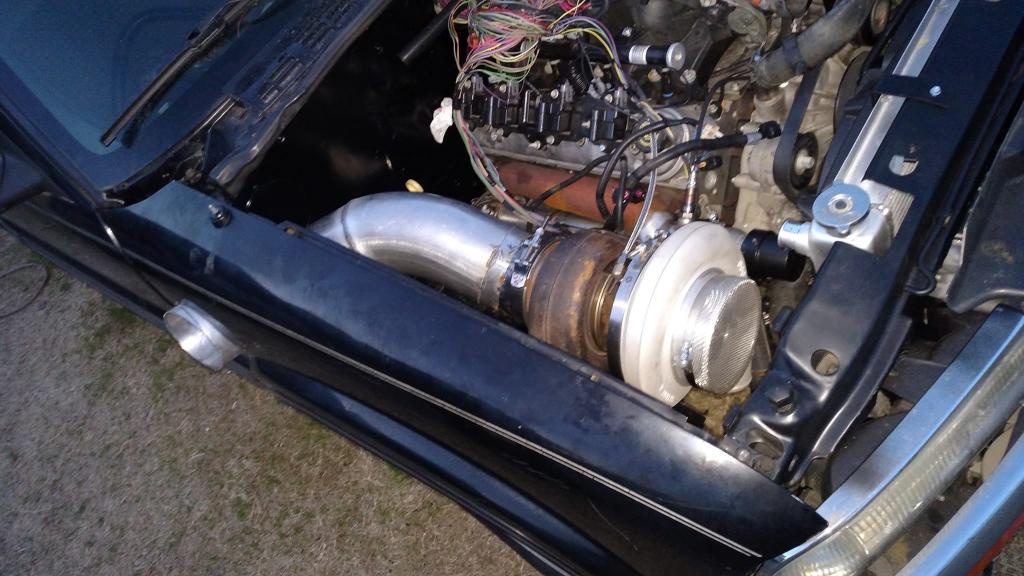

how she sits right now... ready for pipes and a turbo

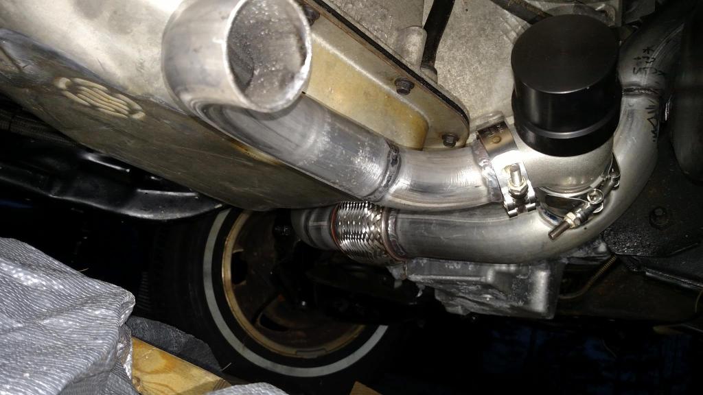

this is just a regular passenger side truck manifold flipped up
this is a driver side tbss manifold, looks like it work perfect for a crossover under the bellhousing. i didnt have much room to make a flipped forward truck manifold work on this side.

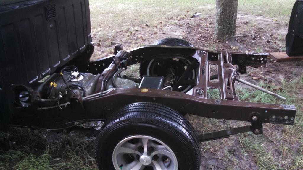

Nice build so far.
Curious if you had to hack up the front of the frame at all, I just remember reading a local's build thread on a different board and he had to mod the from crossmember to make everything fit. But I have no clue what oil pan he used or what mounts he installed.
Old Nov 17, 2014 | 11:50 PM
MechE's Avatar
Joined: Mar 2013
Posts: 245
From: Raleigh, NC
i did not have to cut the frame at all. im not running a/c and i used the hummer h3 pan, so it clears the crossmember fine

What radiator and fan combo is that? Hey if u dont mind Could u shoot me a measurement between the rear frame rails. For a fuel cell. Thanks.
Old Nov 21, 2014 | 05:01 PM
MechE's Avatar
Joined: Mar 2013
Posts: 245
From: Raleigh, NC
the fans are dodge intrepid fans, 6 blade. the radiator is northern 31"x16" p/n 209628. ill have to get back with you on the measurement, the truck is an hour away from me

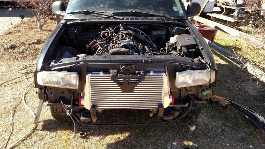

Old Mar 9, 2015 | 10:21 PM
MechE's Avatar
Joined: Mar 2013
Posts: 245
From: Raleigh, NC

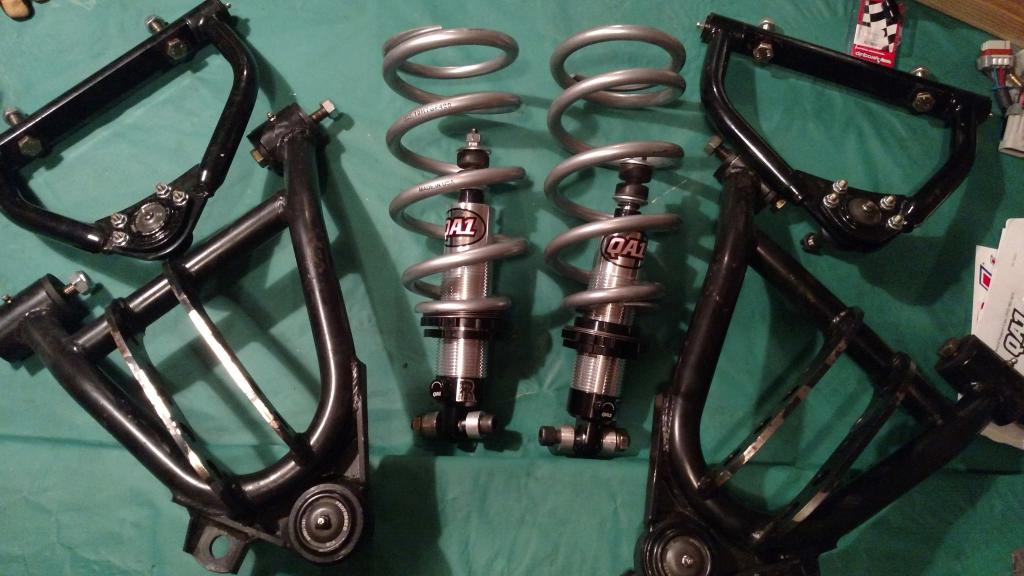

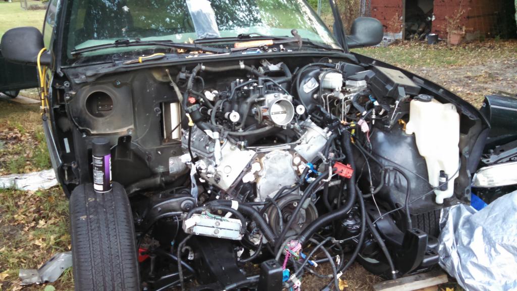

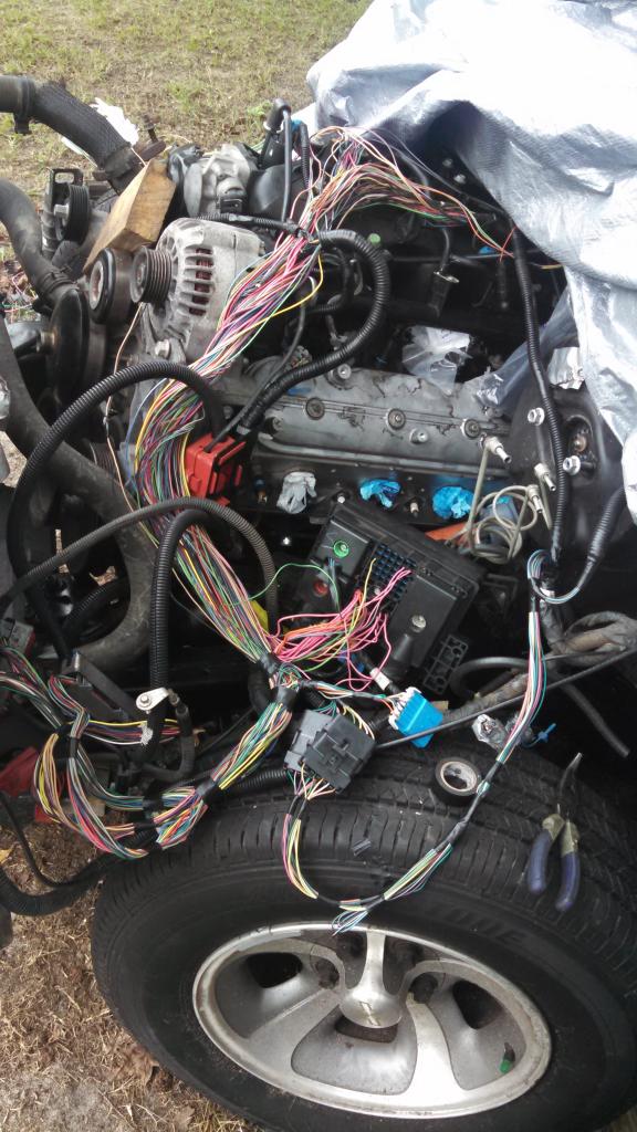

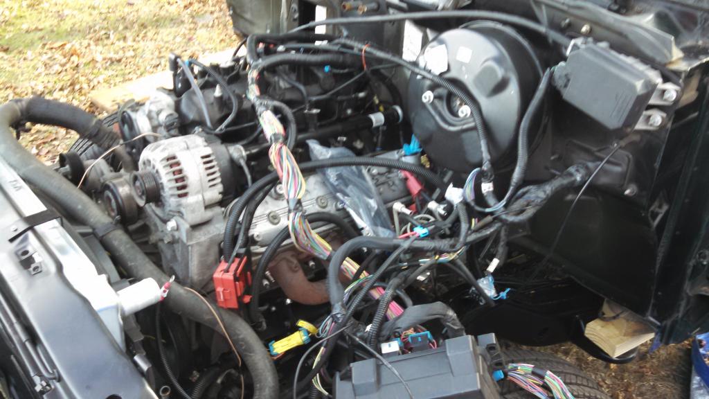

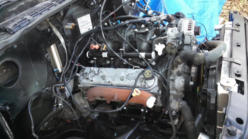

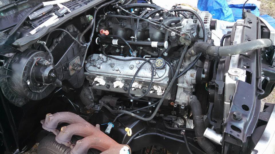

pretty big update if anyone is interested..... im going to try to go from oldest to most current. currently working on cleaning up engine bay and relocating all wires/fuse box/pcm yada yada yada....
needless to say... i've been busy with this truck... any questions? lol
Old Mar 9, 2015 | 10:23 PM
MechE's Avatar
Joined: Mar 2013
Posts: 245
From: Raleigh, NC
and it's no longer an 8.8 rear end. changed to 9" lol
