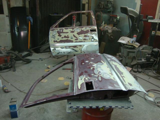

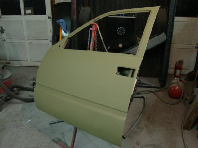

Old Mar 4, 2010 | 08:58 PM
  #39
SCOTT_A's Avatar
Joined: Jan 2010
Posts: 337
Likes: 14
From: Lebanon, NH
Default Doors
I worked out the dents, filled the low spots and shot them with primer... Paint is next. I still have the bed, hood and tailgate to strip, straighten and paint. Its a lot of work, but its worth it!
Attached Thumbnails 1995 sleeper truck 6.0-dsc00184.jpg   1995 sleeper truck 6.0-dsc00185.jpg   1995 sleeper truck 6.0-dsc00186.jpg
