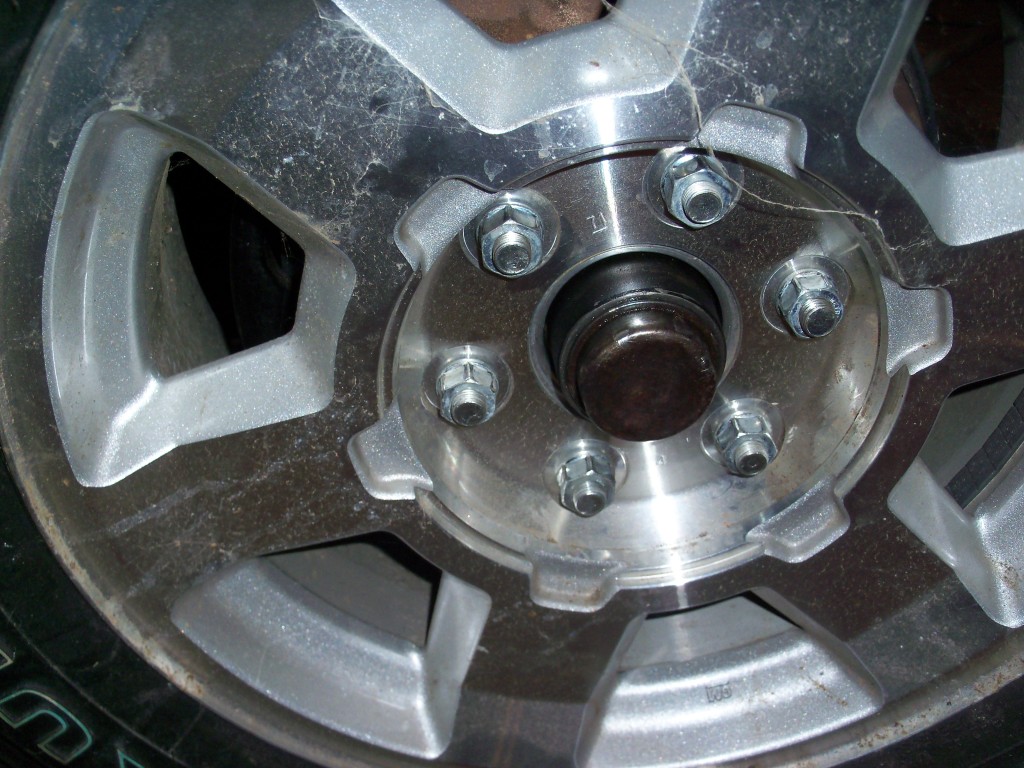

Here's a shot of the spacers and longer studs as well as the one ton calipers.
As you can see the hub no longer protrudes through the wheel.
I'm pretty happy with how it sits. Should be a bit lower once the springs get broke in.

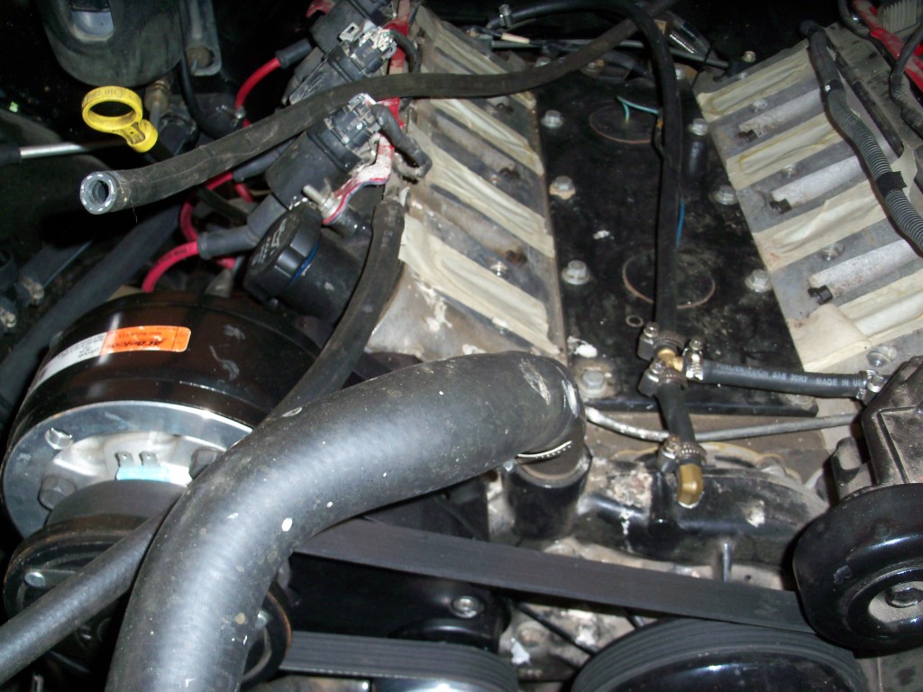

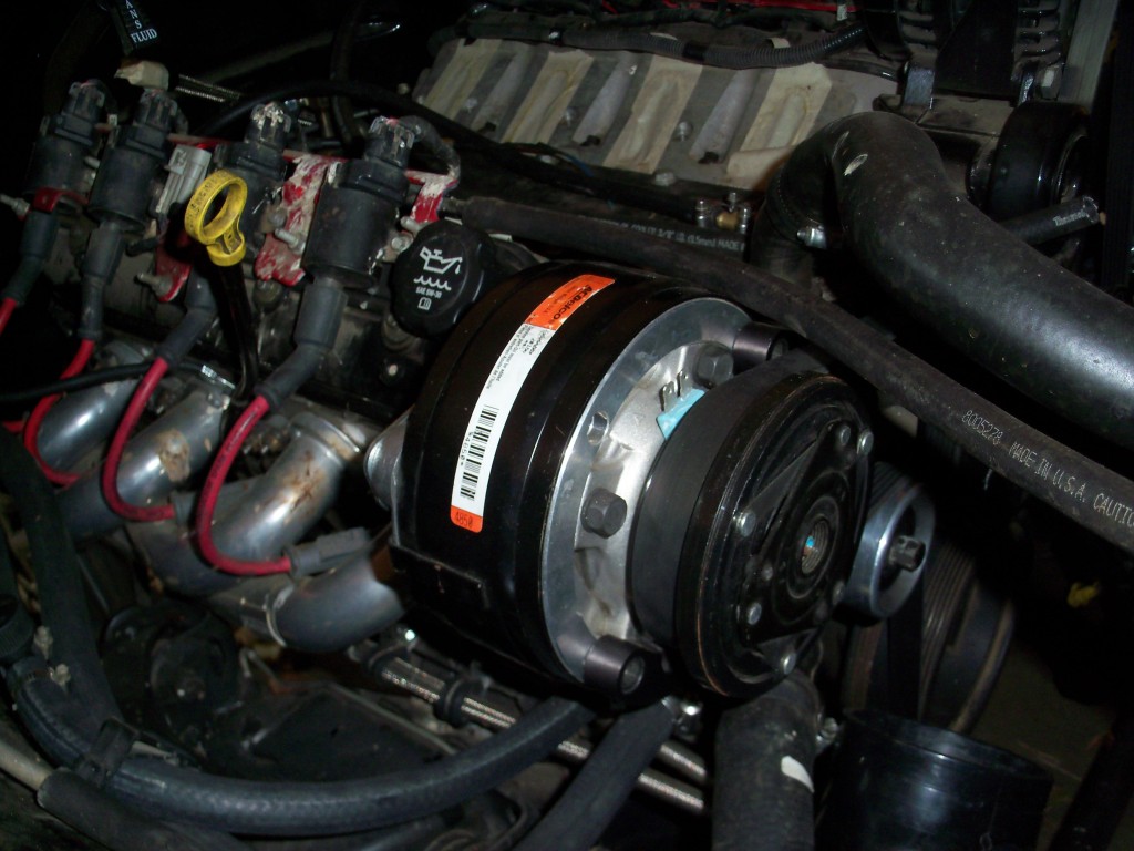

I've just been working on getting it started, reworking the go pedal, and bolting up some underhood items. Here's a few random pics I took.
The Novac A/C bracket and new compressor, the compressor is in a slightly different location so I still have to have custom lines made.
Routing of the steam pipe/coolant crossover or whatever you want to call it. I didn't want to tap the pump at first but it looks cleaner than another hose running to the radiator.
