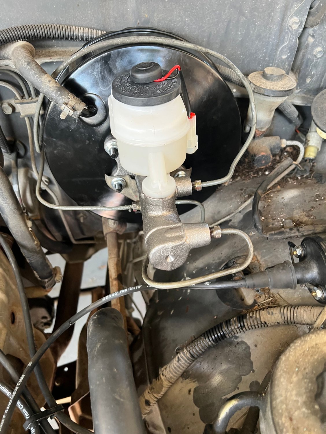

Other than the size difference do they physically mount fine?
Curious if it doesn’t matter or they are just updated.

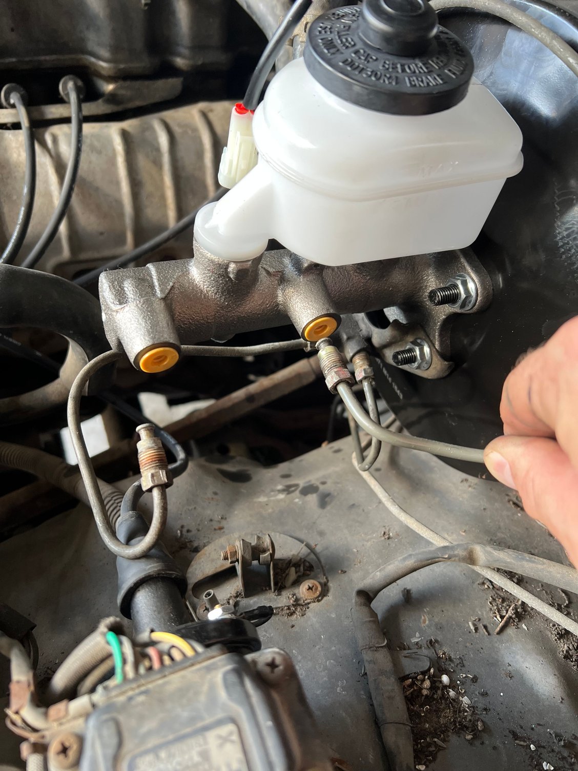

Everything mounts the same. But the brake lines don’t match up and bending 34 year old brake lines seems like a bad idea.

Mocked it up anyways and I can easily bend the lines to fit. With some luck, I should be driving this thing out of the garage this weekend.

From: Georgetown, TX
New shoes, new hardware, new master, new booster, new wheel cylinders, bench bled the master. Tomorrow I’ll bleed the brakes and see if it drives
