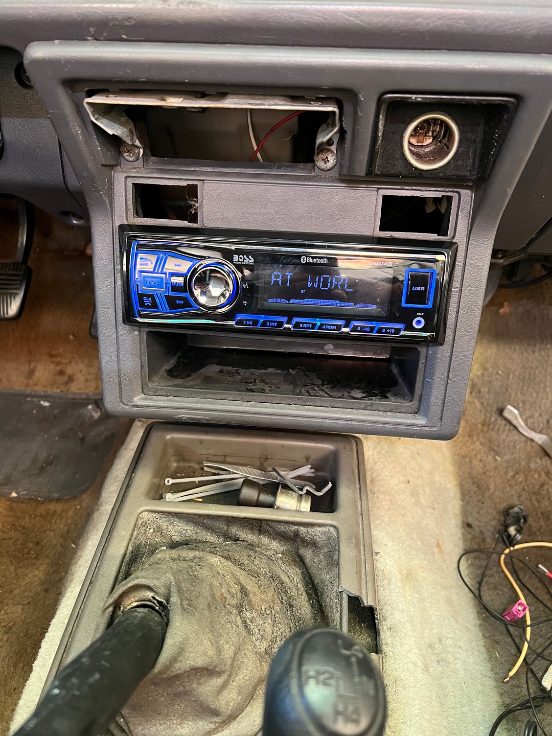

Also got some tunes now.

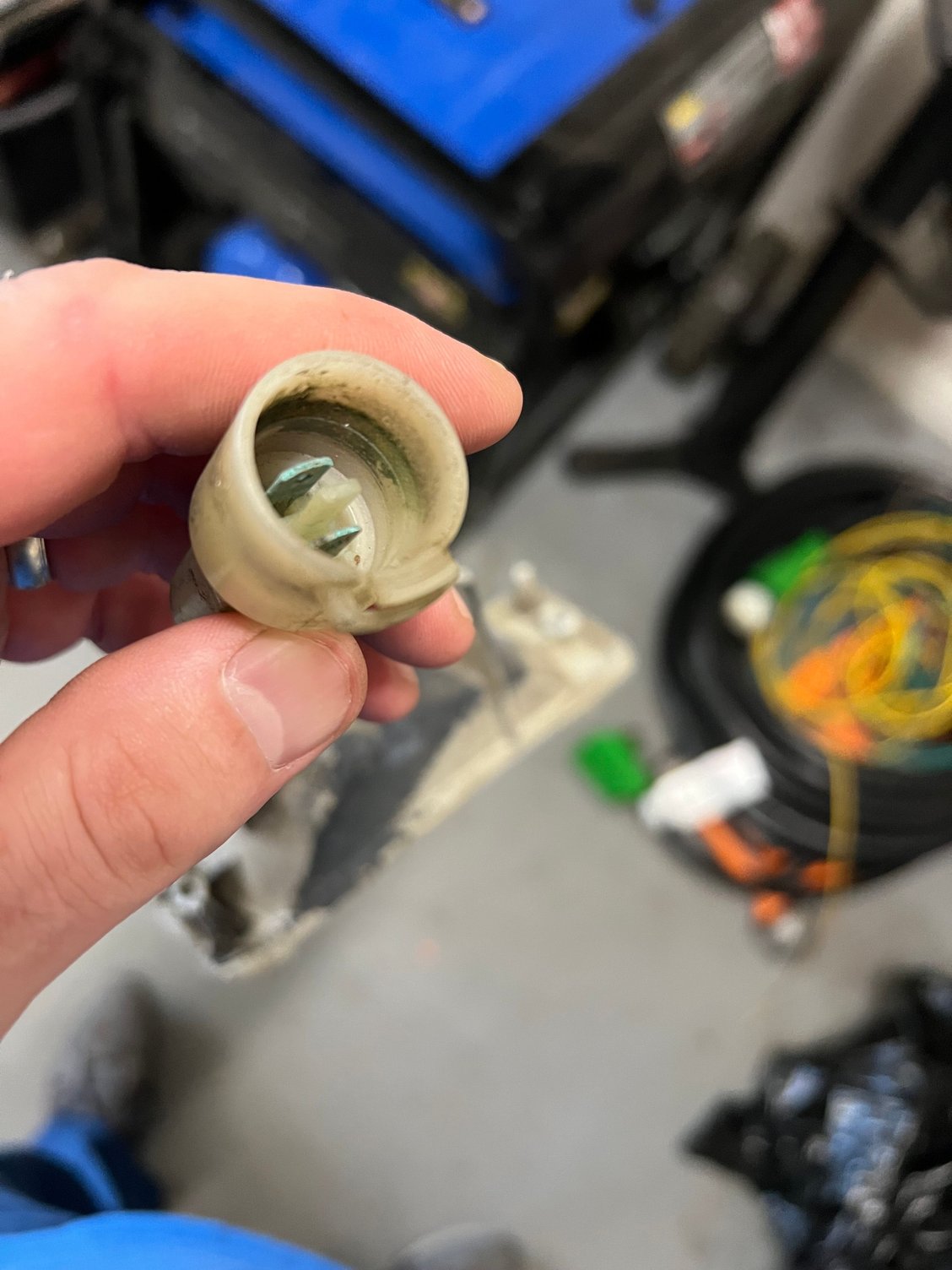

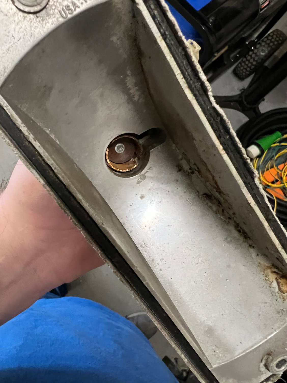

New flasher module didn’t fix the blinker. Pulled the left housing out (non working) and put it on the right side (working) and the problem followed. Plugged the right housing into the left socket and it worked just fine. Tells me the problem is at the housing.
It’s fairly corroded in here. Buddy of mine suggested wiping it down with white vinegar to help clean it. Thoughts? Are there new housings available aftermarket? Don’t really wanna try and unpin and pull apart 35yr old plastic and rubber.

RA says there are tail lamp assemblies available.

Need front turns. Which RA has as well. $38 for the pair. Might as well.
