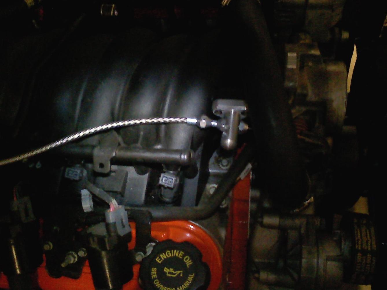

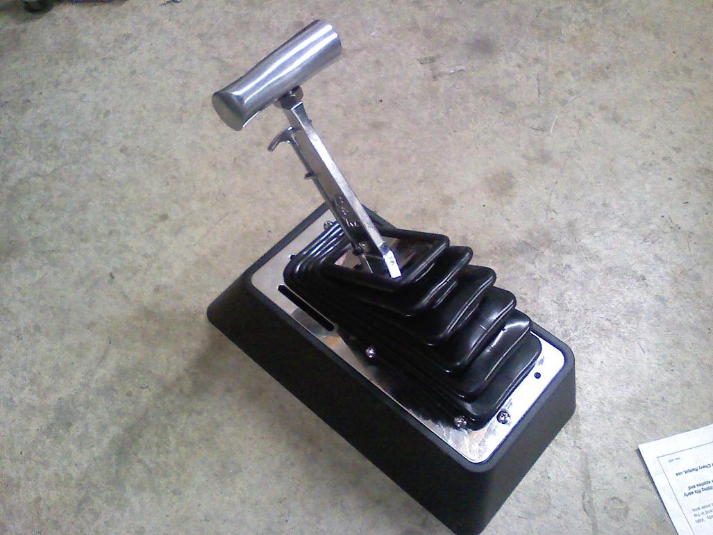

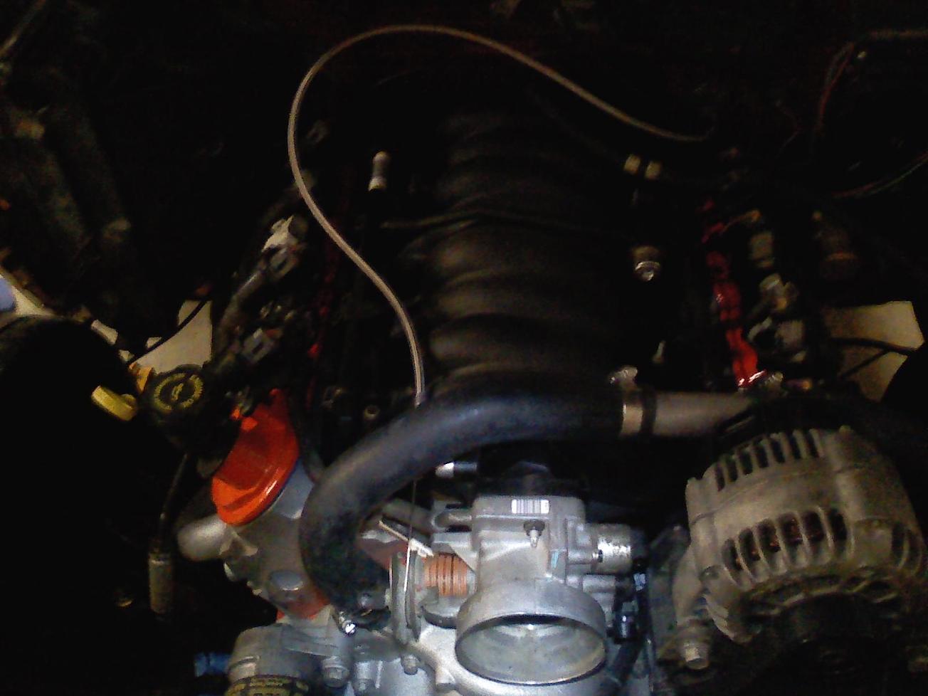

Mo Parts installed.
Lokar Makes some nice ****! Throttle cable and Bullet LS1 Intake Mount.

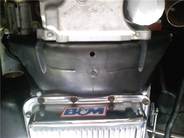

Also got my Shifter linkage and Cable on the TH-350.
B&M Ratchet Star Shifter still have to Mount up.

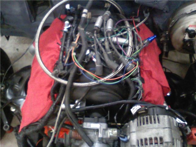

If It kills me, I'm Gonna Get the Chassis Wire Harness in this Sunday!
I can't Freaking wait to Fire this Bitch up! Maybe next week If things go well!

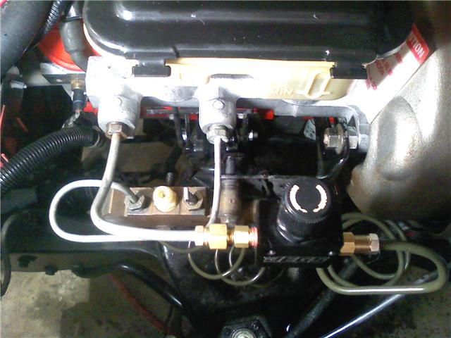

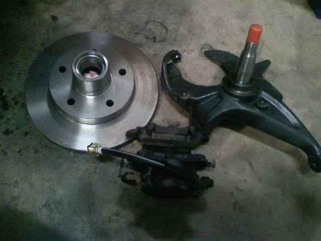

1988 Blazer 5.3 Swap-prop-valve.jpg New Brake Booster and Adjustable Propo Valve for 8.8 Rear disc

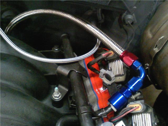

1988 Blazer 5.3 Swap-6-line-hard-line.jpg Installed vette fuel/reg. and ran the S/S braided line.

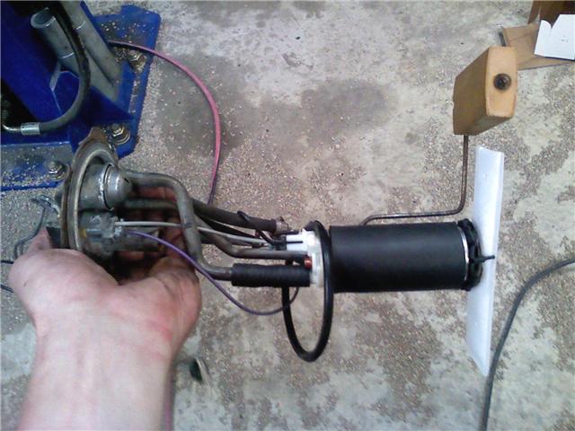

1988 Blazer 5.3 Swap-delco-pump.jpg New 225GPH pump modified stock sender

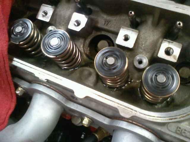

1988 Blazer 5.3 Swap-lunati-duel-spring.jpg Installed Lunati Gold Duel valve springs

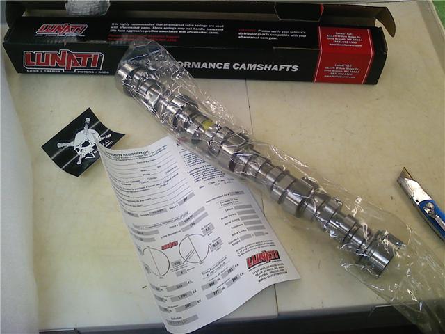

1988 Blazer 5.3 Swap-cam.jpg Lunati Voodoo Grind. 227 233 283dur .584lft. 113 lsa. cam

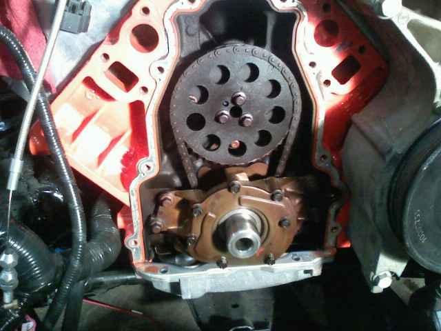

1988 Blazer 5.3 Swap-front-cover.jpg Installed cam, and spacer on oil pump spring.

1988 Blazer 5.3 Swap-dust-cover.jpg And dust cover for the TH-350. bought ABS plastic cover. Cut to fit. Worked good.

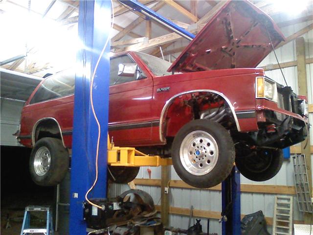

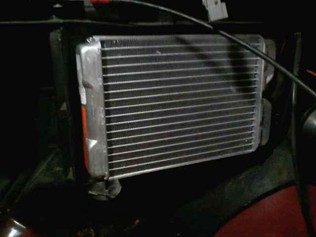

Bought a new Heater Core and Grant Steering wheel.

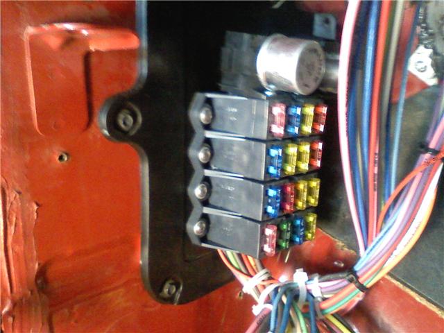

Got the Fuse box mounted and wires roughed in. Getting close man.

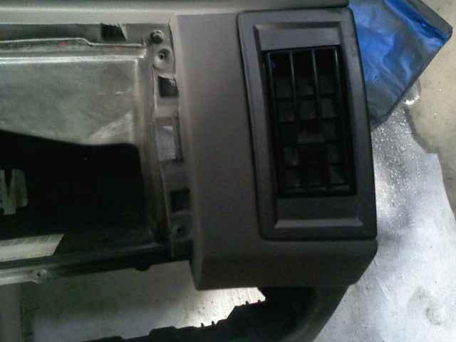

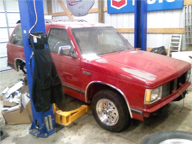

Also painted the Tan dash with some Bull Dog Primer sealer and Dupli-Color Gray. Now I have to paint the rest of the Plastics. Should look good with the Black Carpet.
