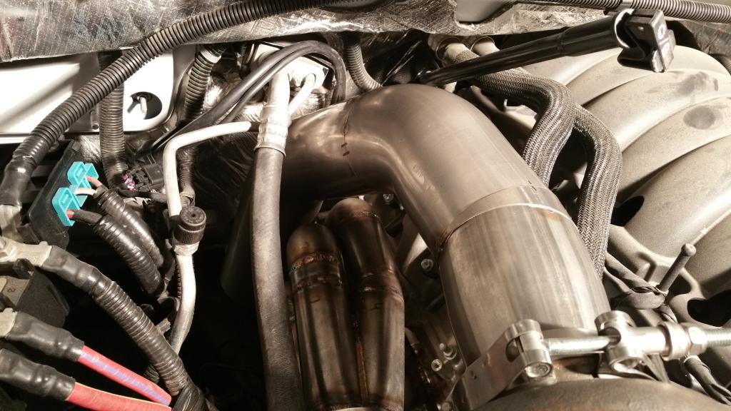

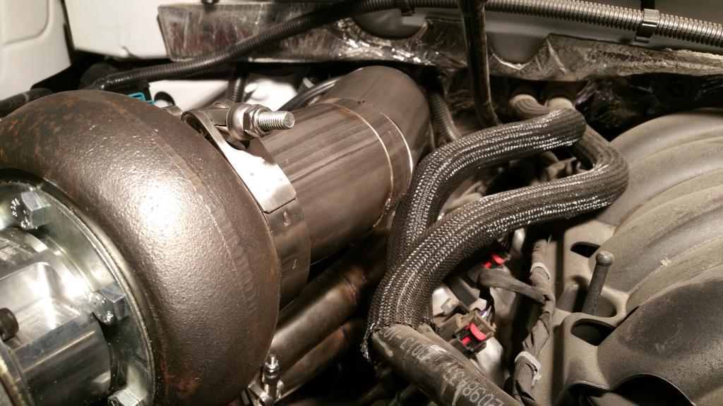

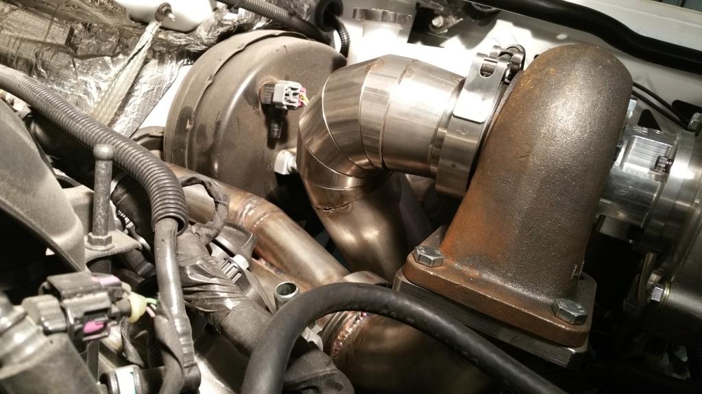

Got the pass side dp done you guys think it throws it off to much?
Should I try and copy the driver side? Or leave it?

Old Jan 15, 2015 | 09:08 PM
  #53
blownescalade62's Avatar
Joined: Nov 2013
Posts: 299
Wow that is a tight fit!
Old Jan 15, 2015 | 09:58 PM
  #54
08DenaliT's Avatar
Joined: Sep 2008
Posts: 186
Yea extremely tight. Everything is getting wrapped with the dei ti stuff.
Old Jan 15, 2015 | 10:38 PM
  #55
Vortec350ss's Avatar
iTrader: (20)
Joined: Feb 2006
Posts: 7,271
Likes: 62
From: South Shore, MA
It all looks incredibly impressive. I don't know how sensitive a tt set up is to differences in down pipe bends or restrictions that are different. I would think it could lead to one turbo spinning faster creating different exhaust manifold pressures and therefore making one side of the motor flow a lot more air.
There is no way to fit the down pipe over the exhaust manifold like on the pass side?
Old Jan 15, 2015 | 11:00 PM
  #56
08DenaliT's Avatar
Joined: Sep 2008
Posts: 186
No not at all not with a tubular manifold sucks. That's why I stepped it up to 3.5 from 3 inch to make sure it wouldn't I'll hit up Joe at comp tomorrow see what he says.
Old Jan 16, 2015 | 01:29 PM
  #57
oakley6575's Avatar
Joined: Dec 2010
Posts: 5,235
From: Las Vegas, NV
How come a lot of guys use pie cuts instead of mandrel bends? Just for tighter turns?
Old Jan 16, 2015 | 02:42 PM
  #58
08DenaliT's Avatar
Joined: Sep 2008
Posts: 186
Yes you can get a much tighter radius.
Old Jan 16, 2015 | 03:29 PM
  #59
iTrader: (20)
Joined: Feb 2006
Posts: 7,271
Likes: 62
How long until we start taking things to the level that a hydroformed bend that maintains a steady volume throughout the pipe is worth while? There are some fairly slick exhaust systems out there that accomplish this. They enable insanely tight bends with very minimal negative effects on flow characteristics.
Old Jan 16, 2015 | 05:45 PM
  #60
GMCtrk's Avatar
iTrader: (27)
Posts: 12,275
Likes: 19
From: Dallas
Looks awesome. But man, that is going to be one HOT engine bay.
