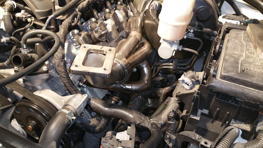

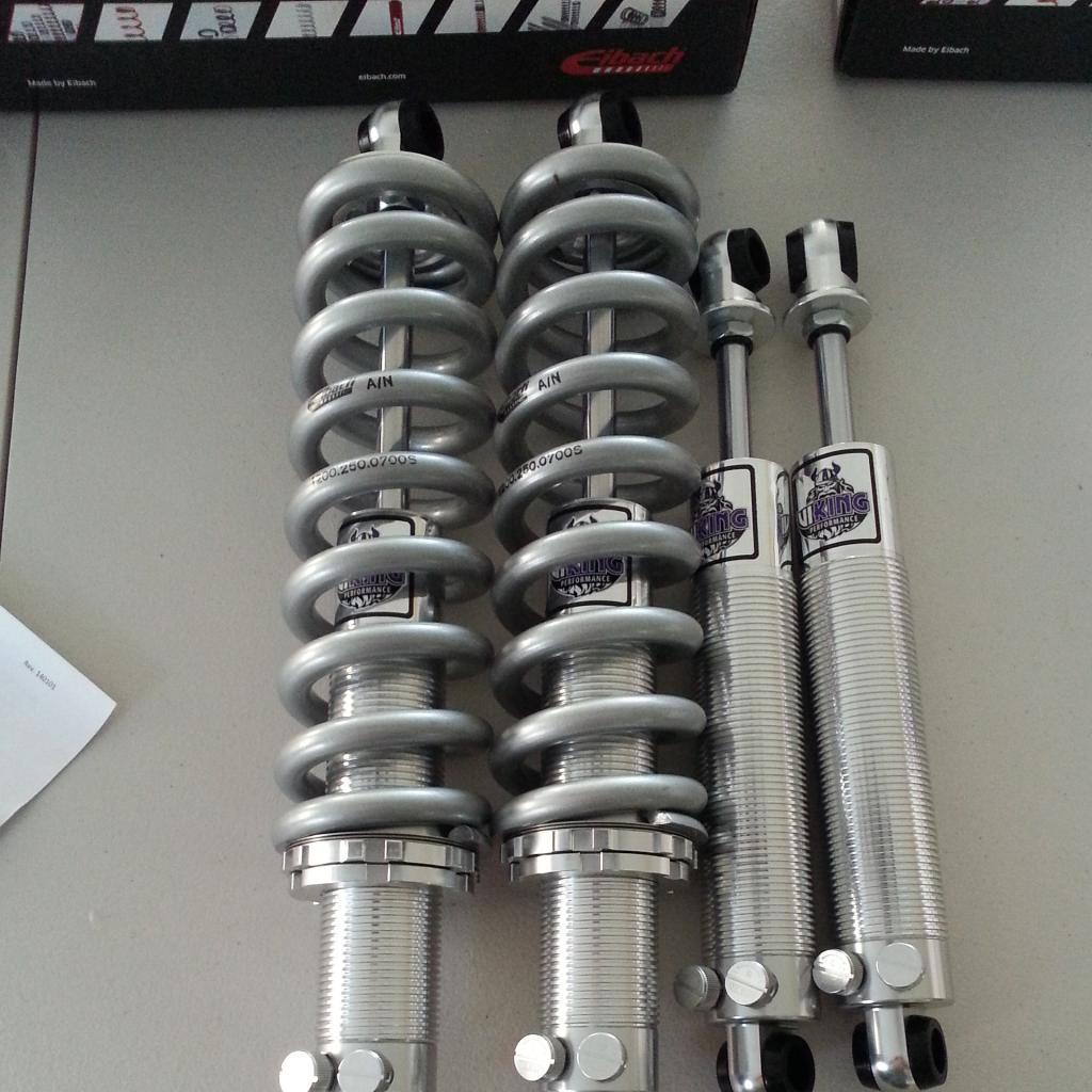

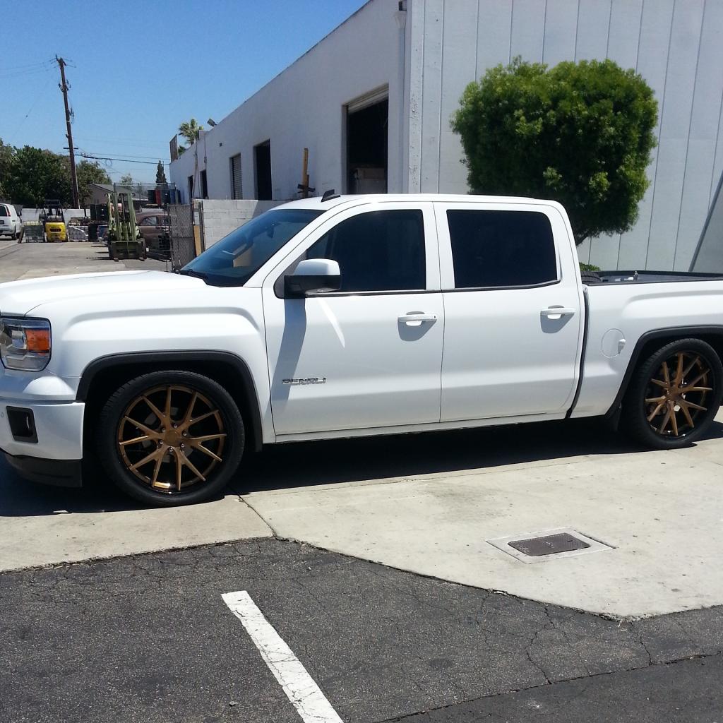

ok so finally getting around to posting this up here. I cant wait till shes back up an running s far the truck has.
belltech flip kit and spindle
Viking shocks in all corners
djm sway bars front a rear
custom aluminum two piece bed cover
rear mounting the battery
Racemesh grille

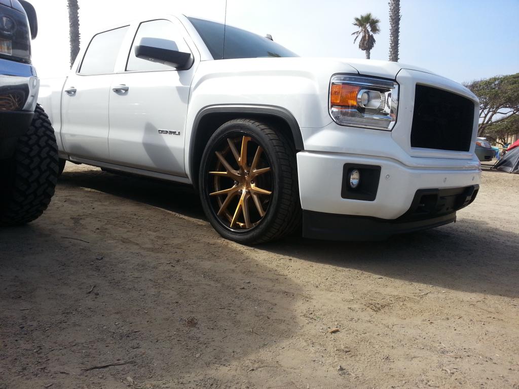

rsv forged sponsored me for wheels 24 inch deep concave 3 piece wheels

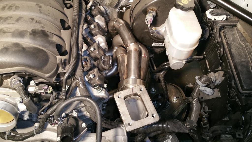

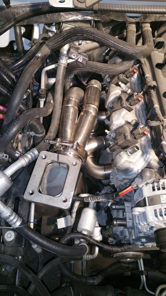

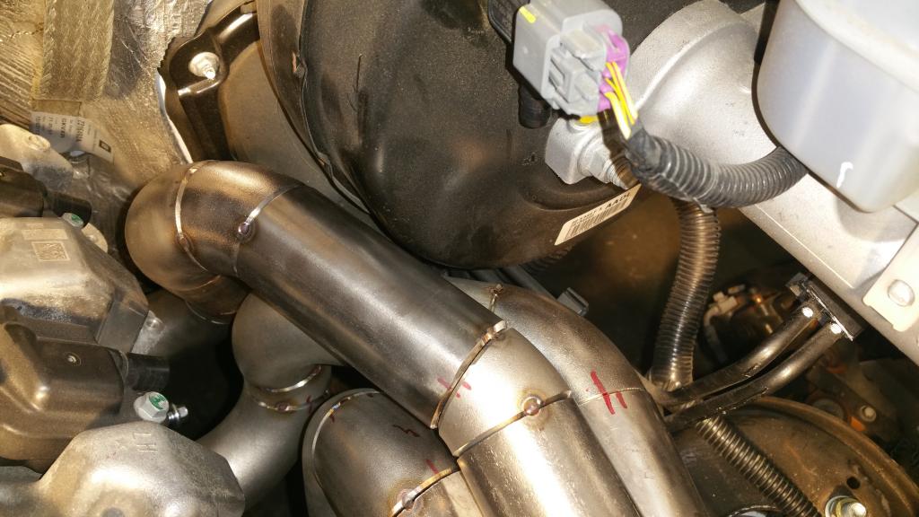

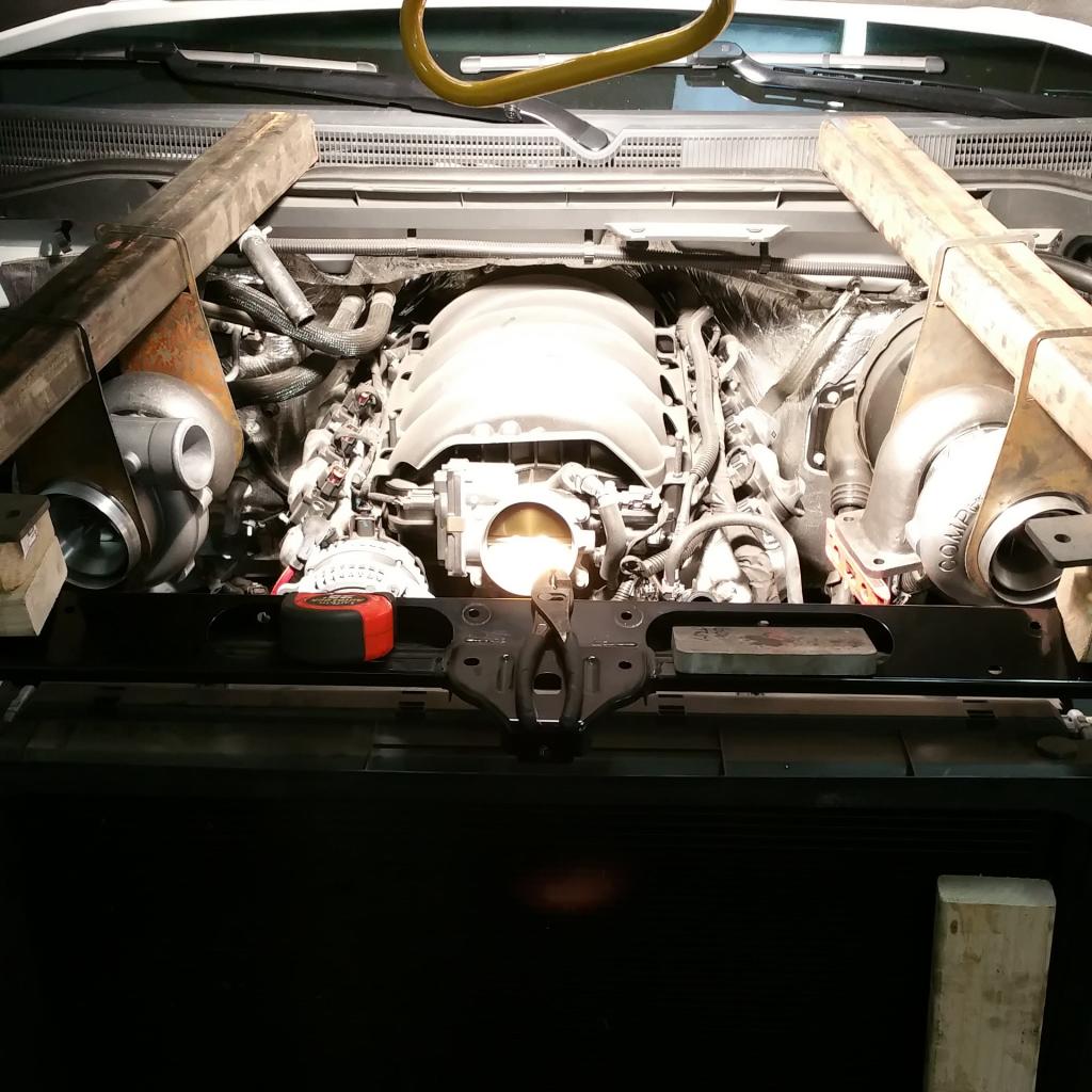

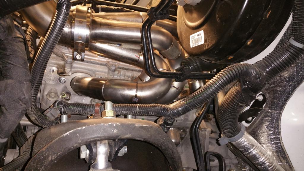

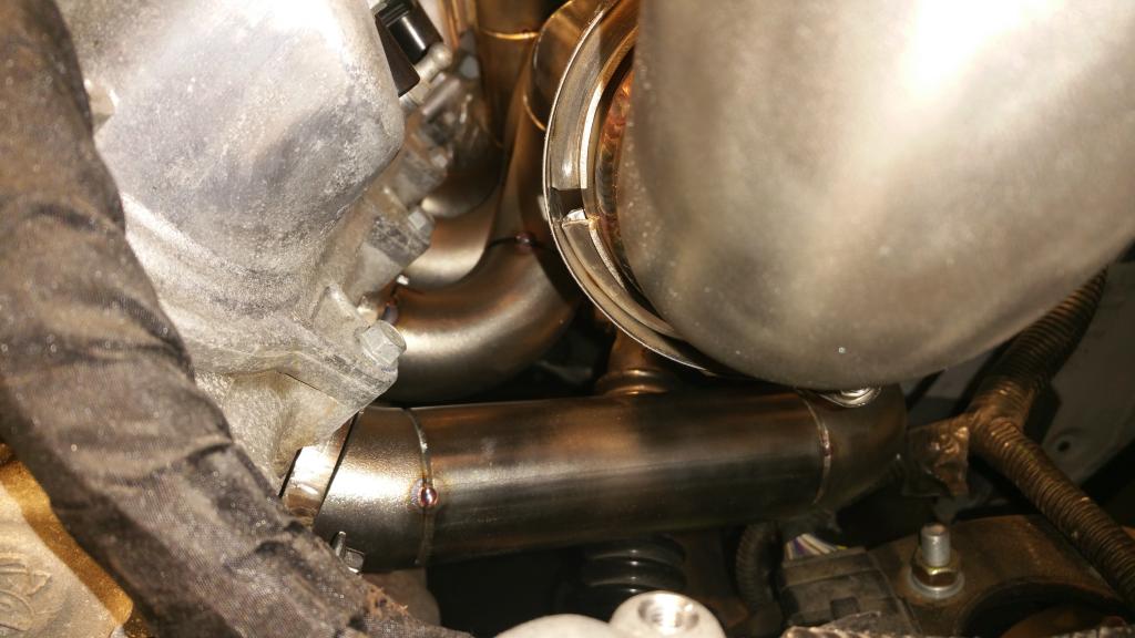

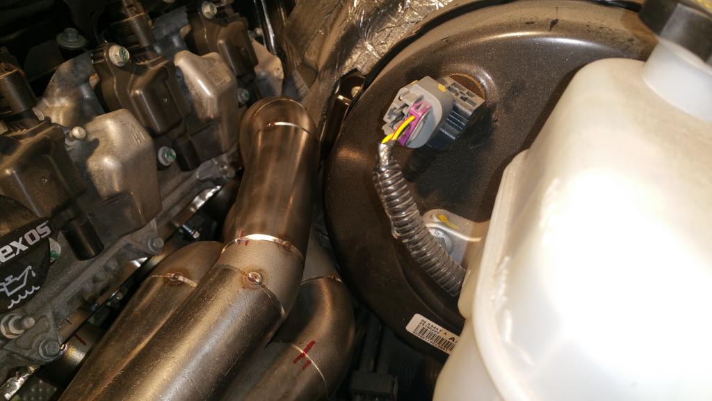

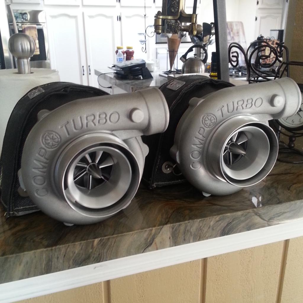

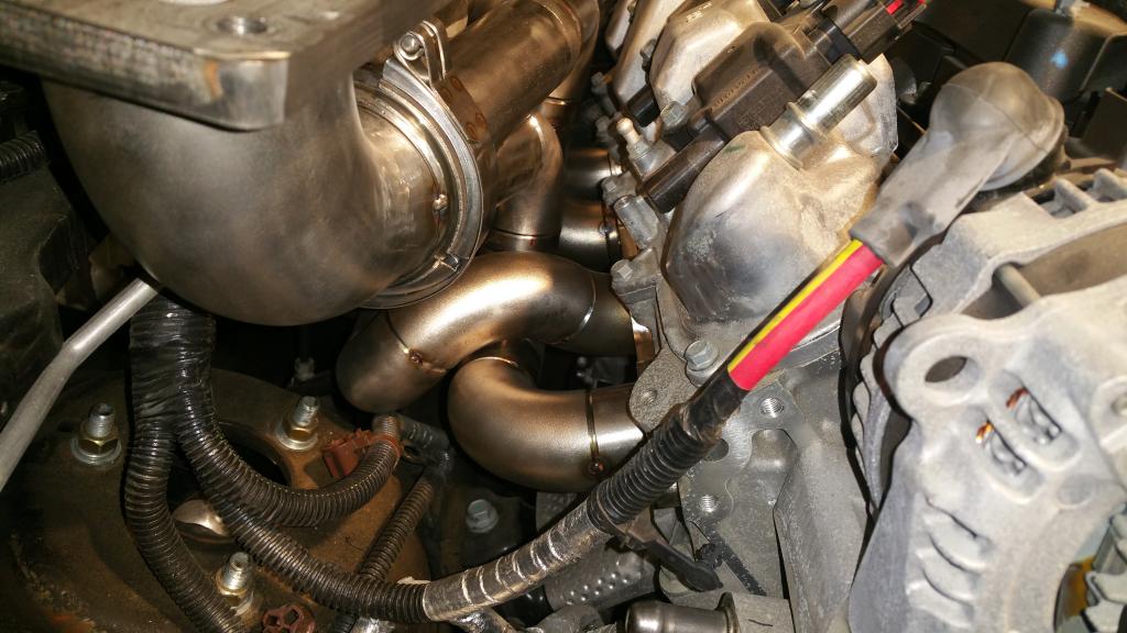

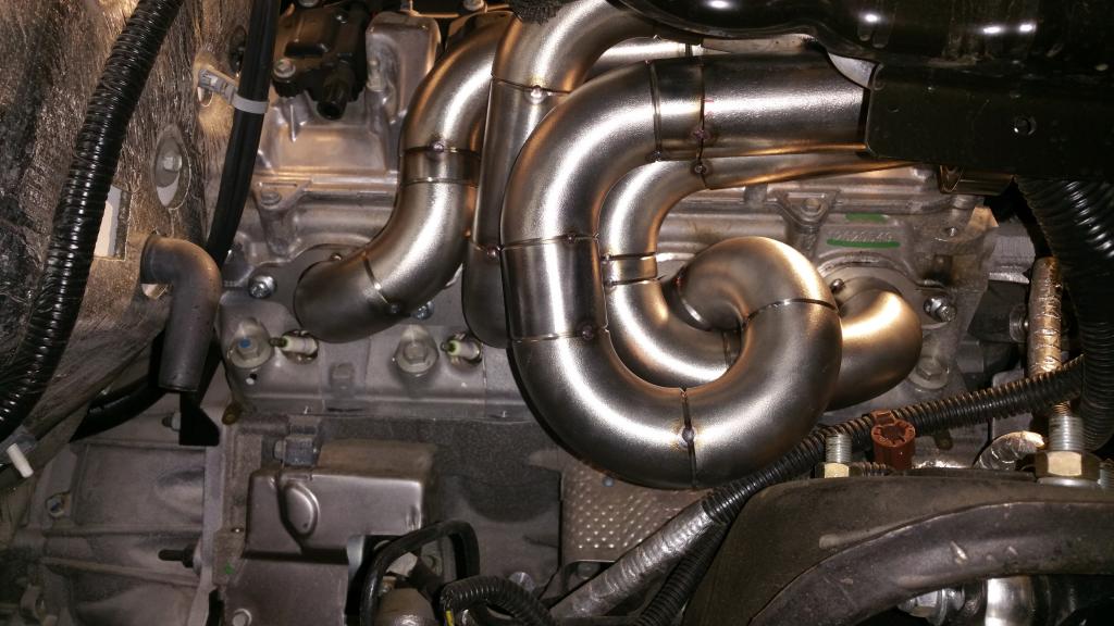

turbo kit is gonna be using schedule 10 stainless pipe tubular manifolds with a 3.5 dp off each turbo leading to a 4 inch aluminum exhaust. a big 25 by 9 by 3.5 inch treadstone core for intercooler. comp turbo is sponsoring the build using two 6267 billet wheel billet center section race spec turbos and all turbo smart gates
heres some progress pics of where im at so far. Also wanna give a huge thanks to Joe Delgado at comp turbo for helping me out and Darwin at rsv forged.

This is so kick *** and i have been waiting for someone to Turbo a 6.2 let alone a bad *** custom TT kit. Who is making the kit, because those manifolds look amazing. What the hell are you going to do for Downpipes and where are you going to run them?
What are your goals with this build?
Old Jan 4, 2015 | 11:09 PM
08DenaliT's Avatar
Joined: Sep 2008
Posts: 186
I'm doing everything and the downpip I'll post pics lots of pie cuts haha. And thanks everyone trying to make it as clean as possible will be going and building the block aswell after I have this all done and running. And most likely a 3 or 4 link set up.
Old Jan 4, 2015 | 11:10 PM
08DenaliT's Avatar
Joined: Sep 2008
Posts: 186
Stock on meth want in 600whp and once the motor is built looking for 1200
