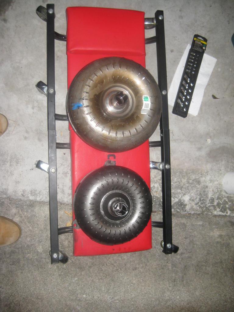

Well the truck has been down entirely too long, but its pretty much back together. I have a little plumbing to do to get the lines to the trucool (I'm retaining the factory lines for now) and, of course, the stock flex plate to converter colts don't fit the new TCI converter which requires 7/16x20 bolts. The stock bolts are the shoulder bolts but I cant find any grade 8 fine thread, shoulder 7/16x20 bolts. So I'm not sure if regular 7/16x20 hex head grade 8 bolts will be fine or not... Also I saw that I might have to elongate 1 or more of the torque converter holes to get the bolts to fit through...always something.

I was very surprised about the difference between the stock converter and the new one. Why is it so much smaller? Hopefully it works out decently.

So after the longest converter install ever, ITS DONE. So the guy I bought the converter off of didn't give me the flex plate to converter bolts so I had to order some off of mcmastercarr. While I was waiting for the bolts to get here I got everything installed that I could so that id have less to do once I got the bolts. Well bolts came in and one hole on the flexplate needed to be drilled out, so I took everything apart again, dropped the trans, removed the flex plate and converter, drilled out the hole and made sure it all fit. Then reinstall...again.
It hasn't been hot recently in NC and driving around doing some pulls I only saw a max trans temperature of about 140F thanks to the trucool. Just pulling out of the garage I could tell the converter was a lot looser (ive never even been in a car with a high stall converter). The truck is a lot quicker. Its sweet. It seems to stall about 3300 when I step on it from a stand still, which is ok with me. Now I have to readjust my shift points and lock up speed.
One question if anyone has suggestions. After the stall, the engine sometimes doesn't like to slowly drop rpms as I come to a stop. It buck (exaggerated) the converter will engage more, which drags the rpms down real low, then the converter will release, on and on until I get to a dead stop, or the truck stalls out. I guess it might just be smoothing out the timing in those areas of the table...Any suggestions?

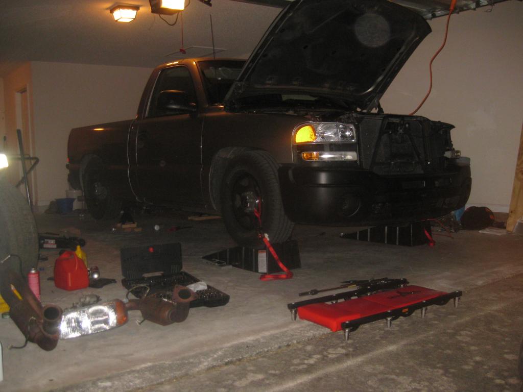

Heres a pic of the truck without the grill...its nice to dream that the trucool is actually an intercooler...one day tho!
